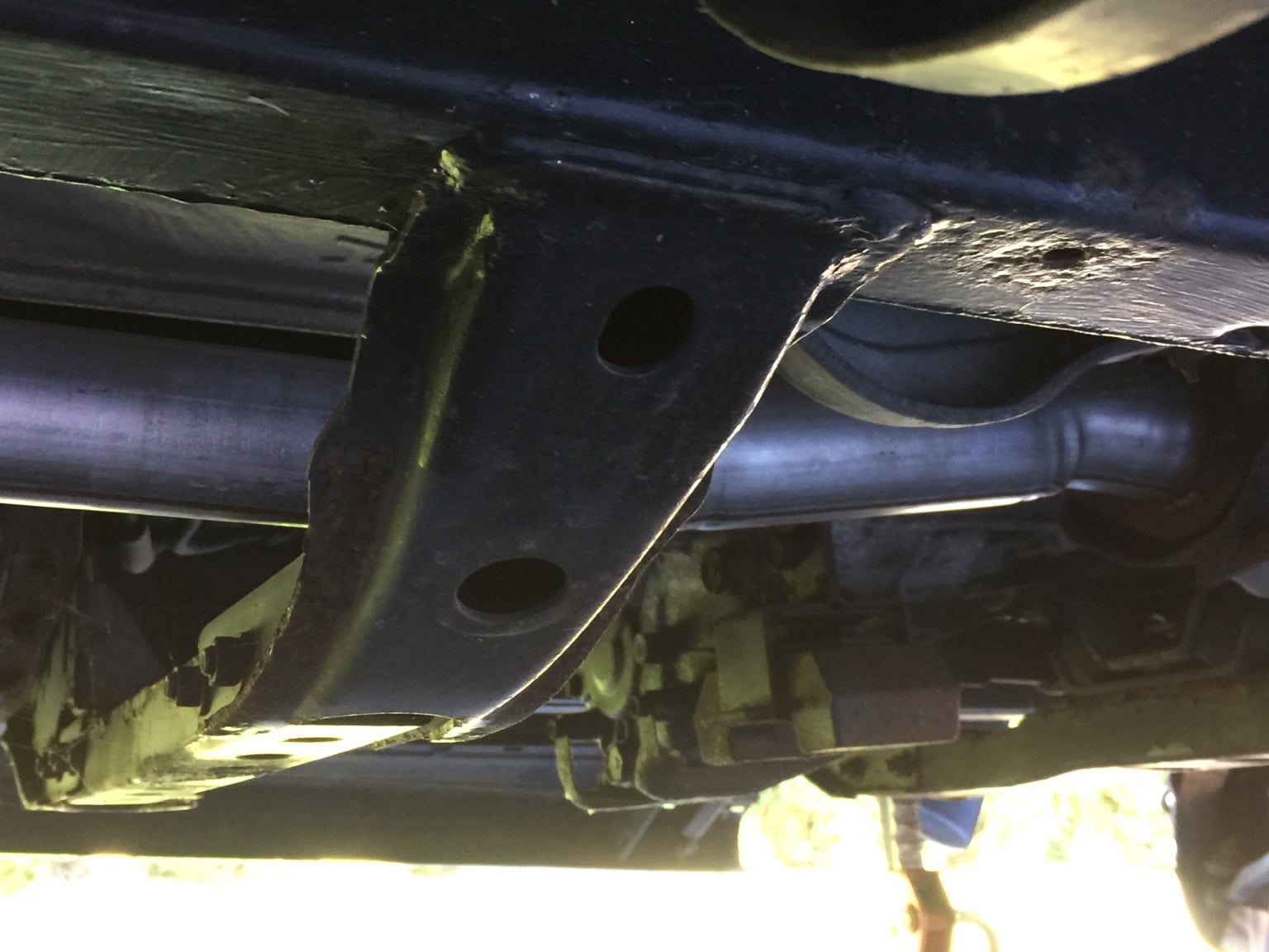

This afternoon I swapped out rear springs and shocks. It looks like someone used a torch to remove the drivers rear shock and cut a hole in the upper mount. That shock recently replaced. The top nut was only finger tight and I removed it with my fingers.

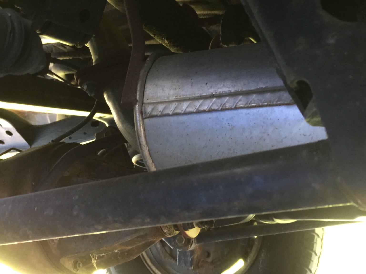

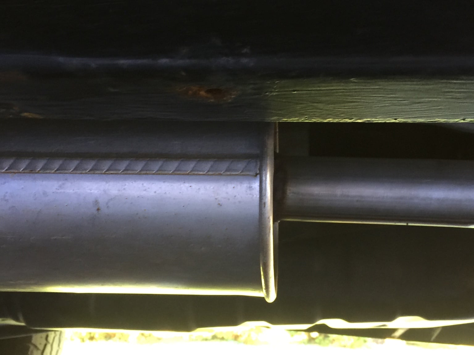

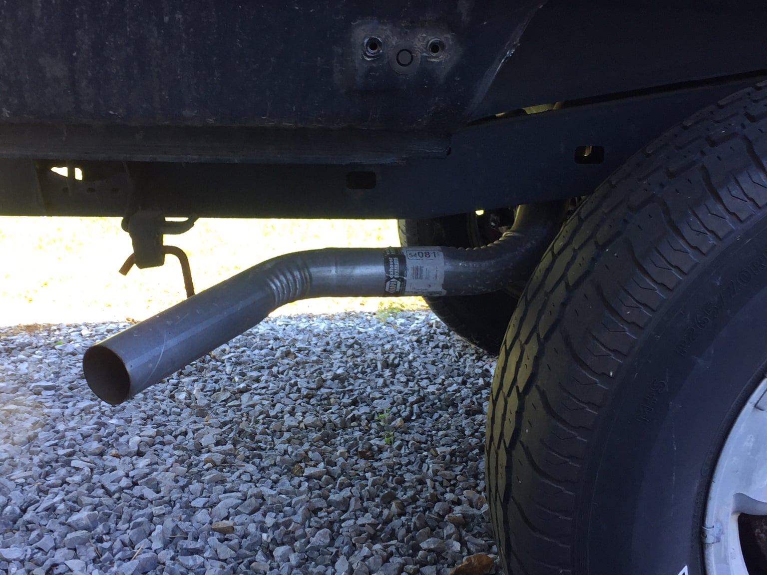

I really dislike the way the PO had a exhaust shop scab a replacement muffler into the Puppy Hauler. The 96 has a fairly new Napa CAT back system. But I can't use it conveniently because the shop cut off the flange on the outlet of the CAT on the 97. I'd just swap CAT and all from the 96 to the 97 but the 96 is federal and the 97 is Cali emissions. Though I've thought about doing it anyway just to see if it's possible to do without it coding.

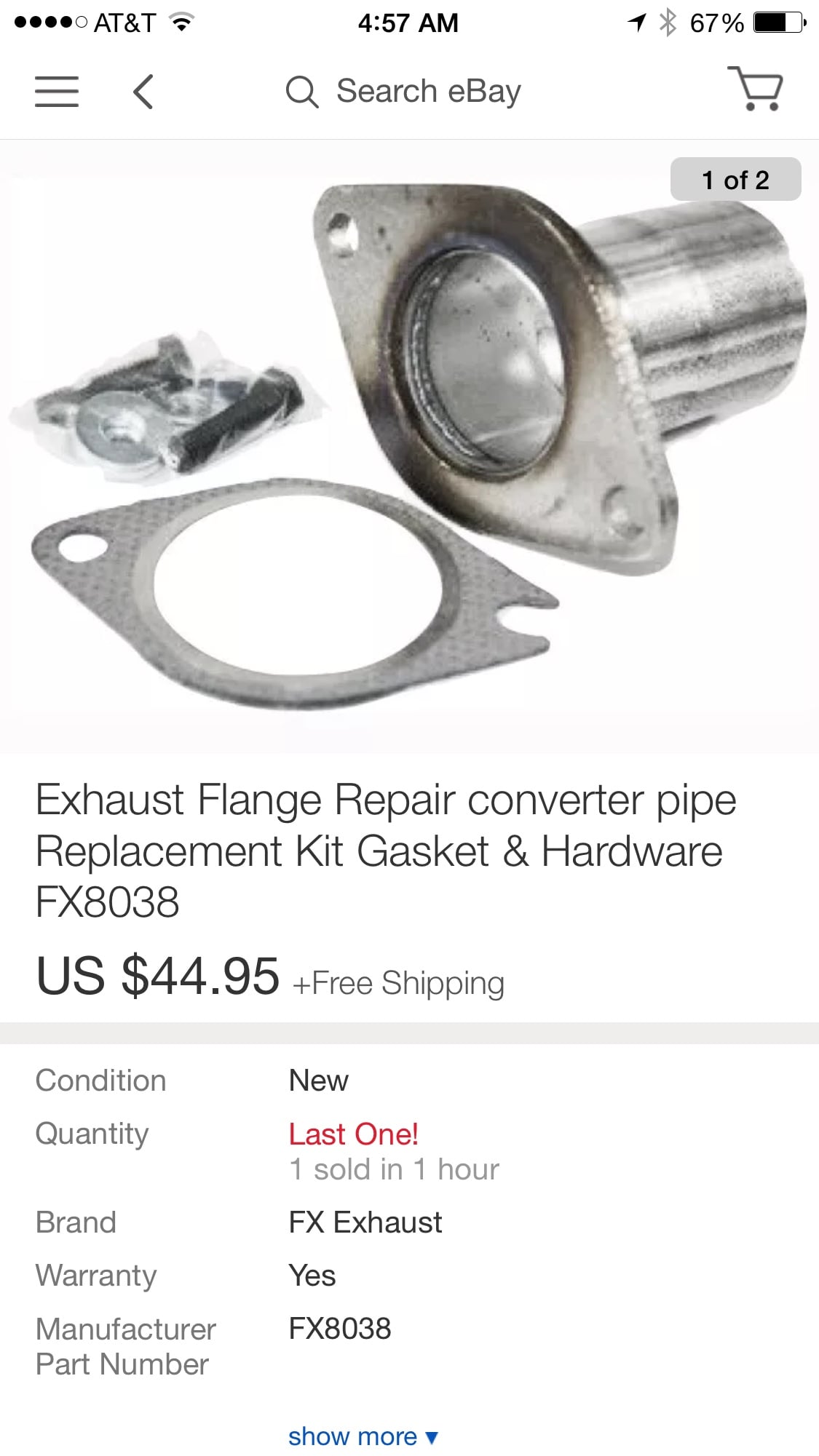

Are replacement flanges available that I can weld into the CAT outlet pipe of the 97?
Edit. Searched Google for a replacement exhaust flange for a 4Runner. Opened up the images tab and seen what looked like would work.
It's exactly what I need. Ordered it. Then visited their website. Their site price is cheaper than their eBay price with free shipping. If it costs 20 to ship from Canada to my place it will be about same price anyway.
Also they sell a direct fit CAT. And it's 1 CAT for both standards. Betting my federal from the 96 will work fine.

My exhaust flange repair kit hasn't come in yet. But this is the exhaust on the wrecked 96. It's been sitting since September of last year, plus it's was on for 6 months of driving before the accident. Can't wait to put it on the 97.

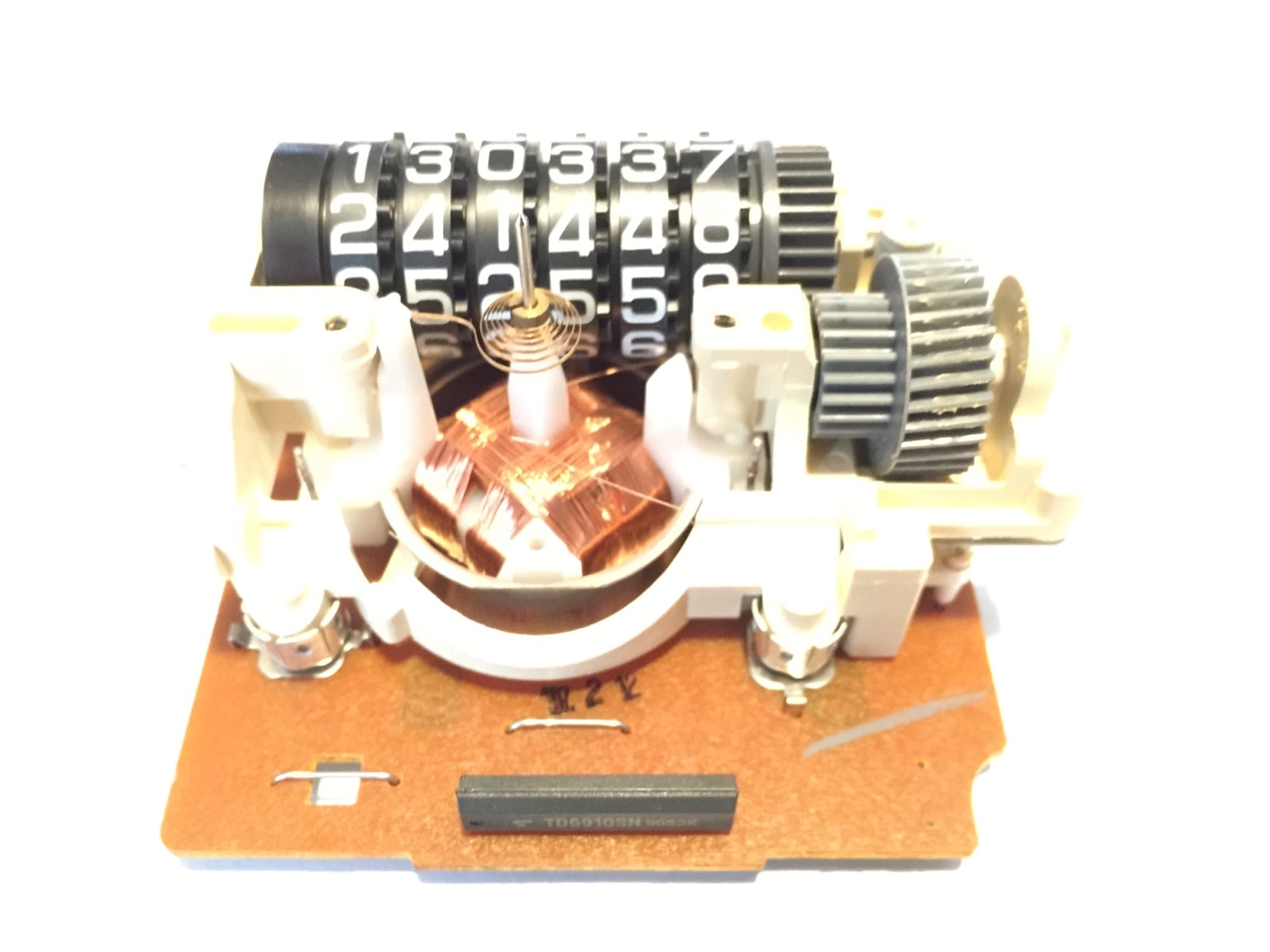

The Trip Odometer broke while trying to reset it. I've gotten spoiled in the past by going to OdometerGears.com and getting replacement gears. Not so with the 4Runner unless their common to something else on the website.
Any insight will help as I search this forum for odometer repair threads. I've got two broken speedo trip meters now and one working. The working one is still in the wrecked 96. Must pull it and reset the miles to what the 97 has. But it would be nice to find gears to fix the broken ones.

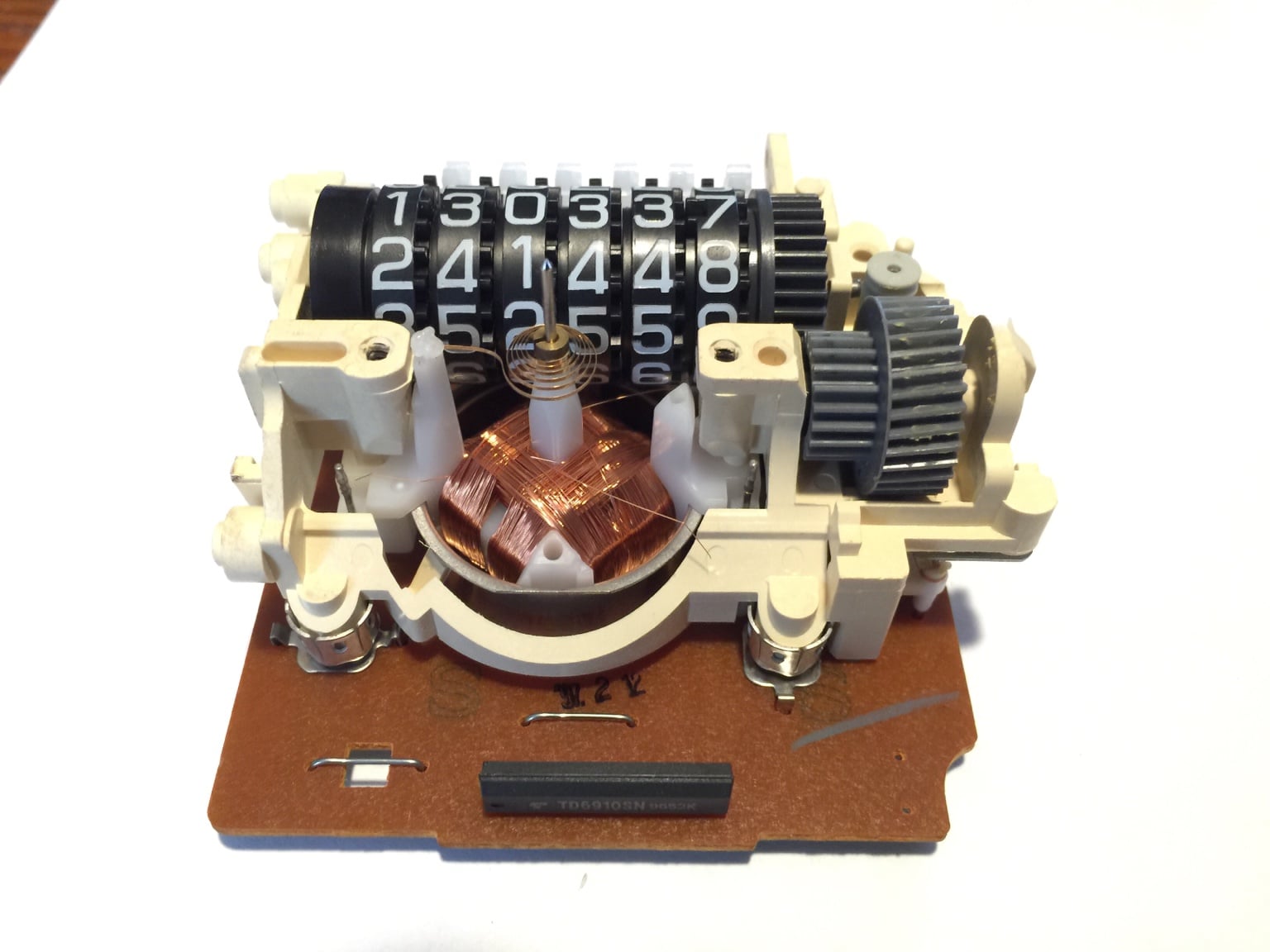

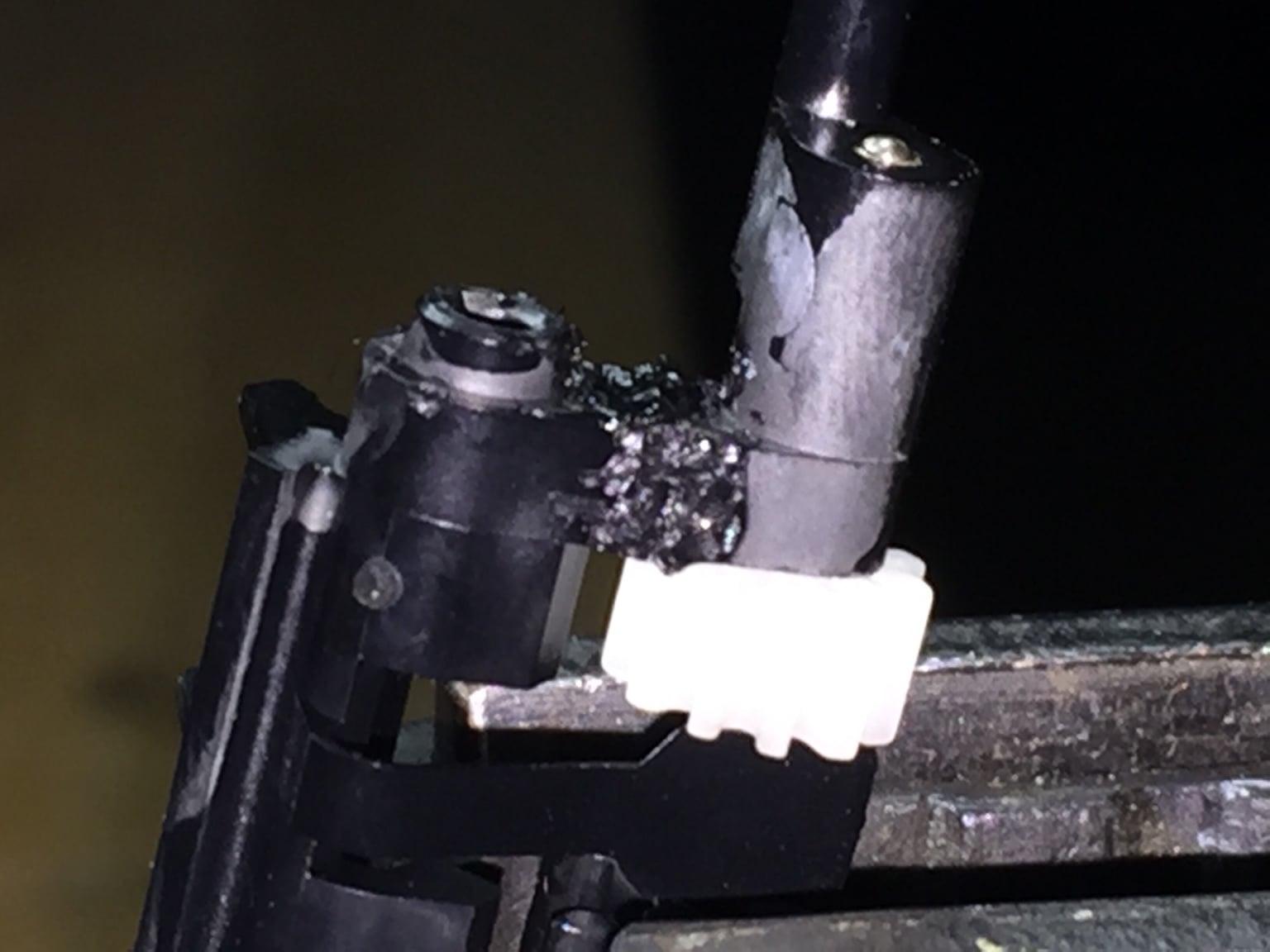

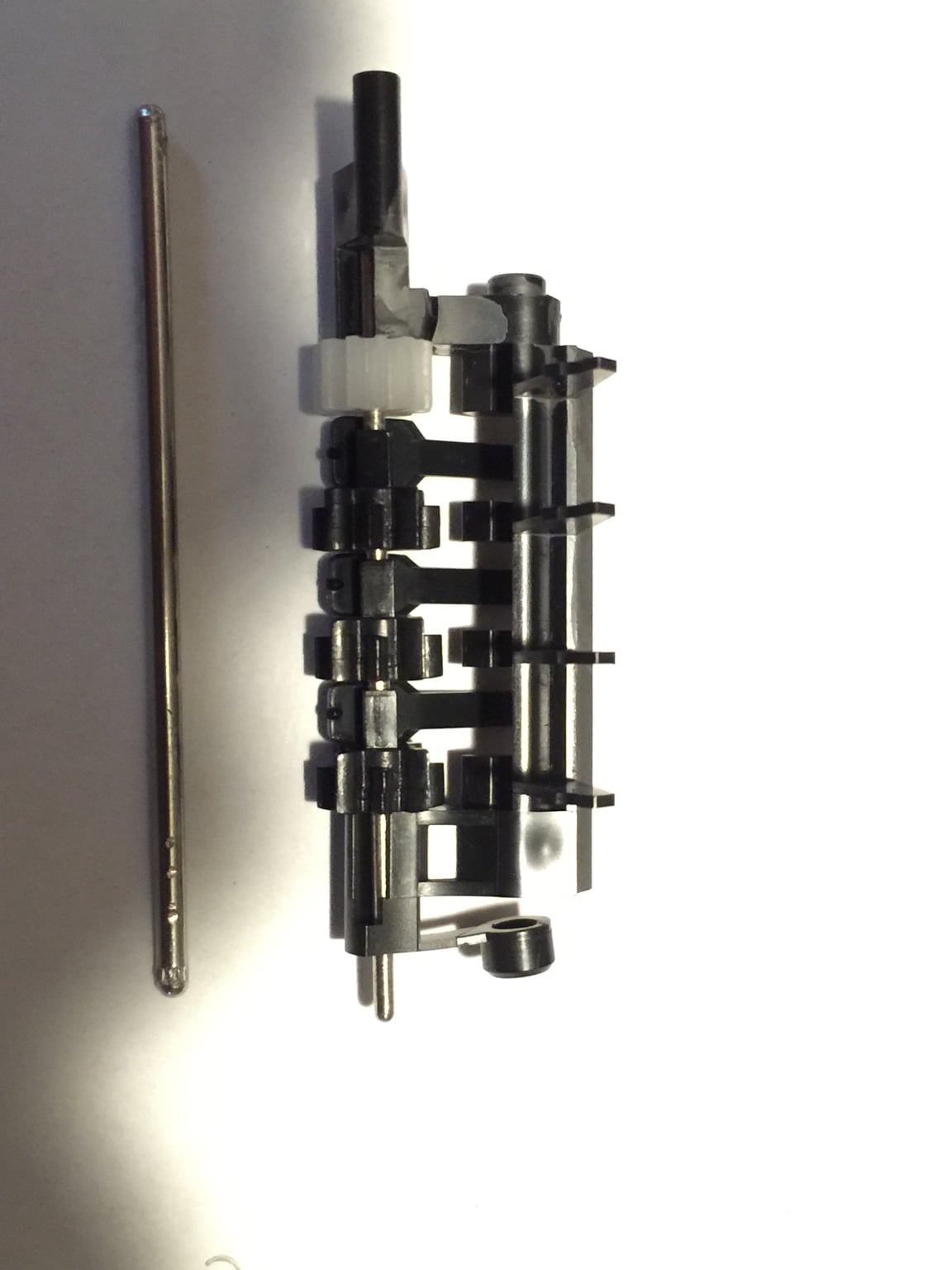

So I removed the speedo from the 1996 wreck and set the mileage to match the 97's. Then I started taking apart the 97 to see what broke, thinking it was a gear like everything else I owned.
Nope. It's actually part of the reset arm that broke

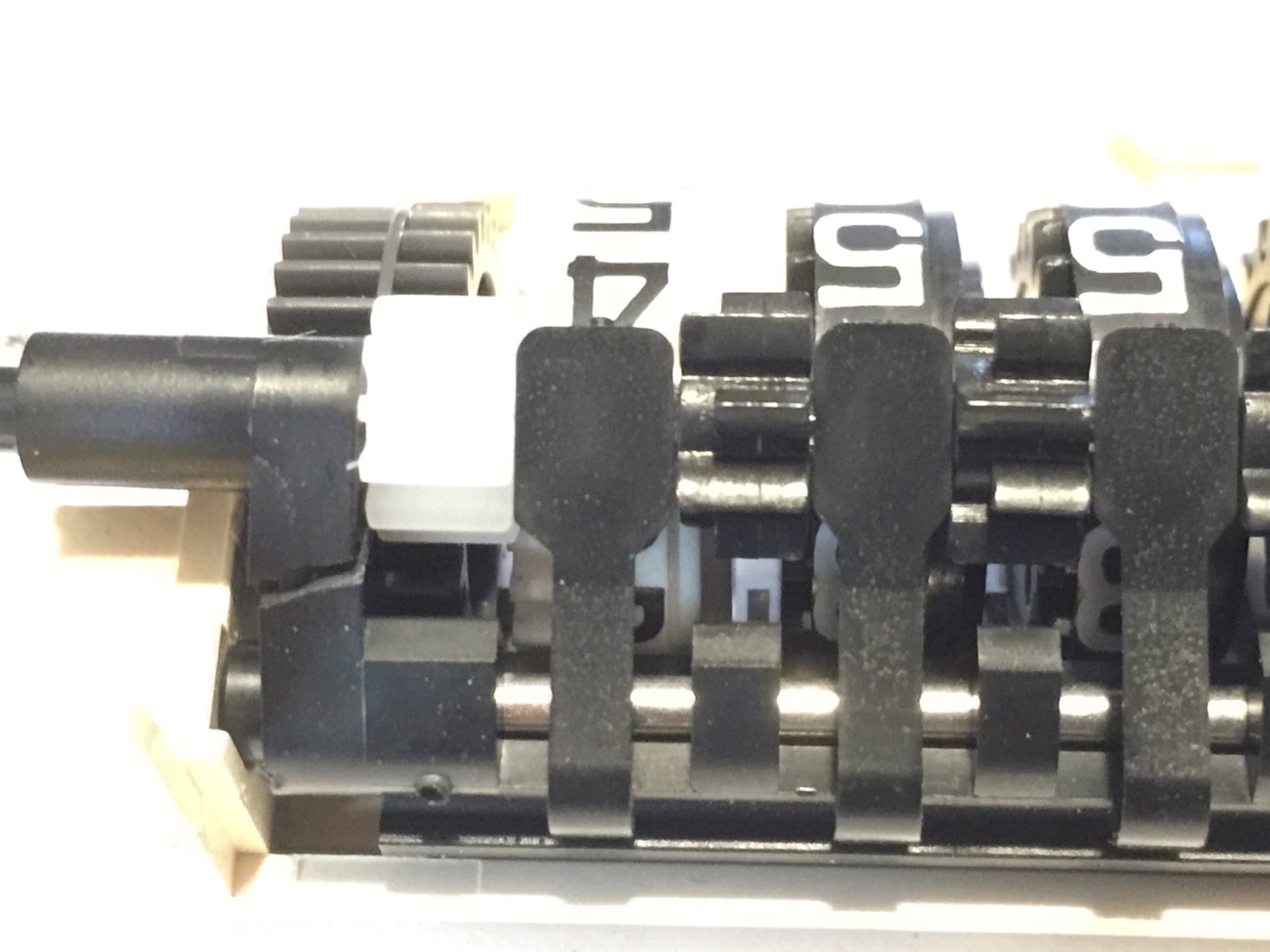

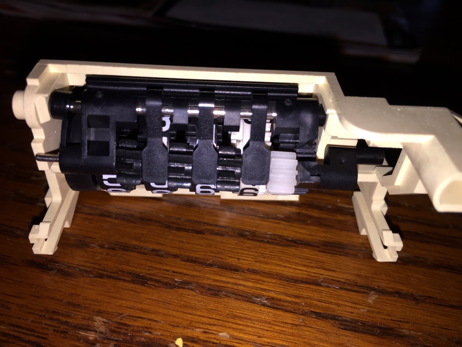

The trip part is able to be separated from the main speedo housing.

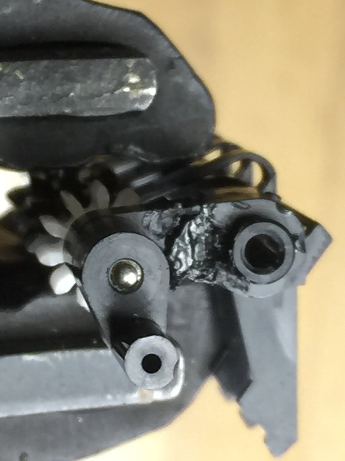

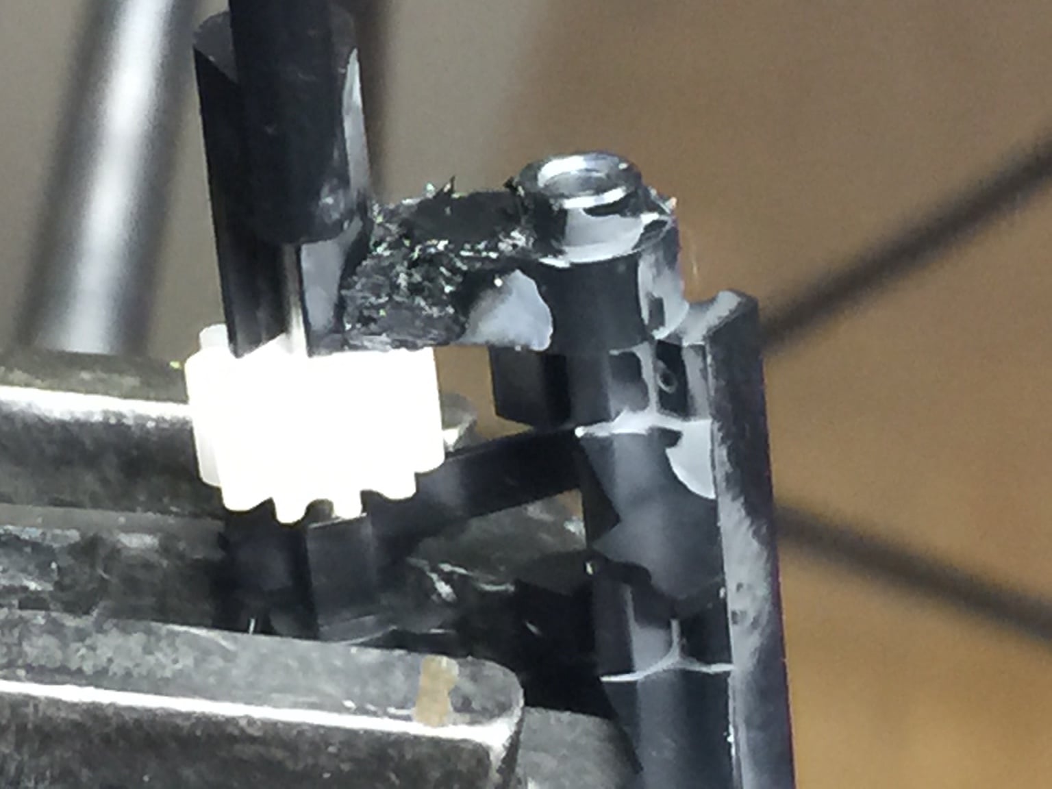

And......it's apart. Going to take it to work and plastic weld it back together.
I tried the acetone softening the plastic thing. The black plastic is not effected by acetone at all. I thought about Gorilla Glue but don't think I can do it without the foaming getting on the white gear.
To be continued.......
Super glue or plastic cement? Yes welding it might work better than any sort of glue. Pretty cool to jump into.

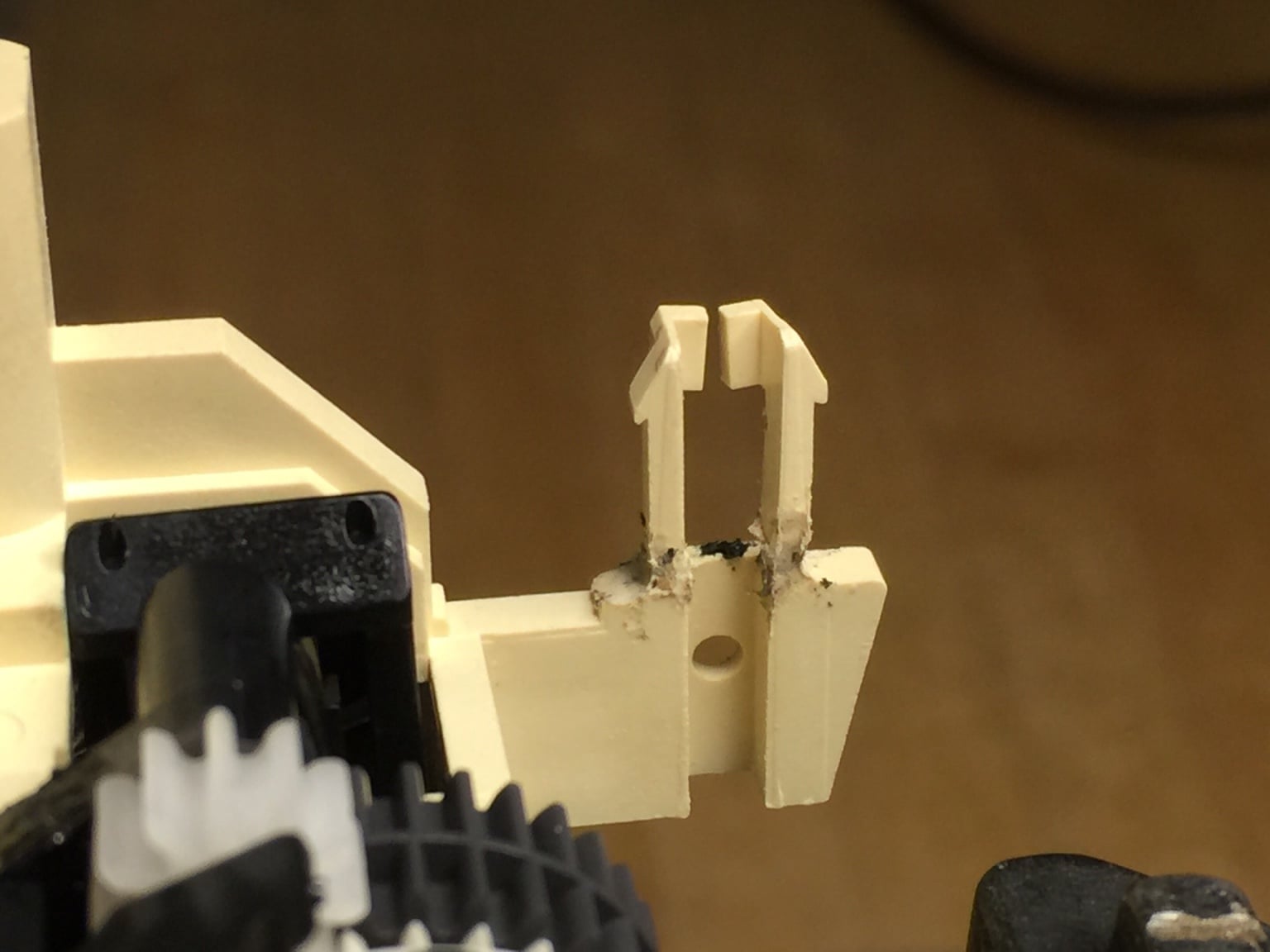

I've done three speedo replacements due to broken trip meters. It figures only now did I discover the trip portion separates from the main unit simply with two squeeze clips.

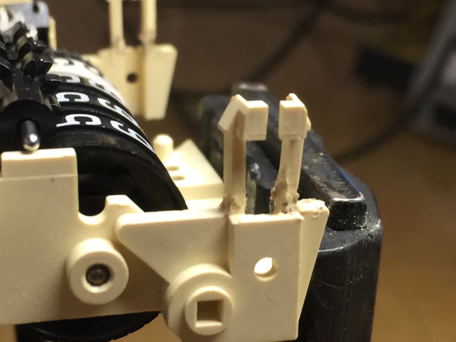

And replastic welded the retaining tabs onto the trip meter frame.
Cause I broke all four off trying to get the broken reset mechanism apart.
I rolled through the miles slow to 40.0 and appears fine. Resets every time.
