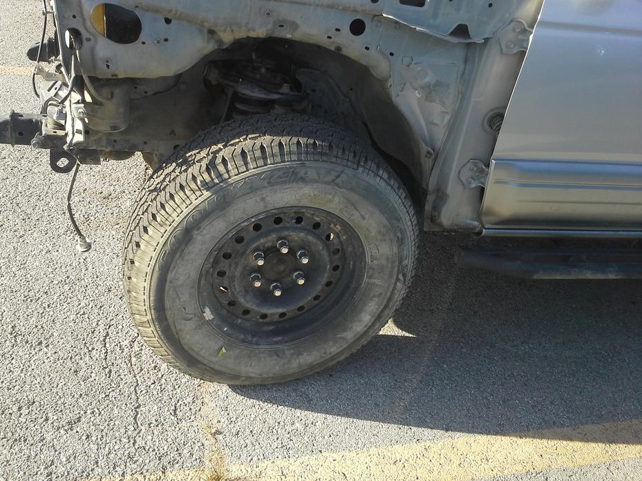

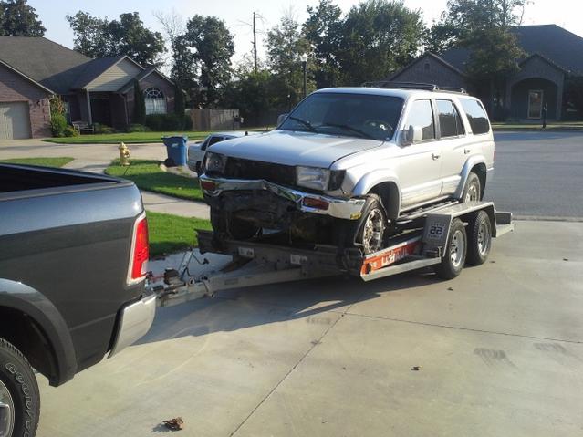

As the title says, I have a '98 4Runner that my drunk brother in law ran into a ditch at ~35. Bags blew but radiator and condenser are still intact. Driver's UCA impacted wheel well, wheel arch crumpled slightly internally (see pic).
Driver's side wheel pushed about 3/4" aft (replaced UCA/LCA/knuckle, no change), driver's frame horn about 1" up (vs. passenger frame horn), all body-to-frame bolts bent, core support bent but not terminally.
Visually, I can't find where on the frame it's bent. There isn't any paint flaking or visible bends or rips in the metal of the frame. So I stuck jack stands under driver/passenger front seats (ok not directly, but right where the frame flattens out under the firewall) to do the above measurements. Rest of truck is level when the front is on jack stands, so that tells me the tweak is fore of the firewall.
All doors open and close fine, shut lines are fine, even fenders are fine (removed d-side for pics). Hood closes straight (it's popped in the pics). You can definitely tell it's swayed from the front-on shot, though.
Anyway, the thing runs and drives so I drove it onto a trailer and took it to a frame shop about a mile away. After much gnashing of teeth, they said "not enough money in the world" to make the car safe for the road again.
Is that even a thing? Far be it from me, some amateur hack, to second guess a dude with a laser frame machine and 30 years of experience, but I have a hard time believing the frame can't be pulled. Anyone have any thoughts?
Oh and no insurance payout on this because all I had was liability on the truck. Brother in law is now deployed (wreck happened last August), he has more pressing issues to worry about.

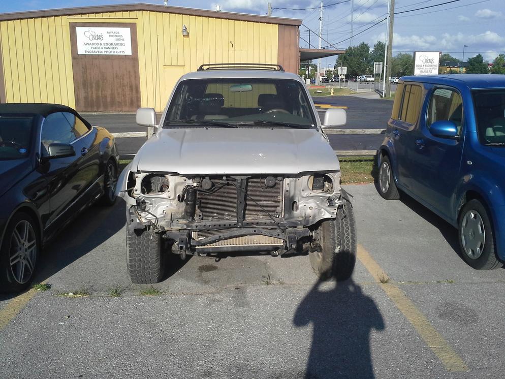

The crossmember is way bent up which means the whole end of the frame is squished. You could do a frame swap but it sounds as though your body mounts are trashed too. Might just have to part it out or scrap it. Your brother-in-law is responsible to pay damages but if he isn't willing to pay and you're not willing to go after him for it, then you're SOL

That crossmember was bent due to the force of the impact. Here's another picture.
Perhaps that "pinched" the frame horns together. Body shop didn't mention it (disclosure: they didn't mention *anything* except that 'it's too far off to fix')
Ref: the brother in law - once he's done not being in Syria (and definitely not in Iraq, either), I'll let him know he *is* on the hook for wrecking my used car. lol.
Until then, just wanted a sanity check that a frame can be "too bent" to be fixed.
EDIT: both drivers side tires are flat in this picture.
