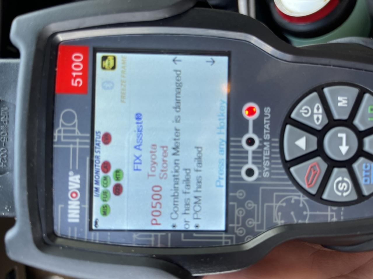

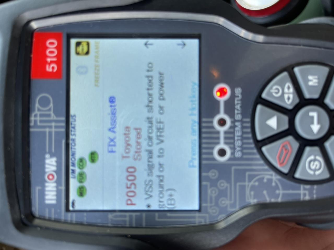

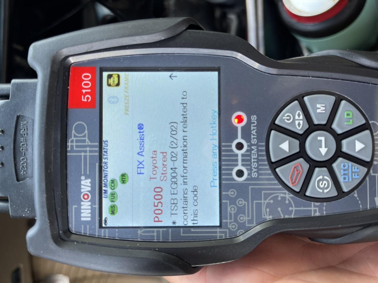

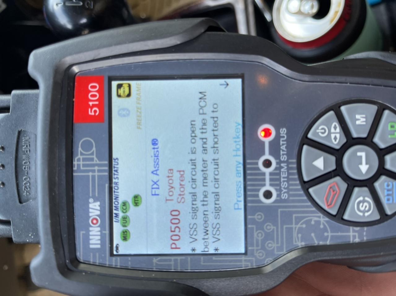

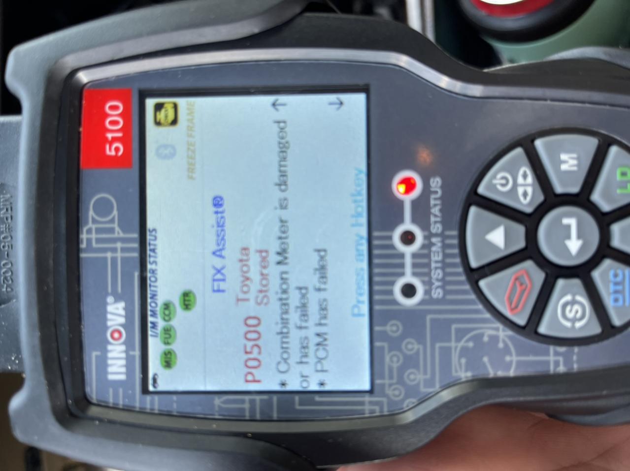

I have a 98 T4R manual 4x4 with abs codes 31 33 34 49 and a check engine light that returned code p0500. Speedometer it intermittently not working. Attached are pictures of the scanner. I’ve already cleaned the three wheel speed sensors and still nothing. Please advise next steps.

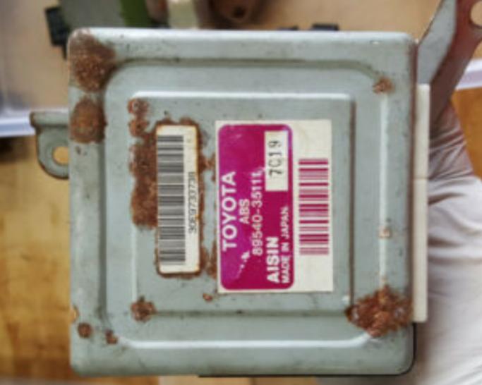

[MENTION=318903]RandyBobandy[/MENTION] is right. it's by the passenger
I swapped the ABS ecu with one from a 2000 automatic. At fist the abs light was off but the check engine light was still on and Speedo non functional. Second time starting the car the abs light was back on. This time with codes 31 32 33 34 and 41. I want to swap the vss next. Would it be the same part from a 2000 automatic as a 98 manual? What are the one part numbers for each? I found 15 different ones that all look different online.
