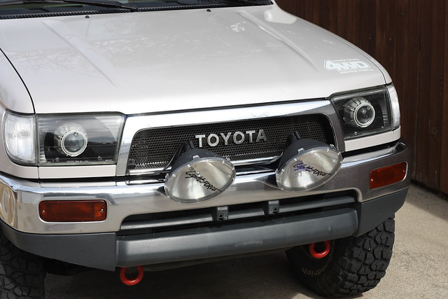

Finished my Satoshi grille
20120312-IMG_1113 by Headlight Hookup, on Flickr
I think it turned out suuuppper good. I mean my bondo work isn't perfect (first time using the stuff) but I'm happy. The Lightforces cover most of the emblem when they are up - but when I build a front bumper and the lights are farther away from the grille, it will be more visible.

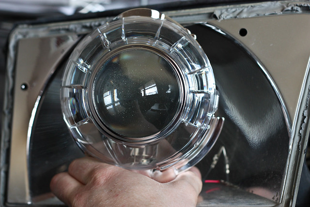

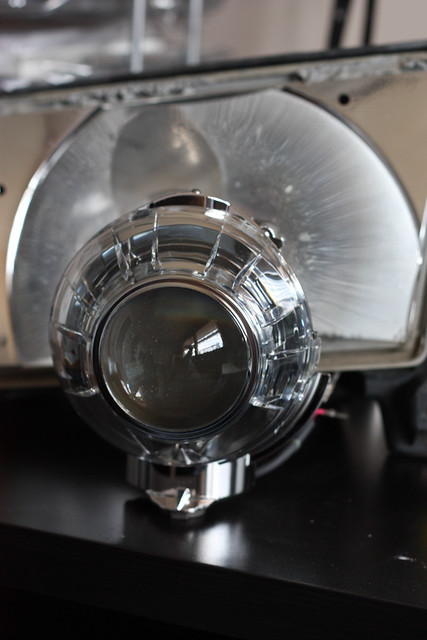

The Lightforces are officially converted to 50w HID's. Yes, they are bright. (pics of output soon)
And, the holy grail LS460 Bi-Xenon projectors up against my "tester" set of headlamps. I have to see how to cut them to get the projectors to even fit in the reflector bowl before I try to cut up my new set of 99+ headlights. As you can see I have my work cut out for me. lol no pun intended.
20120308-IMG_1074 by Headlight Hookup, on Flickr
20120308-IMG_1076 by Headlight Hookup, on Flickr

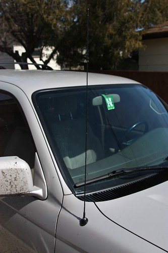

First, I finally completed the "Tacoma Whip Mod." I ordered a new assembly and it came with a silver antenna. I wanted a black one so I was lucky enough to find a black mast on a wrecked Tacoma about a month ago and got it for free! The black mast seems more flexible than the silver mast, so that will work great for my needs. Funny thing was a really bent my auto-antenna mast when I was wheeling on the weekend so this could not have happened at a better time... no more antenna worries! Sorry no pics of the process, pretty straight forward other than those annoying fender lining clips... I just cut them off and bought a few new ones to replace them with. The finished result:

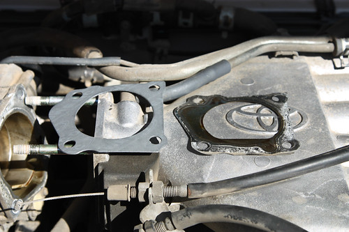

Next, I had ordered the TRD throttle body gasket. There has been some debate as to weather or not this has any real improvements but I thought, for $6, what the hell....
TRD part #: PTR29-60030
Side by side of old vs. new:
20120403-IMG_1164 by Headlight Hookup, on Flickr
You can see the old gasket is squared off and not fully round like the TRD gasket. Driving it around today I don't think there is much difference in power or anything but subjectively I think there is an increase in throttle response. I also believe in all the little things adding up to something more substantial, so maybe this, the Airaid intake pipe, and the deckplate (when I get around to those latter two) will ad up to minimal increase in power. Hey, every bit helps!!

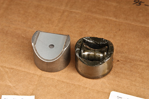

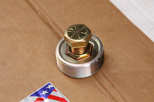

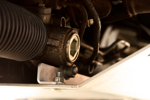

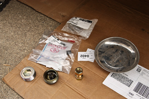

Finally was the steering rack guide. All the parts (new stuff and some old)
20120403-IMG_1166 by Headlight Hookup, on Flickr
I found this bolt/nut combo lying around my garage and used it to thread in the new cap.
20120403-IMG_1168 by Headlight Hookup, on Flickr
New roller guide sitting next to the old guide:
20120403-IMG_1169 by Headlight Hookup, on Flickr
All buttoned up:
20120403-IMG_1170 by Headlight Hookup, on Flickr
*keep in mind that if you use the bolt/nut method to thread in the new cap, you won't be able to reverse it. The bolt and nut will just un-thread instead of the cap. I just turned the new cap in until there was two thread showing. In retrospect I will hunt for a "5/8 threaded rod connector" or something next time I'm at the hardware store, at which point I can torque it to 18ft/lbs and back it off slightly.

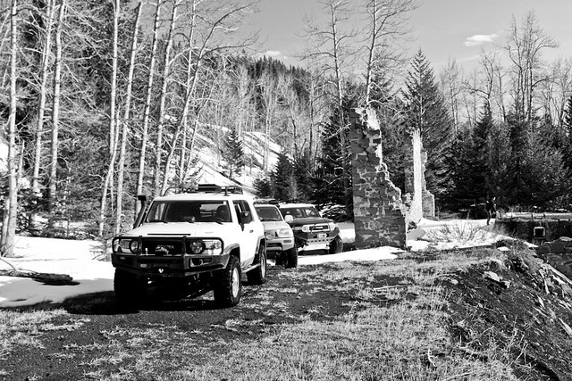

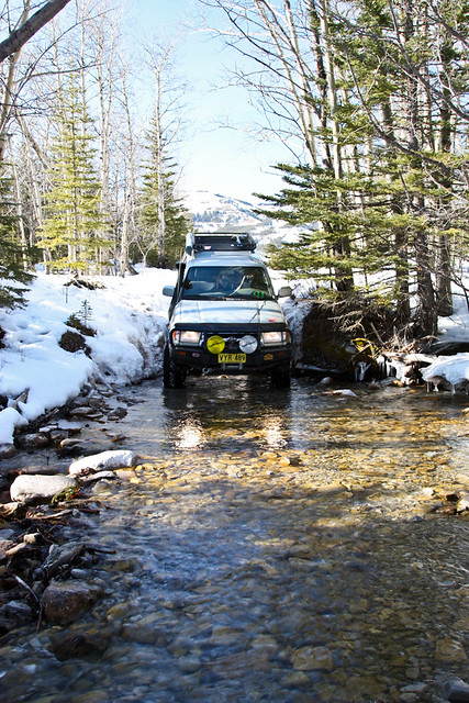

It was a great day today! Everyone was grinning ear to ear in their Toyota 4WD's and were eagerly awaiting their next stuck (myself included). The snow was so unpredictable that you didn't know if you were going to sink or not. When that oops did happen, boy did you ever sink! If you wanted experience snow wheeling, technical recoveries...This was the run to be on! Great day Ad!

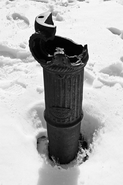

BTW, what's that broken metal pipe all about? Hope nobody hit that thing.
lol thanks BFAD! I guess I should explain the broken pipe... The area we were in is full of old coal mining structures. They used to mine coal for steam train engines there back in the day (wish I had more specific dates). Some of the ruins in the other pics are from the same town and that metal pipe is actually a super old fire hydrant. I just thought it was pretty cool :nerd:
