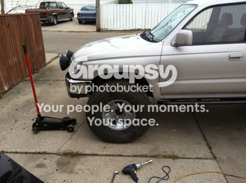

Keep in mind I'm at like 2-2.25" of lift in the front right now. I could technically drive around with that wheel/tire/spacer combo right now on the street if I had to. However there would need to be some serious tubbing done at this lift height to make it functional offroad. I'm not really worried about the rear, it's the front that's the issue.
So my current thinking is not to run 35's. I was thinking of either going with a 305/70/16 (33x12.50 essentially) or getting 17" wheels and running a 285/75/17 tire (34x11.5 essentially). I kind of think the 34's might be a good compromise as they are just over an inch narrower and about an inch smaller.

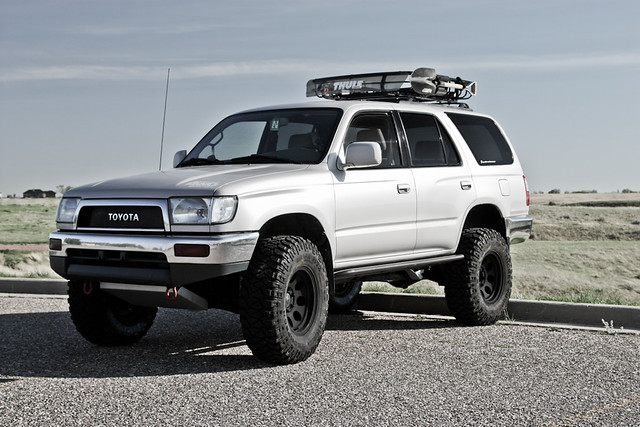

A few pics with tha new kicks:

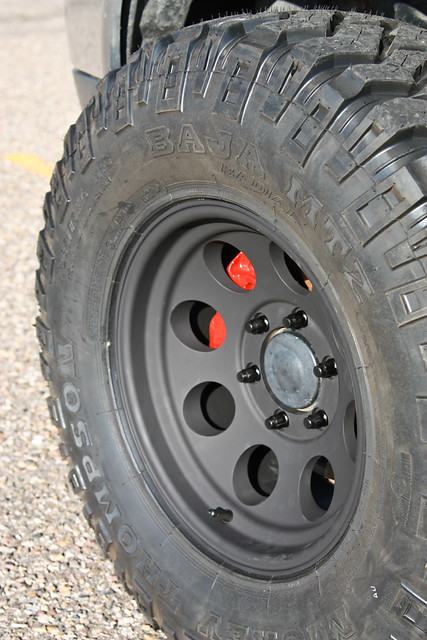

Wheels - ProComp 7069, 16x8, 4" BS (same wheel as the popular 8069 but is 'matte' finished instead of gloss - 8069 is discontinued; clearing the Tundra brakes with space to spare!)
Tires - 285/75/16 MTZ's
20120514-IMG_1582 by Headlight Hookup, on Flickr

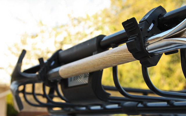

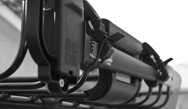

Also ordered some QuickFist clamps for my shovel and axe in order to mount on my Thule basket:
20120514-IMG_1573 by Headlight Hookup, on Flickr
20120514-IMG_1571 by Headlight Hookup, on Flickr

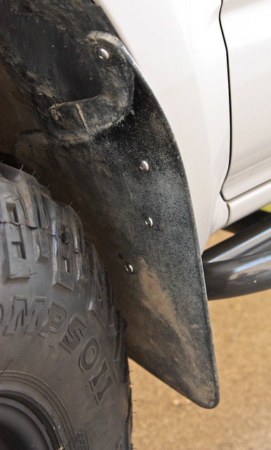

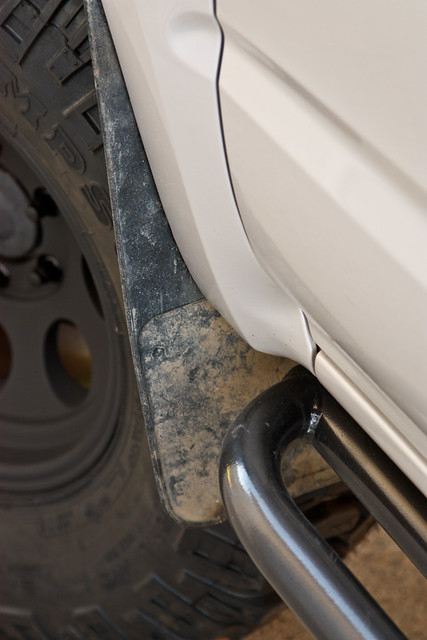

Seeing as how the tires poke a little more than my last set, I thought I'd try to keep some of the mud/rocks under control by using some old mudflaps I had lying around. Actually, the old mud flaps were ripped off of my previous black Toyota on my first-ever wheeling trip with CT4WD to Maclean, where I got stuck for several hours.... hahah oh reminisce.... Hope they will stay on the Duster a little longer!
20120514-IMG_1570 by Headlight Hookup, on Flickr
