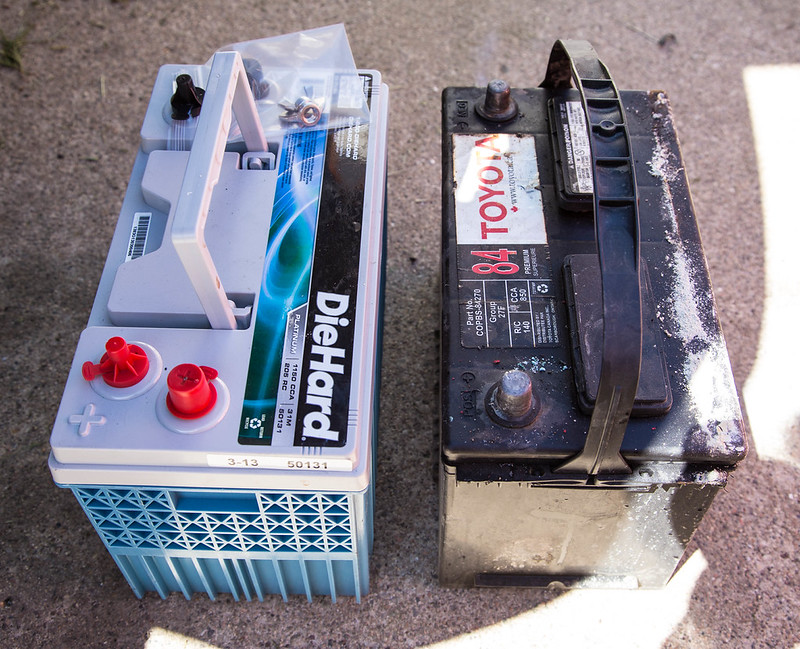

Old vs. New
20120629-IMG_1656.jpg by RickaShay24, on Flickr

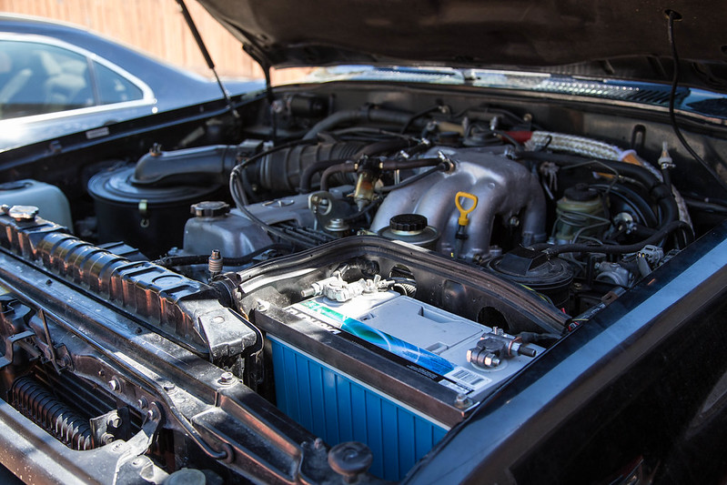

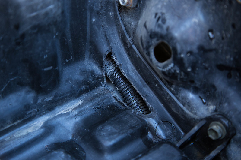

Instead of trimming the fins on the battery itself, I trimmed a small corner of the battery box:
20120629-IMG_1658.jpg by RickaShay24, on Flickr
With the above modification, I used the factory (or at least the PO's) J-screws and a piece of "L-channel" I had lying around. I plan on removing the factory battery box in the near future and having a real battery box fabbed up.
New home in the engine bay:

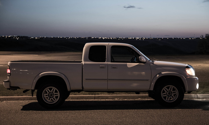

The Tundra got some lovin' while Tom Cruiser is away at the welder:
SCS Stealth 6 in Matte Silver - limited edition wheel and wanted to stray away from black wheels for my DD and do something "different". 265/70/17 Cooper ST Maxx tires. The tires cleared fine with the stock wheels but as soon as the SCS's went on they rubbed like a mofo on the pinch welds due to the more agressive wheel offset. I cut a lot of the pinch weld off, and now it's good to go! I've already logged about 4-5000kms on the tires and they have been great in the muddy leases at full psi and are surprisingly quiet on the highway. Super happy with them so far... Oh and I de-badged the Tundra somewhere along the line.

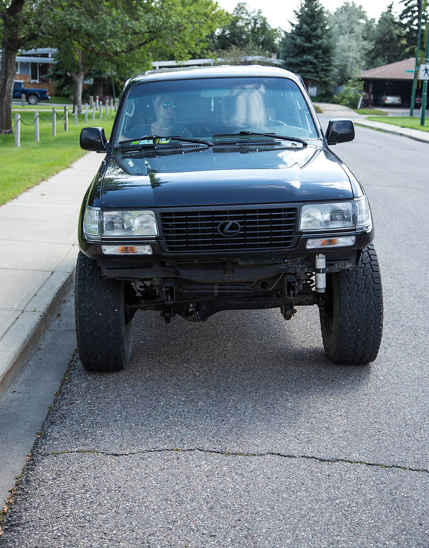

LX450 holes filled and ready for LineX - yah, the paint is in terrible shape. Going to do a proper detail once the LineX is done.
