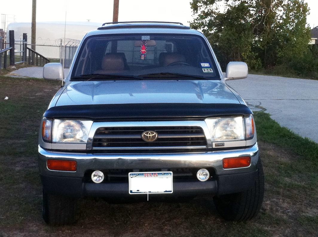

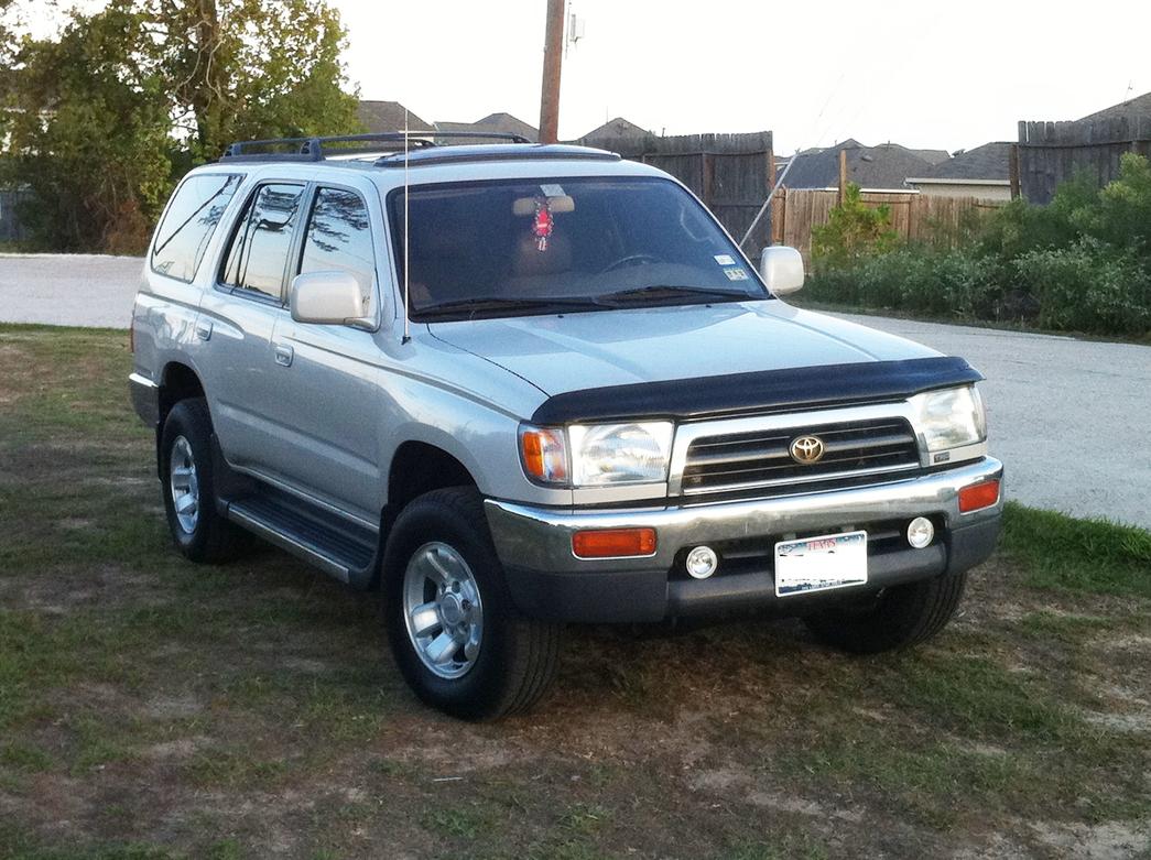

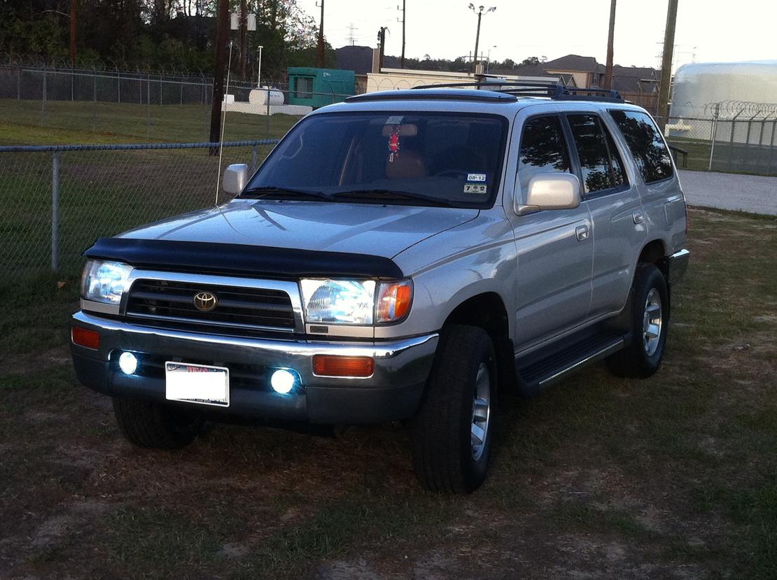

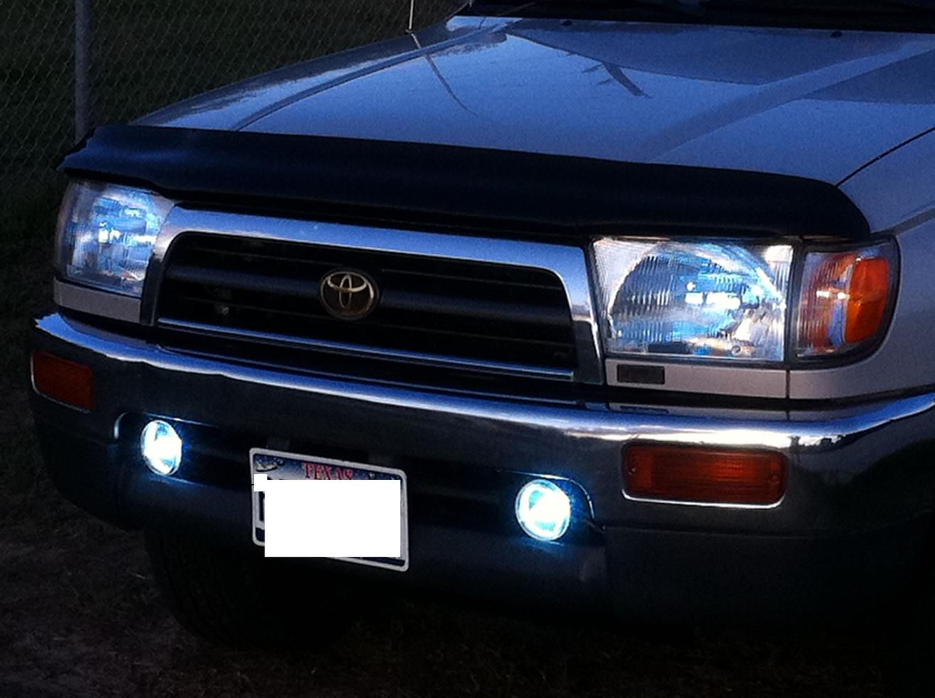

Hi, I just install HID's on my 98 SR5 but i don't like the light pattern from the OEM Headlight's, i will like to install the Headlight's & grill from a 99+ model or maybe just the Headlight, 96-98 unlike the 99+ r not clear. My question is can i install the 99+ OEM headlight's on my 98, I dont like the Ebay aftermarket clear headlight's for my year. here i have some pictures from my 4Runner, Thanks

You can use either 99+ headlights, 99+ grill, or a combination of the two. They will both work.
Be very carful with the headlights you buy. Some of the aftermarket headlights have really bad light patterns.

I know my friend, thats why i like to buy the OEM 99+ because they r clear & I have seen them with HID's and I like the light pattern from them. This 98 headlight r NOT clear and the HID beam is all over, not like on my Scion tC that have clear headlight;s and the light beam is good. Thanks for the prompt replay to my question . Thanks

It's not the frosted glass that causes the bad beam pattern on the '96-98 head lights.

Yeah, even in OEM 99-01 headlights your still going to get crappy light output with HID's. Like Clemson said, it's not the frosted lens. I'll post pics of the disaster if you'd like, there in here somewhere. Or just look up my YouTube video of a HID PnP kit vs a projector retrofit.

it sucks the 4runner housing is so bad with HID's im not sure how your Scion or Miata look but here are the results of my HIDS in the factory housings
005-1.jpg~original
then the wonderful retrofit
installed007-1.jpg~original
