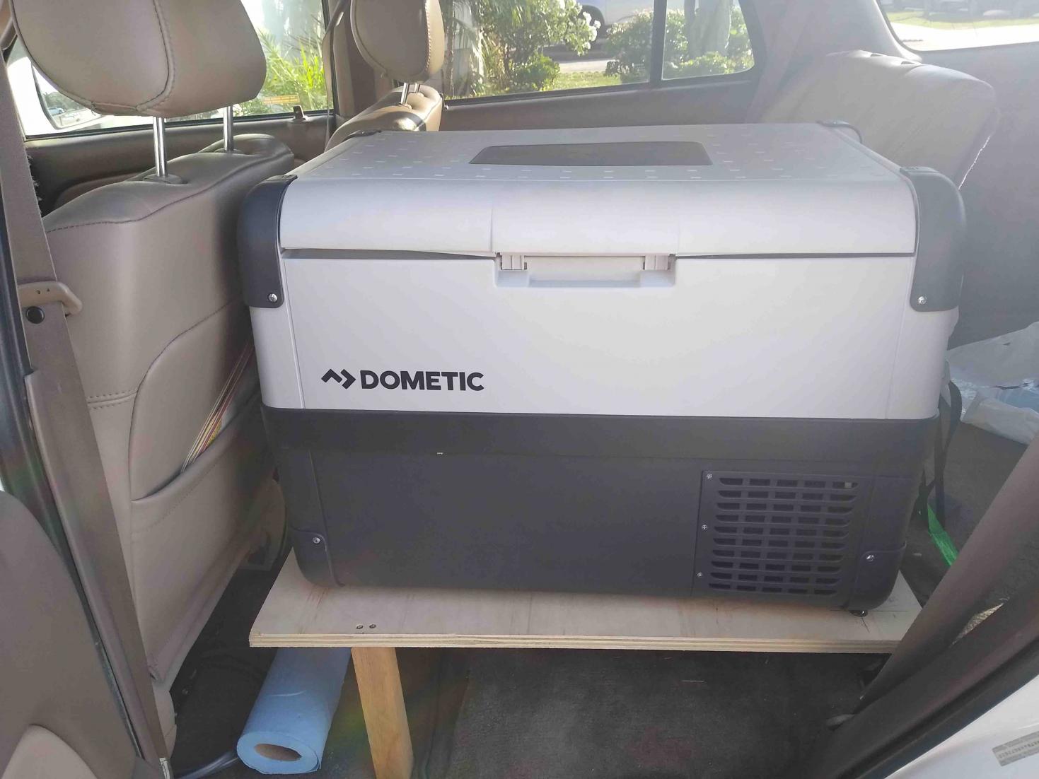

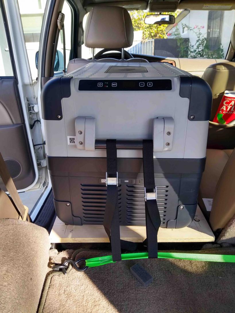

I mocked up Version 1.0 by bolting the 3/4 ply to the seat back brackets (will be shimming it level) and just sticking some legs on the "front".
An acquaintance of mine is going to make bracket supports that attach to the rear seat brackets that will attach to the fridge deck from underneath leaving the entire backseat foot area available for my solar auxiliary battery box. That supplies the power for the fridge will allowing it to DC to DC charge as well as solar charge.
Vers. 1.1 will be with brackets, leveled, and Spray decked of some sort.
A rear deck is slated for the cargo area to which will be attached some sort of tie down ring track to secure the fridge and other cargo.
