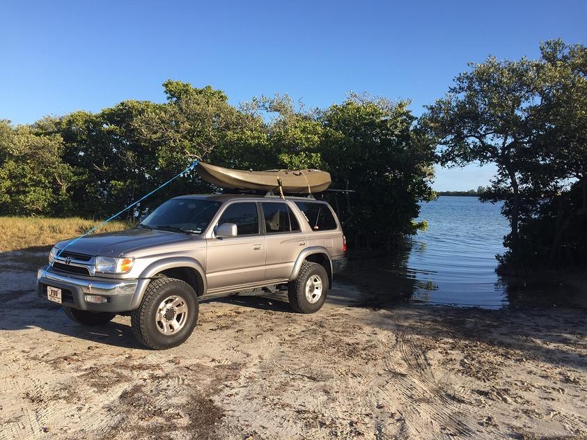

Thanks man. I like the look of my truck so far. It is coming along nicely IMO. I don't have exact measurements but here is a recent pic I took last weekend when we were out kayaking. Full load in the rear and the 60 pound kayak and the ride was still great. I like the OME 906 springs with the 5100 Bilsteins out back. Gives it a little more backbone in my opinion and wont sag as much as stock coils. I went from 02 coils with 120,000 miles to brand new 99s all around and brand new shocks. Ride is night and day and I don't think you will be disappointed.

Just to clarify...You currently have 4600/99 Talls in front, and 5100/906 in the rear?
Your ride looks great, and surprisingly looks level. I assumed the 99 front would be too low for the 906 rear. I've considered 906 rear with the OME 880 front, as well as the TRD Tundra front. But you've got me reconsidering.
Hub to fender measurements would be helpful if you get a free minute!
