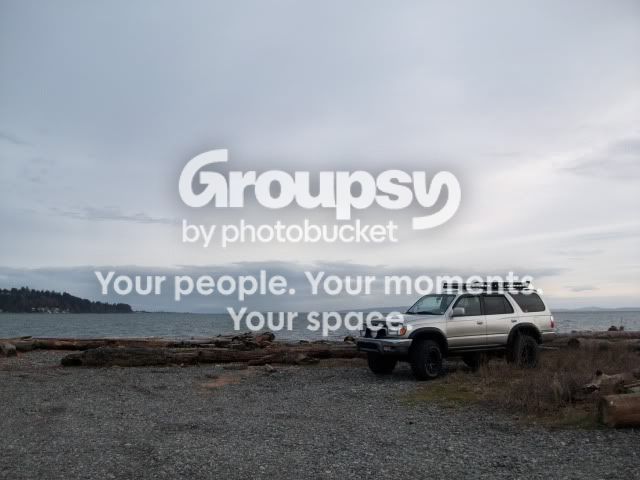

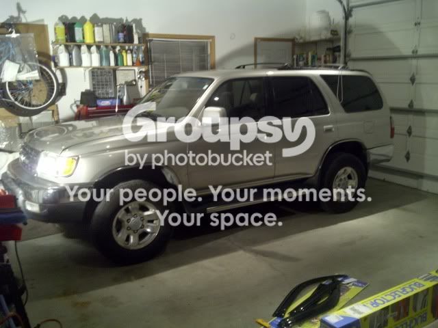

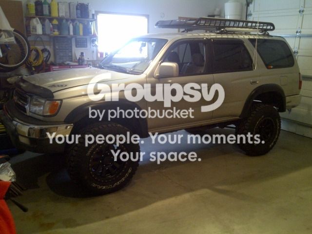

This is is how it sits right now March 2013
Vancouver505_zps0fa8033e.jpg~original
Vancouver186_zps51b6b96a.jpg~original
Vancouver096_zps91af6b6c.jpg~original

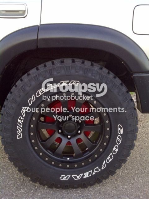

Wheels & Tires:
Goodyear DURATRAC LT285/70R17
ProComp 7036 17x9

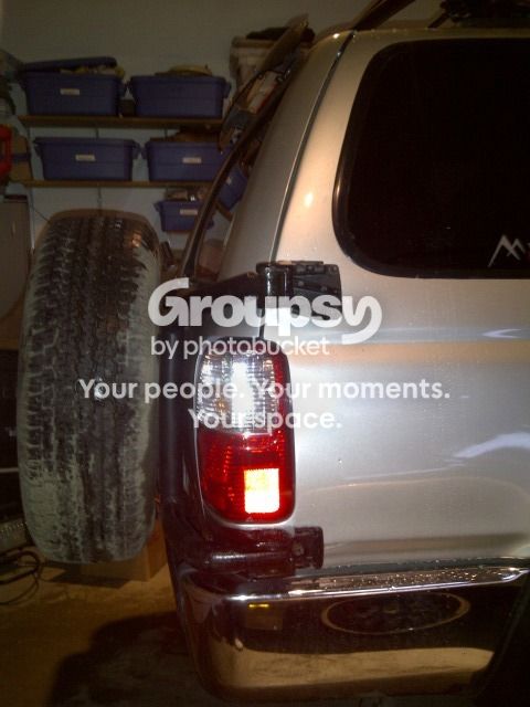

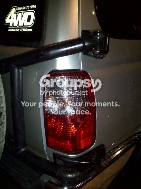

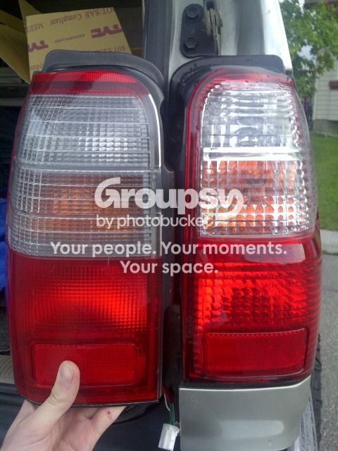

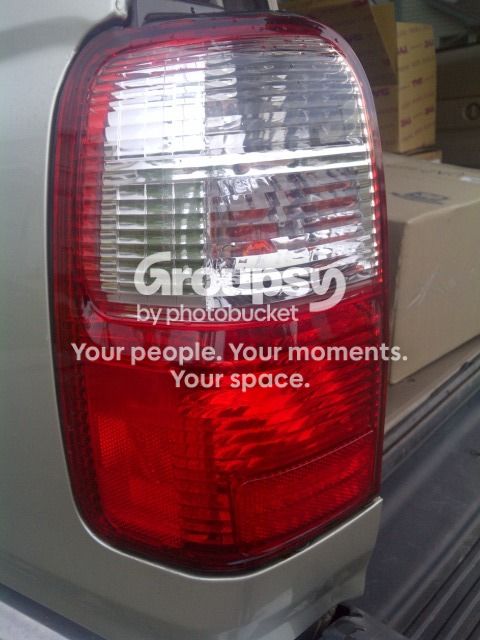

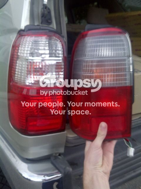

02 4RUNNER Clear tail lights

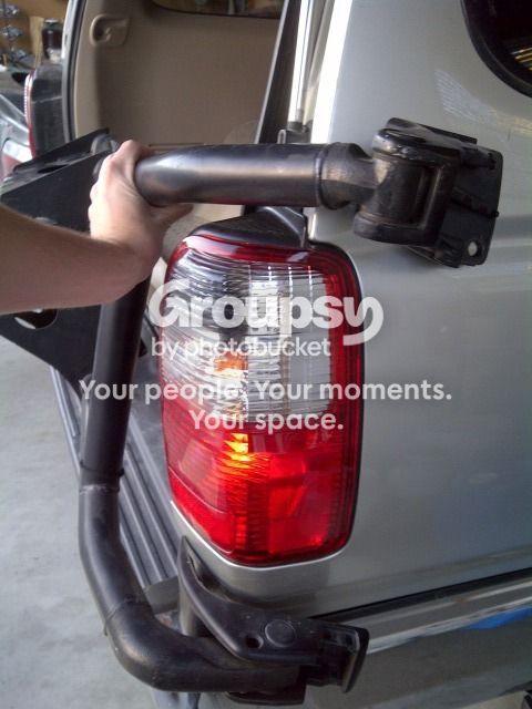

Rola Roof Rack with extension welded
2x Quick-fist Clamps
Under Gravel Guard

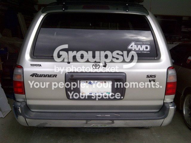

Hilux Surf Hatch
Hilux Surf Tire Carrier

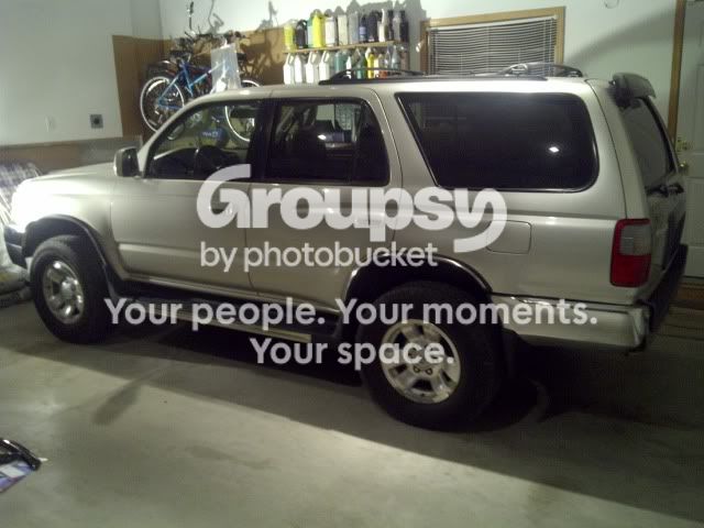

so i will starrt my build thread here so far what i have done to it
Pics of it on day one Sept 18 2011

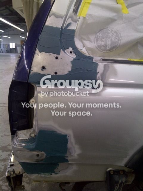

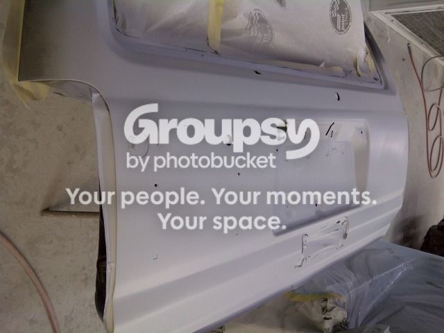

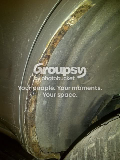

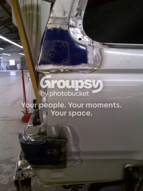

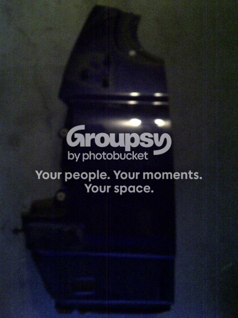

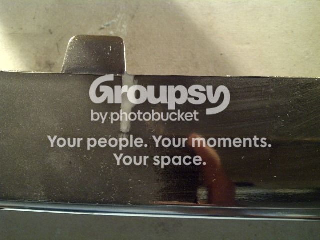

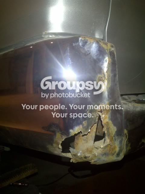

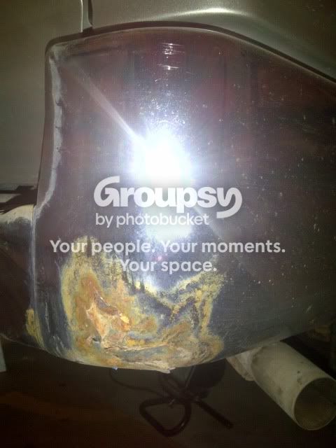

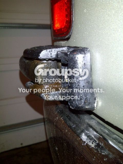

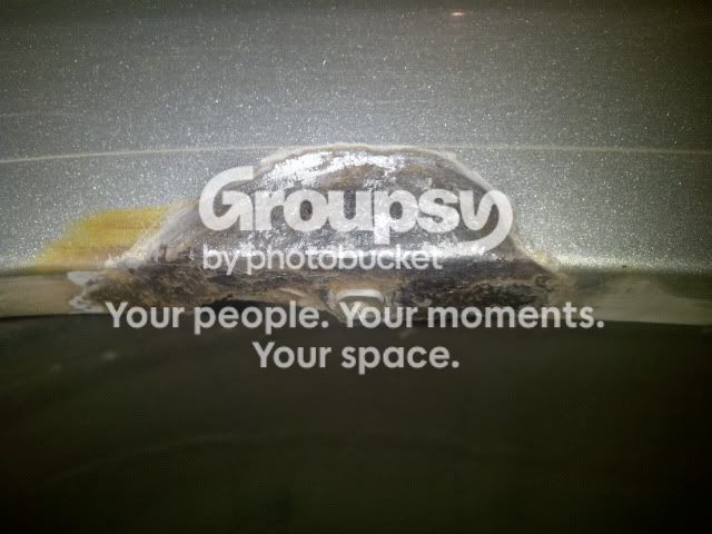

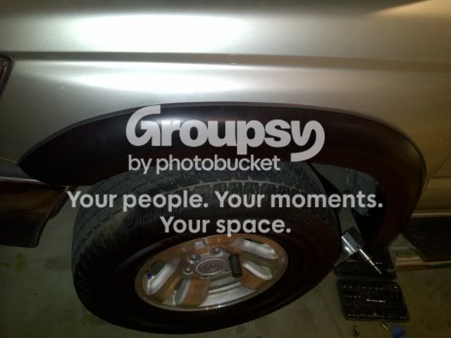

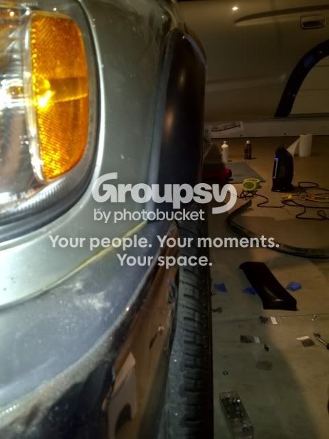

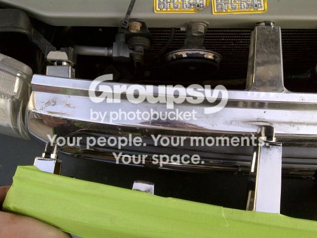

first of its time to tackle the rust
got rid of the old rusted one and piced up a new chrome one ffrom a buddie of mine
When i finished and cleanded up the rust i went out an bought the bushwaker extend-a-fender ones and so far they look pre mean and aggresive and got rid of the SR5

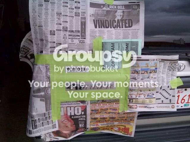

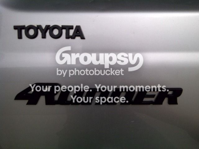

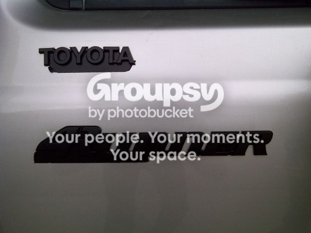

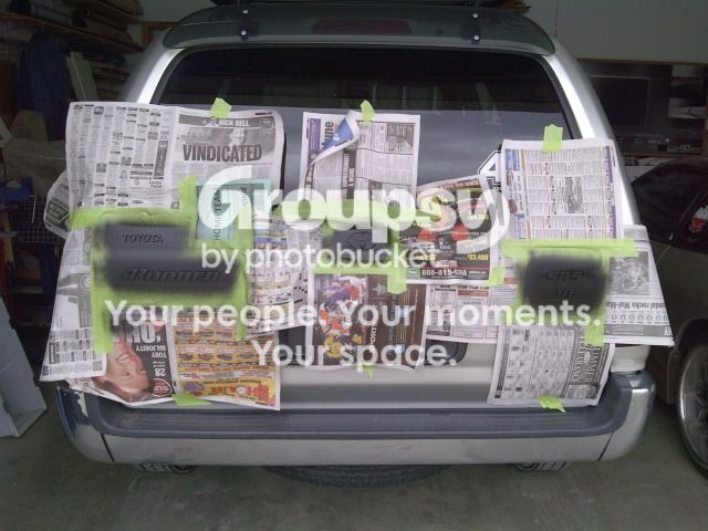

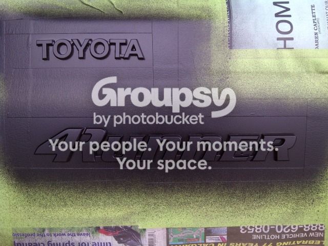

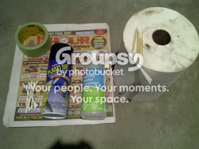

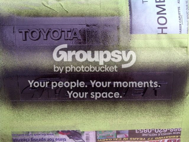

Stuff You Need:
1. Can of PlastiDip purchased from Auto Value
2. Tooth Picks
3. Masking Tape
4. Newspaper
5. Q-Tips
6. Rubbing Alcohol, Soap, water
7. Sunny Warm Day
8. Paper Towels

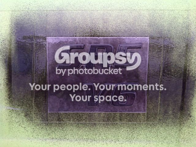

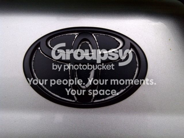

IMG-20120504-00143.jpg~original
1. Clean around your emblems, Use soap and water if your Toyota is real dirty. Make sure you get down into the cracks and nooks, Dry it off and get back in there with some Q-tip's & Rubbing alcohol or any type of alcohol (but don't drink while you do this hahaha) Get into the cracks again. Again make sure the surface is dry before you even paint.
IMG-20120504-00122.jpg~original

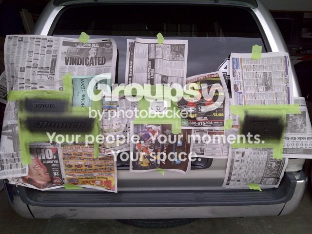

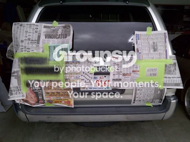

2. Mask off the area with some masking tape and newspaper in case of overspray.
IMG-20120504-00123.jpg~original

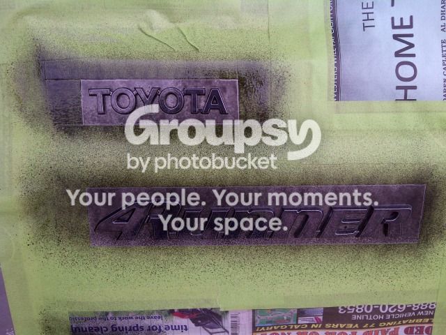

3. Now you're ready to spray.
4. Make sure you shake that can up and do a test pass on some newspaper so you see how much comes out of the nozzle. From there shoot a thin coat on your emblems.
IMG-20120504-00124.jpg~original
5. Wait a few minutes and make a darker pass.
IMG-20120504-00125.jpg~original
6. Then give it 15-20 minutes then apply a second coat. I went and did a 3rd coat.
7. In the time I was waiting for it to dry up a little bit I started to tape up the other side to not waste too much time.
IMG-20120504-00126.jpg~original
IMG-20120504-00128.jpg~original
8. Repeat steps 1-6
IMG-20120504-00127.jpg~original
IMG-20120504-00129.jpg~original
IMG-20120504-00130.jpg~original
IMG-20120504-00131.jpg~original
9. Now let them dry till they are flat black and the glossiness from the wet paint has disappeared, about 30 minutes the can says to wait 1 hour but I decided to be a rebel and do it in 30 minutes instead.
IMG-20120504-00132.jpg~original

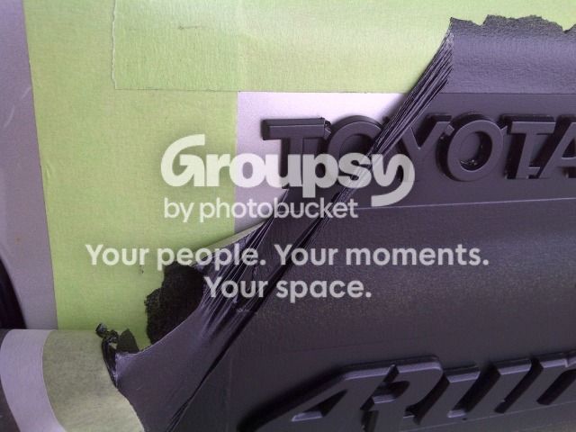

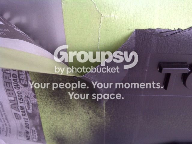

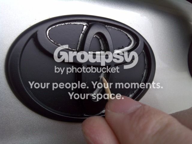

10. . Now peel off the masking tape.... You'll notice the rubber will want to pull off with the tape, that's no problem, just don't go too fast when the rubber breaks and you have to get into the little cracks of the emblems to pull it off.
IMG-20120504-00133.jpg~original
IMG-20120504-00134.jpg~original
IMG-20120504-00135.jpg~original
11. . Now with your fingers, just begin peeling it back. The PlastiDip will peel off your paint no problem and it begins breaking around where the emblem adhere to the car.
IMG-20120504-00136.jpg~original
12. And now you may have little difficulty to get into the middle areas, just use your tooth picks and pick at it.. It'll just peel off like it did before.
13. I used the tooth pick to kind of cut away at the corners like a knife.
IMG-20120504-00139.jpg~original
IMG-20120504-00140.jpg~original
14. The best part is now!! Your done and time to sit back and admire your work you have done!!
IMG-20120504-00138.jpg~original
IMG-20120504-00141.jpg~original

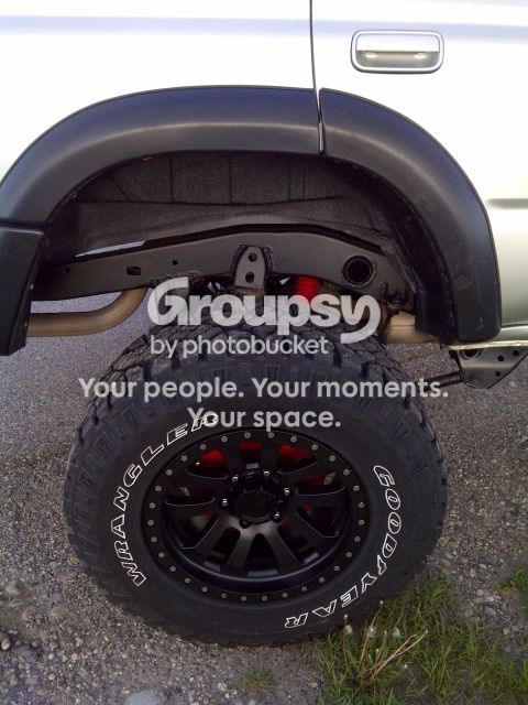

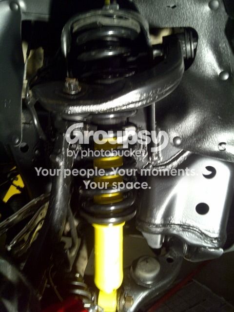

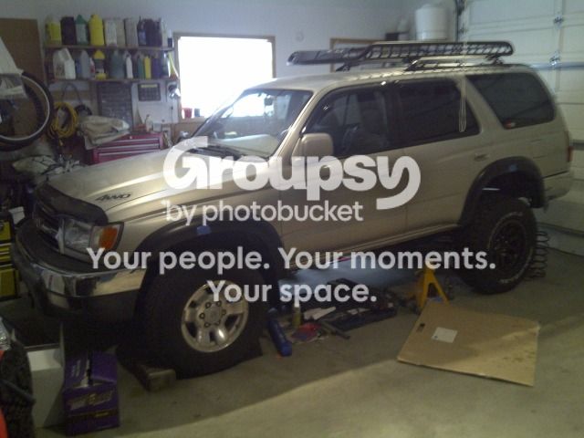

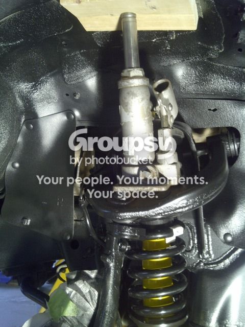

so i did my lift here are som pics of the prosses did not have to manty but still some better than none
Lift:
Front
OME 90004 shocks
OME 882 springs
Rear
80 series landcruiser shocks and springs
stock ride height
IMG-20120604-00207.jpg~original

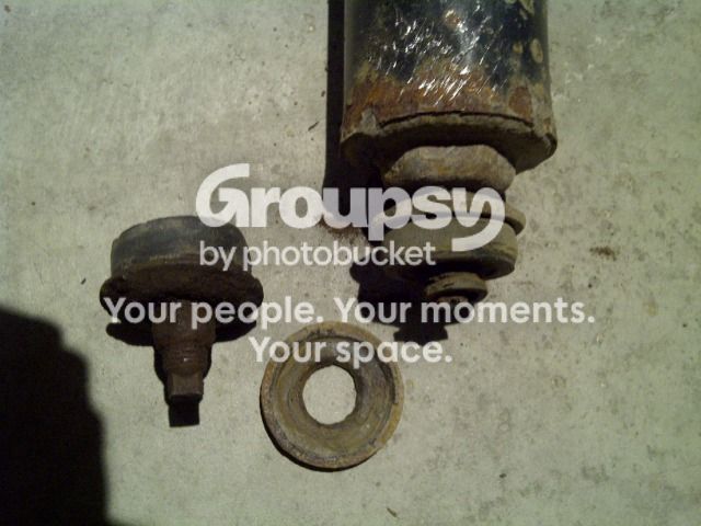

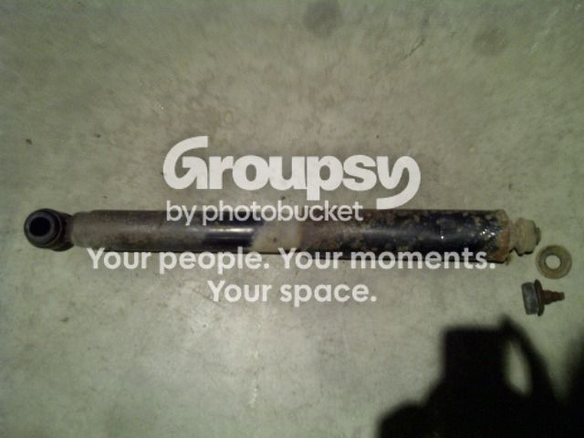

i started with the rear and the rear shocks both of them i snaped the tip cause of rust
IMG-20120530-00189.jpg~original
IMG-20120530-00188.jpg~original

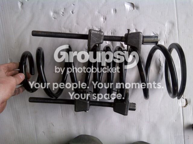

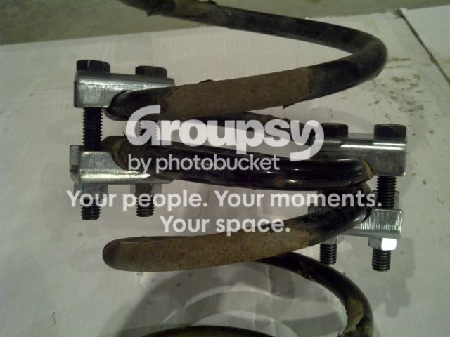

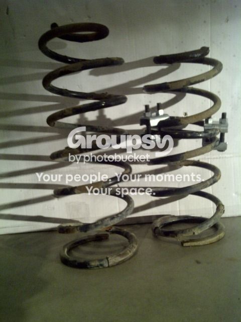

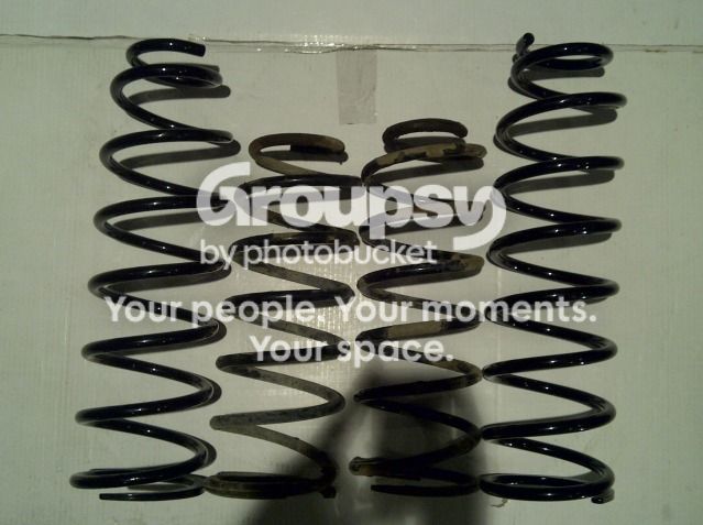

next i tried to rig a spring compressor and it worked fine to compress the old spring had enough to clamp them down and slide them out
IMG-20120601-00199.jpg~original
here is a picture of the old stock 4 runner springs of how much i needed to compress not very much so that was simple
IMG-20120601-00200.jpg~original
what i decided to do was to show off the 4 runner springs compared to the 80 series Cruiser
IMG-20120601-00203.jpg~original
so for the new springs i could not use the old system so i went to autovalue and rented the spring compressor and compressed it almost to the max
IMG-20120602-00204.jpg~original

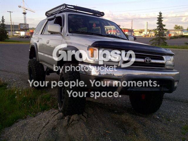

sorry thats all the pics for the rear now the new height ride
IMG-20120604-00208.jpg~original
IMG-20120604-00210.jpg~original
IMG-20120604-00211.jpg~original
this next picture reminds me of the 70's old school pimp vans with the front end low and the rear lifted hahaha
IMG-20120605-00213.jpg~original

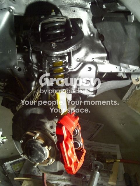

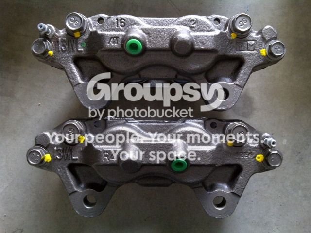

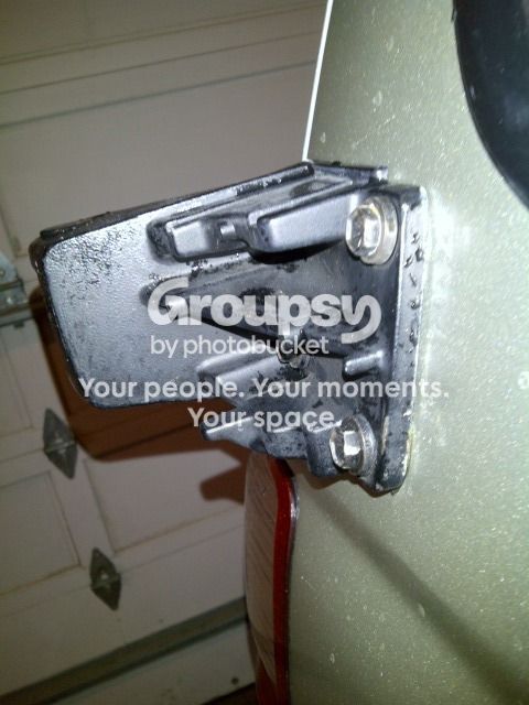

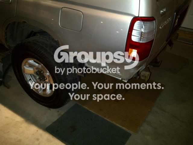

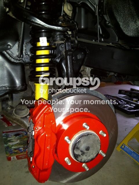

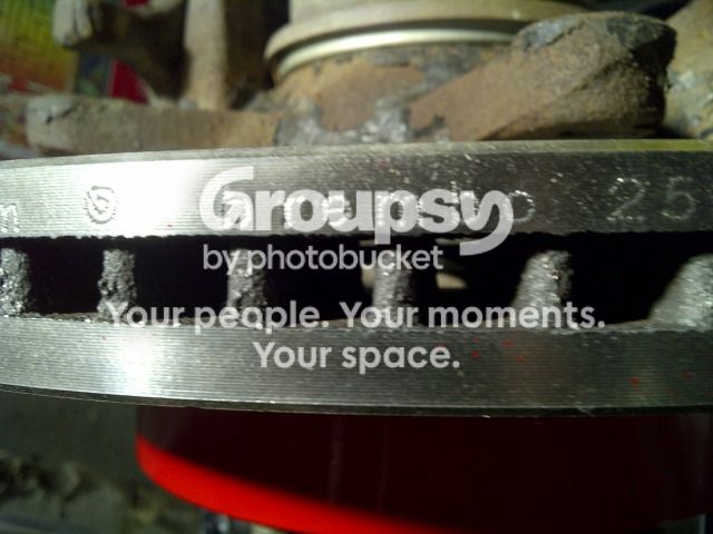

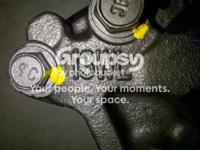

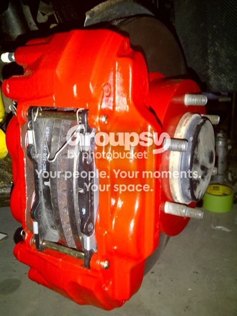

i have done the Tundra brake upgrade and i am very pleased with the results not more warped shaking car :)
i have used the 13WL (231mm) calipers they are the larger of the 2 sets and installing it was pretty easy i found a awsome site for the upgrade
http://www.toyota-4runner.org/3rd-g...ements-231mm-13wl-tundra-calipers-rotors.html
IMG-20120607-00221.jpg~original
IMG-20120607-00220.jpg~original
IMG-20120607-00217.jpg~original
IMG-20120607-00219.jpg~original

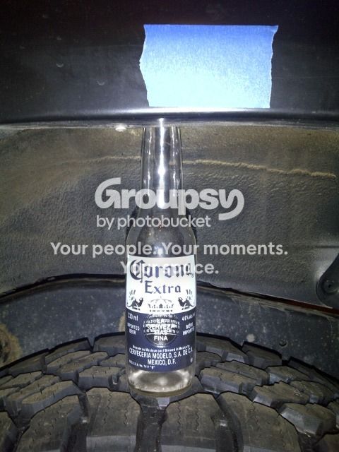

next was the pain in the butt i broke couple 2x4's with the bottle jack and the fender wheel well

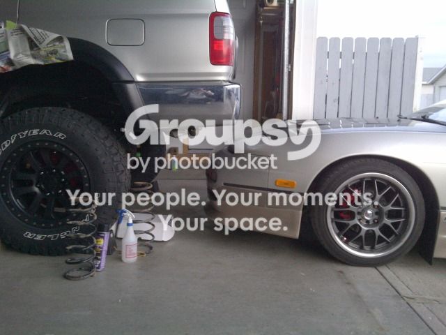

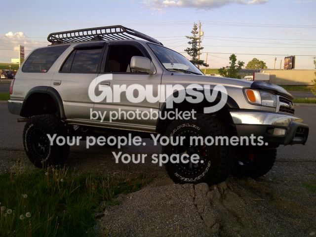

the lift is done and i decided to have some fast and furious pic and the 240sx almost fits right under
IMG-20120608-00228.jpg~original
IMG-20120611-00234.jpg~original
IMG-20120612-00243.jpg~original
IMG-20120612-00245.jpg~original
IMG-20120612-00246.jpg~original
IMG-20120612-00247.jpg~original

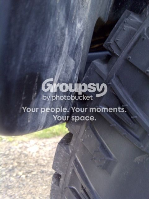

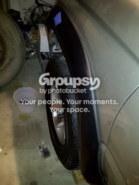

and the first rubbing not sure becasue this is against the fender
IMG-20120612-00248.jpg~original

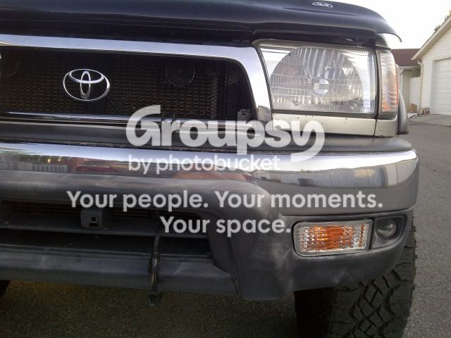

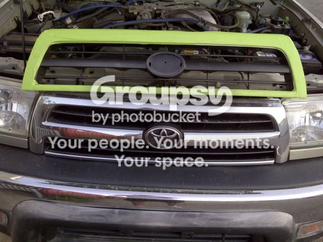

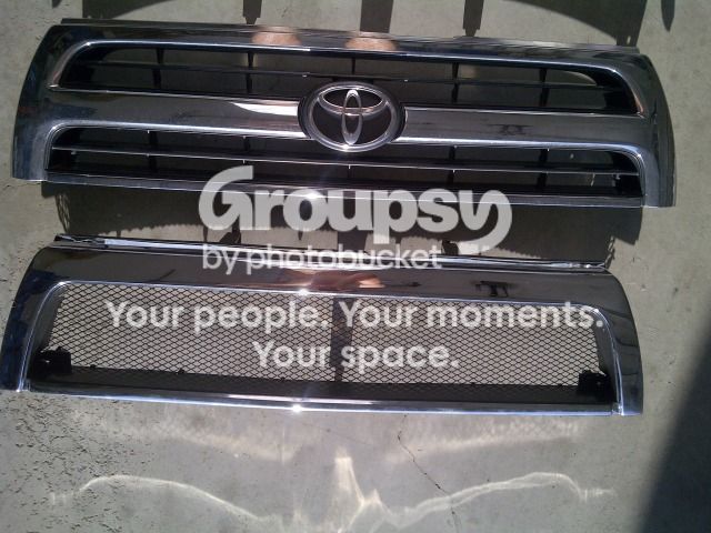

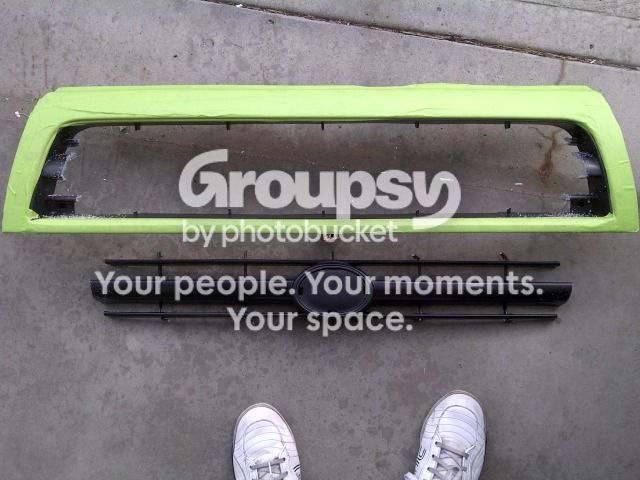

Alright so here we will start off the DIY thread,pretty easy to do nothing hard
tools needed:
-making tape
-any color of paint you would like
-dremel
-cutoff wheel for the dremel
-rubbing alcohol
-paper towels
-tin snips
-auto-body bondo
-file/sandpaper
- time and patience

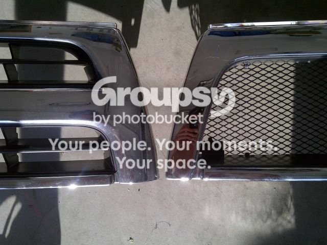

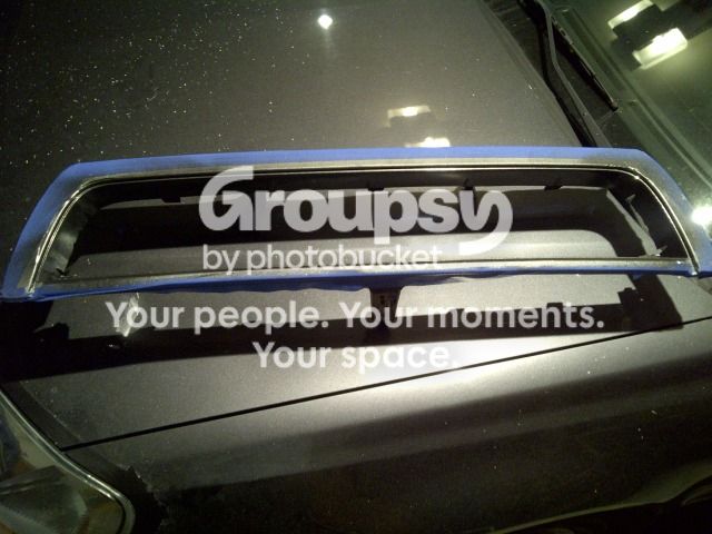

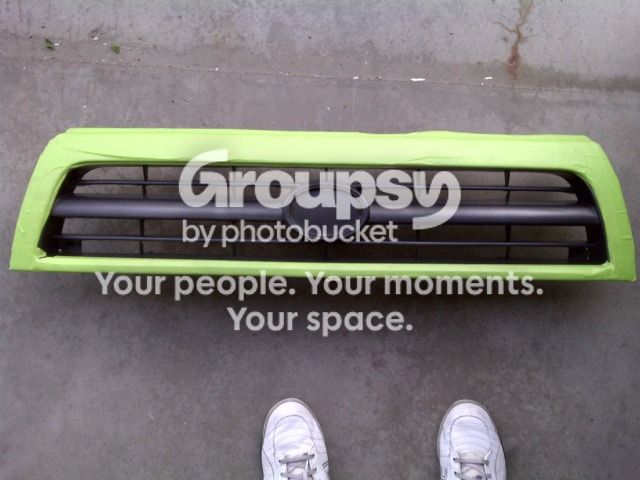

The difference in the 2 grills stock nothing cut up yet (already taped up so i don't scratch the chrome)
IMG-20120815-00395.jpg~original
IMG-20120815-00396.jpg~original
now time to start cutting
IMG-20120815-00397.jpg~original
all i did was snap off the thin grills off
IMG-20120815-00398.jpg~original

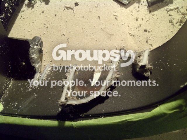

i used a dremel for this next step and i used a mini cutoff wheel and cut away the thicker parts
IMG-20120815-00400.jpg~original
notice how i did not cut off the two corner off since the are there to hold the grill in place all i did was trim around to make it look flush
IMG-20120815-00403.jpg~original
IMG-20120815-00405.jpg~original
next step was a little bit more trickey as i had to cut as close as i can to the side wall so there will be less sanding to make a flush surface
from this
IMG-20120815-00407.jpg~original
to this
IMG-20120815-00406.jpg~original

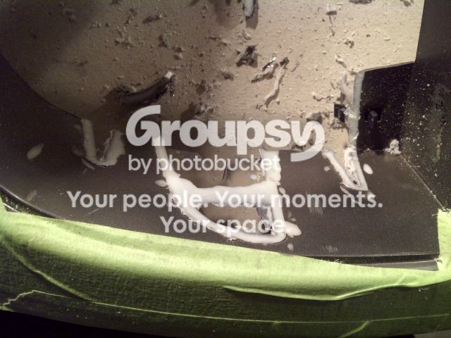

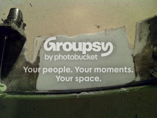

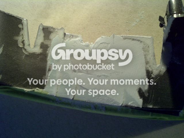

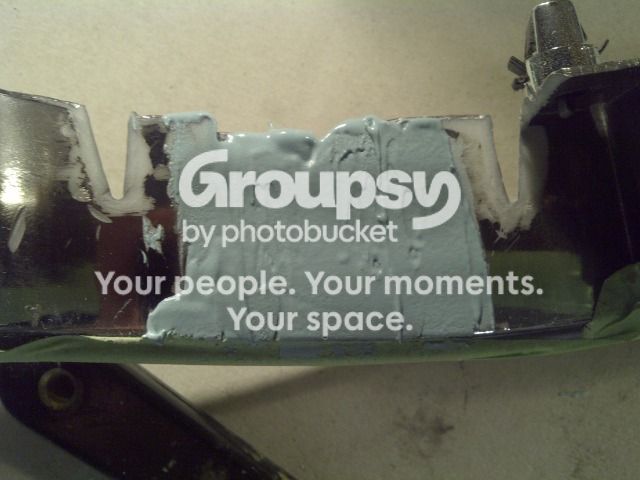

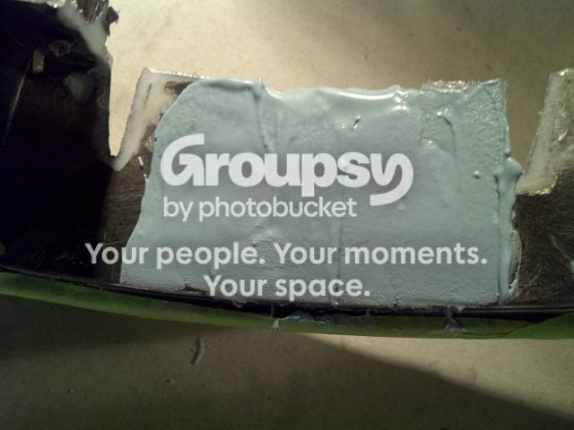

now on to the bond to fill in the massive hole that has been sanded down all i did was take a piece of tape and from the backside taped so the bodo wont fall thru, it and flipped it and started to bondo. notice where there is almost a bulge looking sale thats where the massive hole was once it dried up i did a quick layer of bondo on the other side to make sure when i sand down it wont appear there
sorry about the crappy bondo job im not a body guy so it wont smear as good as id like it too
IMG-20120816-00409.jpg~original
IMG-20120816-00410.jpg~original
IMG-20120816-00411.jpg~original
IMG-20120816-00412.jpg~original
i put 2 layers of bondo to make a nice finish
to file it down all i used was a hand file and some fine sand paper
IMG-20120816-00413.jpg~original

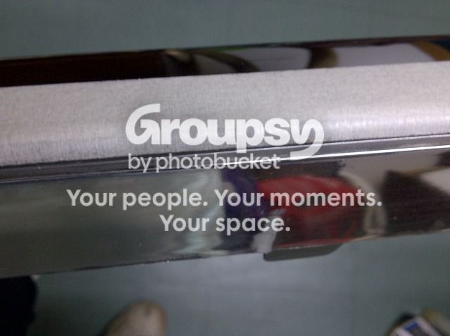

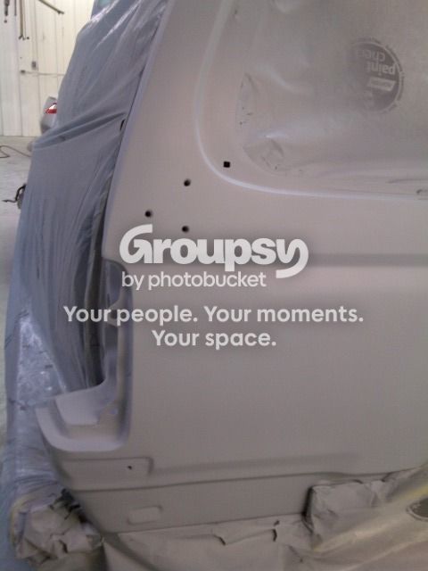

next step i recommend doing sine this was just rubbing alcohol and it striped the old paint off down to the chrome as you can see
IMG-20120816-00414.jpg~original
IMG-20120816-00415.jpg~original
after that has been all striped off and clean with wax and grease remover, i went with a gunmetal grey color by dupli-color and sprayed on a few light coats of paint
IMG-20120816-00418.jpg~original
IMG-20120816-00419.jpg~original

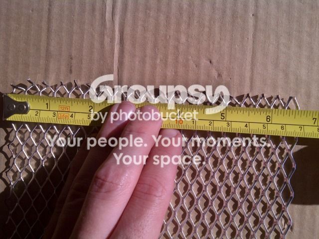

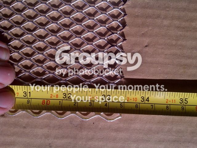

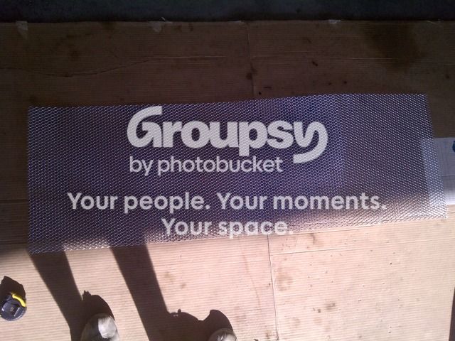

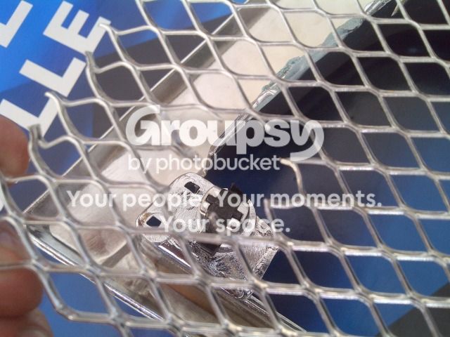

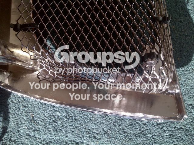

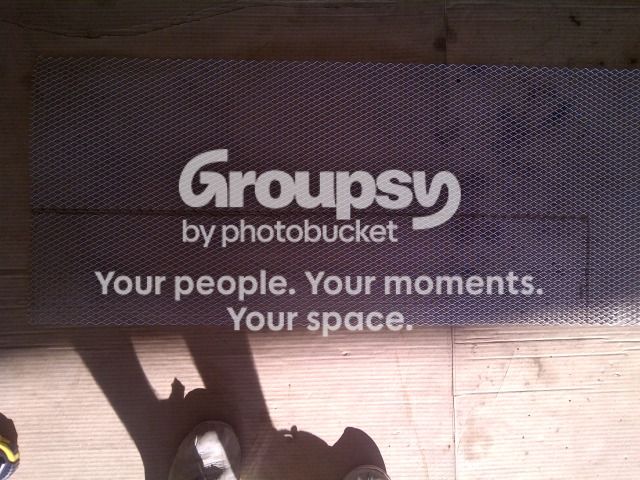

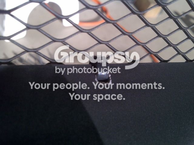

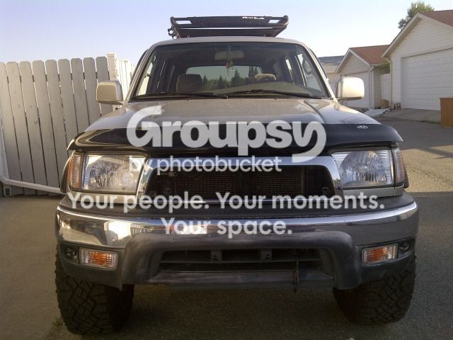

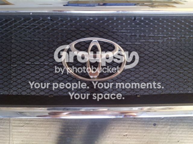

now to get the mesh i kindly asked my nieboughr if i can borrow some of his mesh he was using to hold on the concrete to the side of his house since he has been renovating and extra mesh left over
IMG-20120817-00425.jpg~original

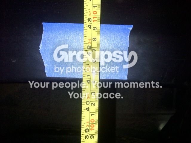

the measurements i used for the grill was 6 1/2 x 33 1/2 i gave myself a little extra just in case i just used the tin snips on this part
IMG-20120817-00426.jpg~original
IMG-20120817-00427.jpg~original
IMG-20120817-00428.jpg~original
now remember how i explained how i did not cut the 2 corners off to mount the grill in place the mesh will interfere with it so i just cut out a simple hole so it will wont get in the way
IMG-20120817-00429.jpg~original
this next step will be a little tricky i lined up the grill and marked where the best place to drill for the zip ties to hold the mesh to the grill,i drilled 6 holes on the upper side and 6 holes on the lower side, as you can see i drilled to the lowest point on the diamond style grill so the zip ties are not noticeable. after that all i did was paint it black.
IMG-20120817-00431.jpg~original
i zip tied it down made sure that i was happy and everything sat well the with the extra mesh you can cut it off or bend it like how i did so its not in the way
IMG-20120817-00432.jpg~original
and BAM you can stop at this step and have a clean style grill or you can keep going on and do your own touch the lower picture shows why you cant use the 99+ grill style in the 4Runner as the middle of the chrome had to be cut and with it cut would not look as clean as it should so thats why you should use the 96-98 grill where the chrome dose not exist in the middle
IMG-20120817-00433.jpg~original
IMG-20120817-00434.jpg~original
here is a shot of the grill on my truck before and after
IMG-20120817-00435.jpg~original
IMG-20120817-00436.jpg~original

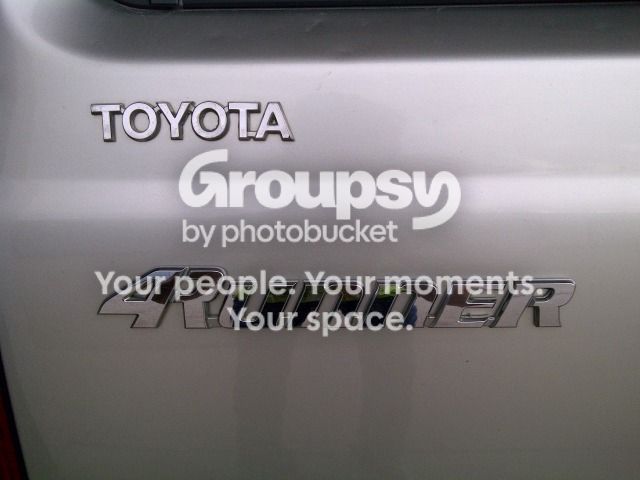

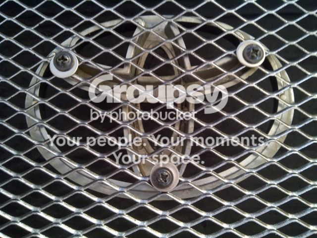

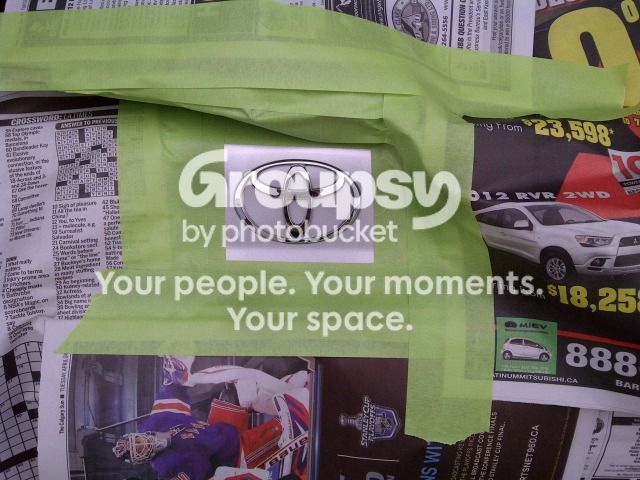

for me it was to plain so so i took off the old Toyota logo and screwed it to the new grill
IMG-20120817-00441.jpg~original
IMG-20120817-00440.jpg~original
IMG-20120817-00444.jpg~original

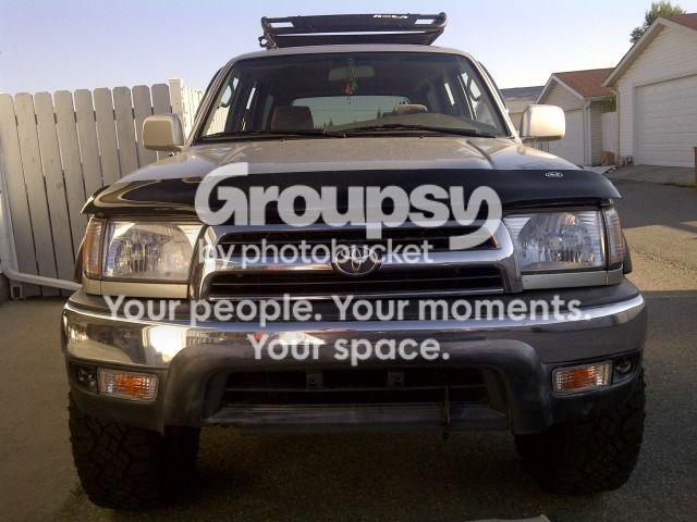

finished product i know i pushed the grill as far back as i could so that the light force light wont interfere with the grill and have to cut the grill so thats why the mesh is further back let me know if i missed something or chime in guys or what you guys have done differently?

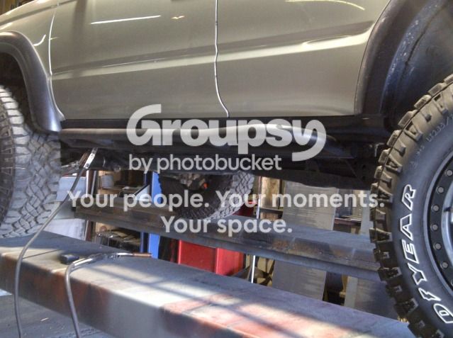

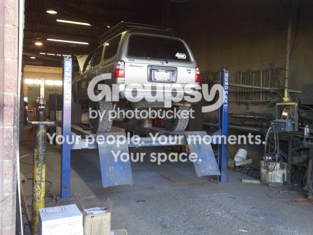

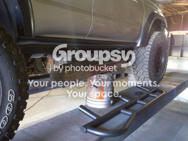

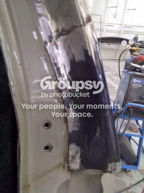

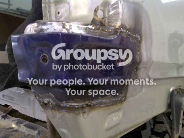

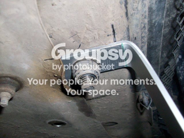

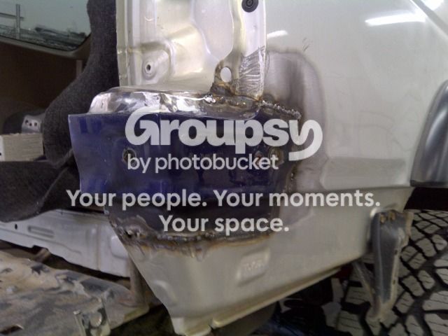

oh and almost forgot got my sliders welded to the frame
at the welding shop
IMG-20120817-00420.jpg~original
IMG-20120817-00421.jpg~original
IMG-20120817-00422.jpg~original

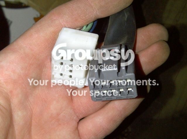

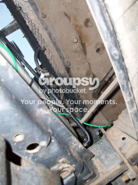

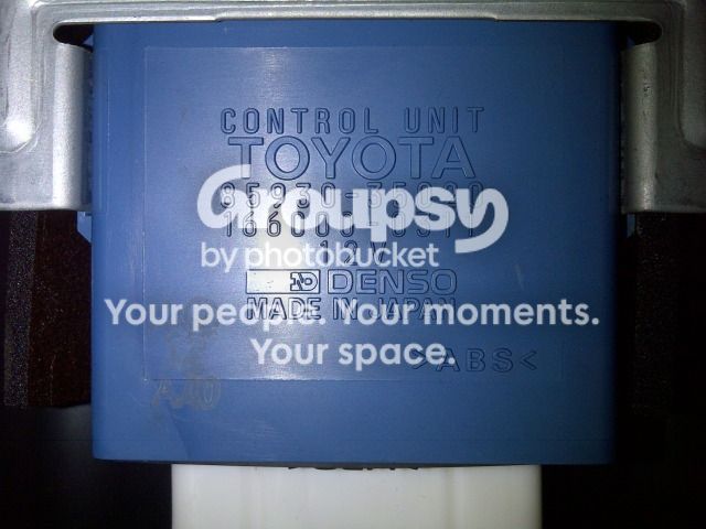

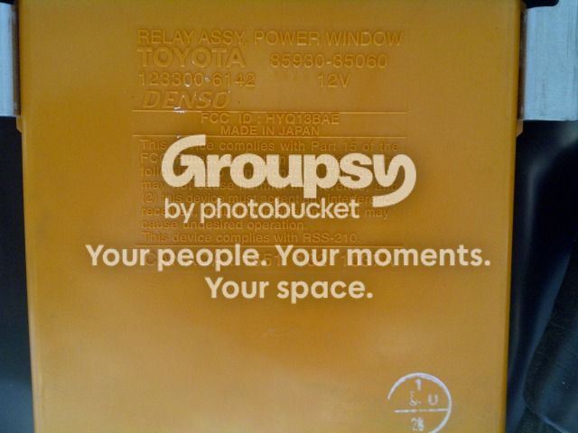

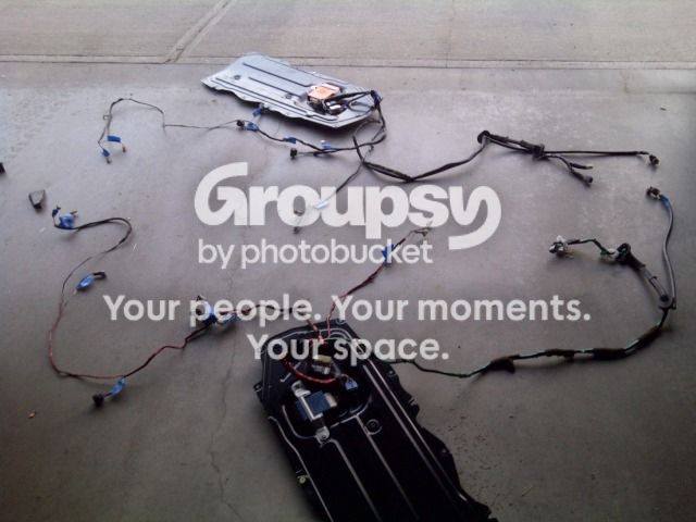

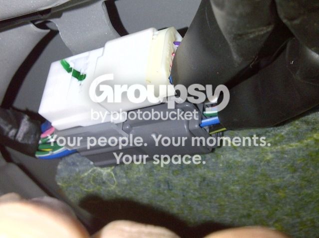

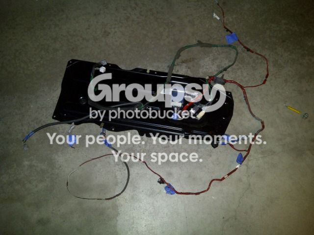

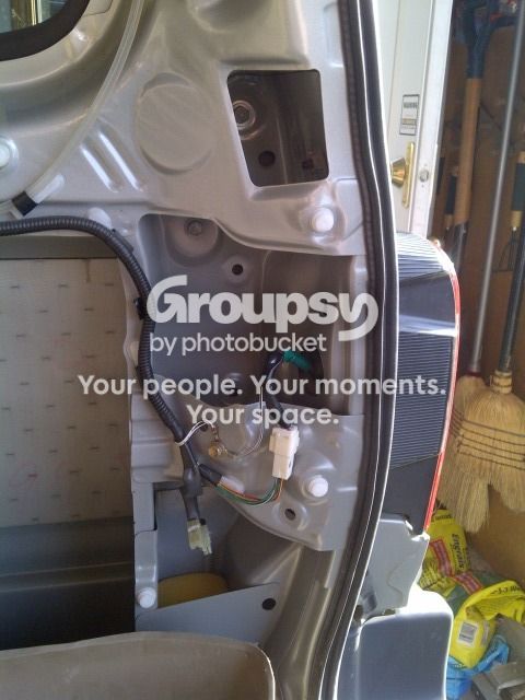

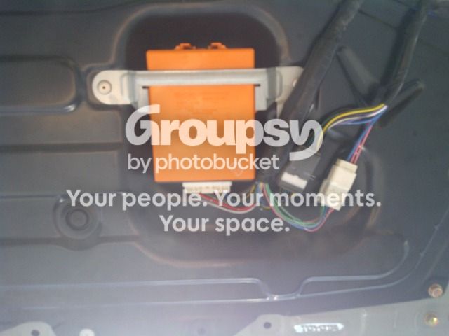

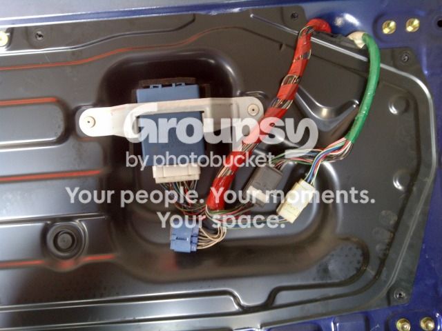

just to let everyone know the wireing for a 96-98 is diffrent then a 99 -02
IMG-20120926-00526-1.jpg~original
IMG-20120929-00529.jpg~original

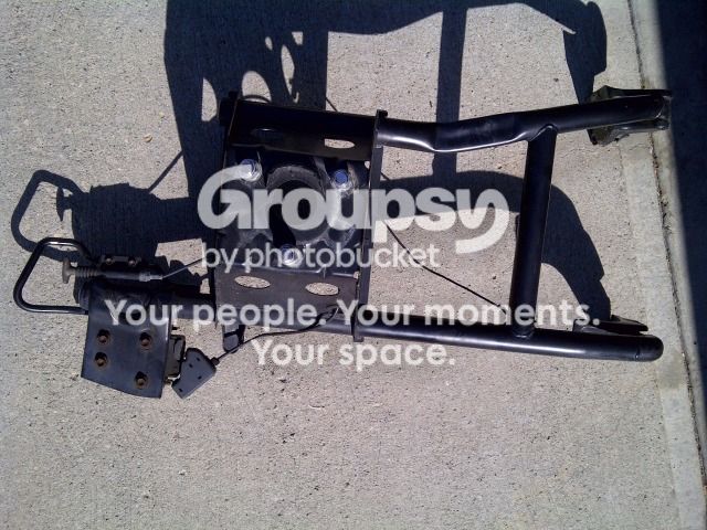

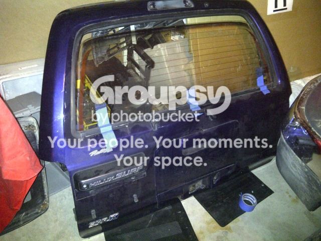

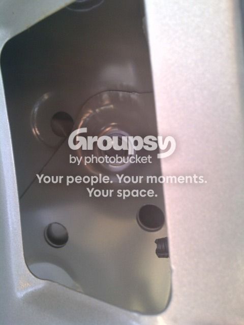

Alright so starting from here is the transformation of the 4RUNNER to the 4SURF (Hilux Tire Carrier) So i bought the hatch from Rocky Mountain Imports from Vancouver and they shipped it within a week which i give them A++ for that great guys to keep in contact with they dont BS with you they mean business (Cam & Jon) aswell they totally cut the quarter pannel so i can have the reinforcment for it here are some shots of the hatch. SORRY about the poor pics it was getting dark and phone was dieng so no flash!!
IMG-20120924-00519.jpg~original
IMG-20120924-00521.jpg~original
so i noticed that the plugs are diffrentand i suckl at cutting and rewireing so i decided to just swap out the whole harnesses
IMG-20120916-00499_zps00266358.jpg~original
IMG-20120916-00497_zps75291133.jpg~original
IMG-20120924-00520.jpg~original
IMG-20120922-00512.jpg~original
IMG-20120922-00513.jpg~original
^^HILUX^^
IMG-20120922-00514.jpg~original
IMG-20120922-00515-2.jpg~original
^^ 4RUNNER^^
One wire harness is out time to pull out the runner one and swap

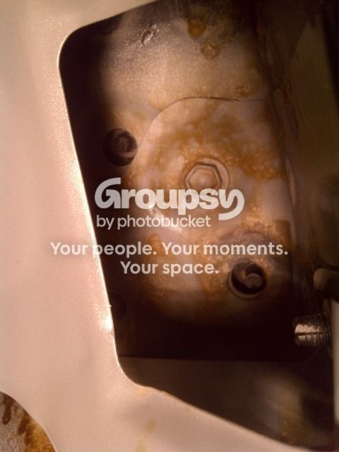

now here is some picture the difference between the re-enforced quarter and the regular 4 runner one the first 2 are the 4 runner then the last one is the surf quarter
IMG-20120922-00508.jpg~original
IMG-20120922-00510.jpg~original
^^4RUNNER^^
IMG-20120922-00511.jpg~original
^^HILUX^^
IMG-20120916-00496_zpsa7833410.jpg~original

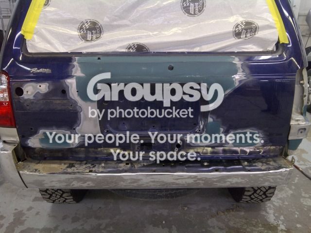

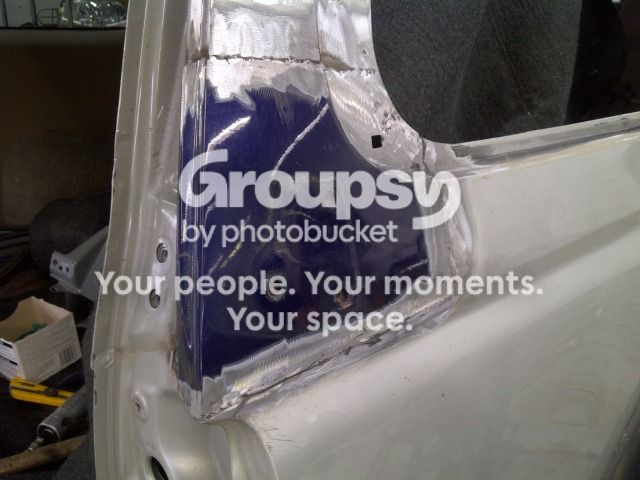

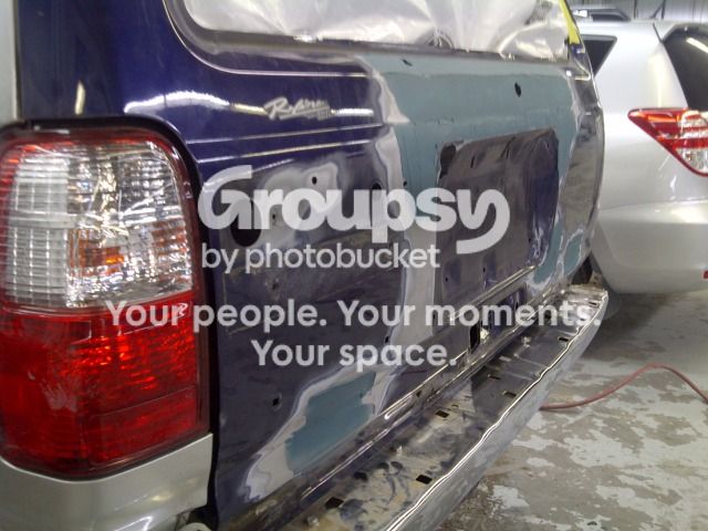

alright sorry i did not get any pictures of when it was all cut out but here it is welded in
IMG-20121009-00540.jpg~original
IMG-20121009-00539.jpg~original
IMG-20121009-00538.jpg~original
IMG-20121009-00537.jpg~original
IMG-20121009-00536.jpg~original
now its time to weld in the re-enforcement behind
IMG-20121011-00545.jpg~original
IMG-20121011-00546.jpg~original
IMG-20121011-00547.jpg~original

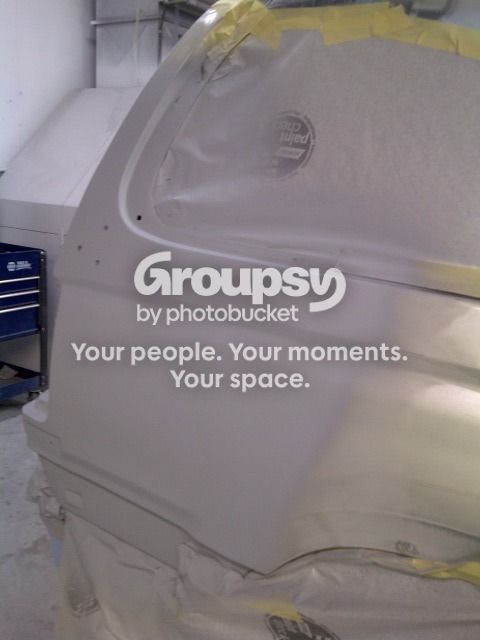

All primered and ready for the paint!!
IMG-20121017-00572.jpg~original
IMG-20121017-00571.jpg~original
IMG-20121017-00570.jpg~original
The finished product all painted and looks like a true hilux surf looks as it came OEM im super please with the out come and now it is one of a kind Toyota!! Any questions feel free to ask away i have nothing to hide!!
IMG-20121020-00586.jpg~original
IMG-20121020-00580.jpg~original
IMG-20121020-00583.jpg~original
IMG-20121020-00584.jpg~original
IMG-20121020-00585.jpg~original

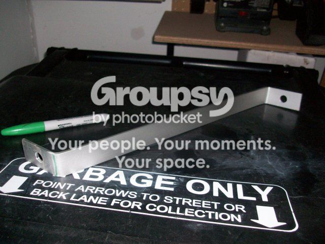

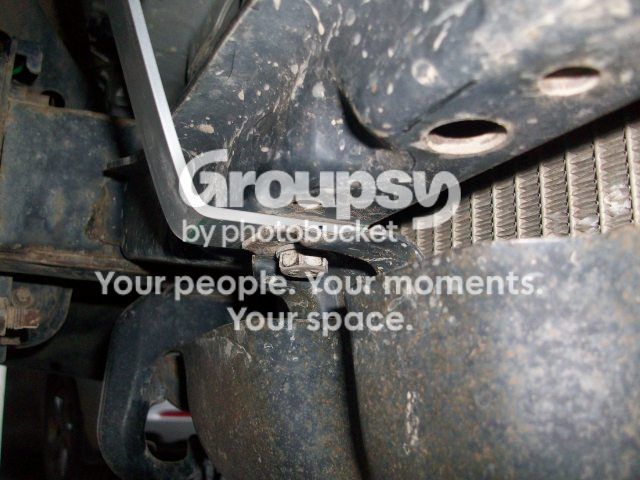

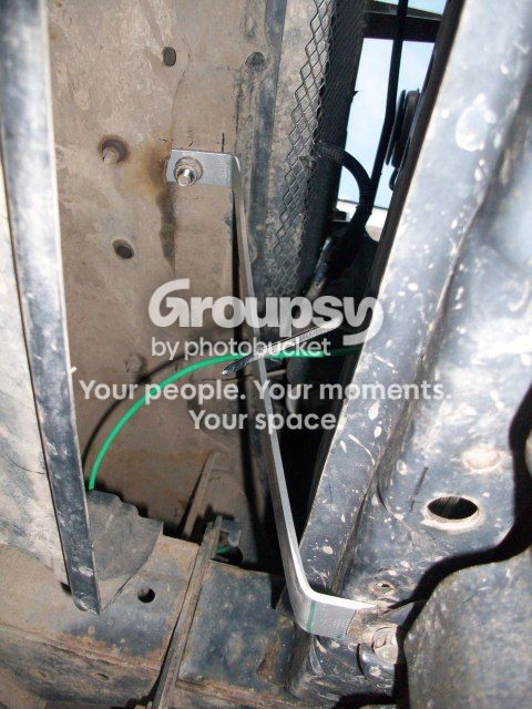

alright so since the OEM bumper is a tin can bumper and the have the large 240 blitz light force mounted i decide to just and some ridged struts underneath to hopefully strength the bumper so the lights dont flicker/rattle i bent the rod to the right length and drilled the holes
lightforcerenforcement008.jpg~original
lightforcerenforcement010.jpg~original
lightforcerenforcement007.jpg~original
lightforcerenforcement004.jpg~original
from before and after!!
lightforcerenforcement002.jpg~original
lightforcerenforcement001.jpg~original
