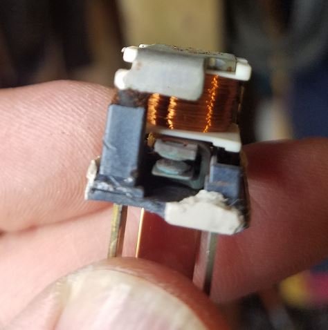

I replaced my clutch relay with a $6 one from Rockauto. No more blinking light. I also replaced the one for the heater circuit for the upstream o2 sensors as both sensors were burnt out when I got the truck. Same model relay so I'm thinking it stuck on at some point. Broke open the clutch relay and it looks like the one earlier in this thread. May need to look at the diode dealio listed in this thread.
