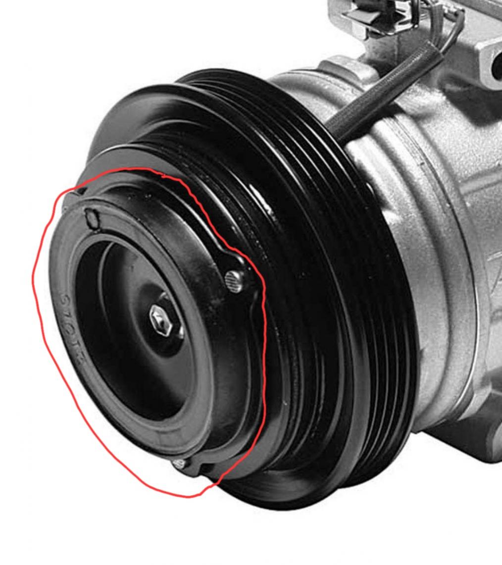

Also, check to see if they pulled the fuse. If they did, DO NOT put a fuse in until you check to make sure the compressor isn't seized. You can turn the clutch by hand, engine off (very front of the compressor, circled in red). If it rotates, usually a little resistance, it should be good and you can put the fuse in, of course if that's what they did.

Fuse was the first thing I replaced. I’ll try turning the compressor by hand tomorrow. What happens if is seized and it runs? Trash the compressor?

If the compressor is seized and the clutch engages, either the belt will snap or the pulley/clutch will snap off the compressor, which can do nasty damage.

Tried out the compressor clutch today and it turns pretty easily.
