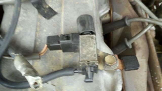

First, I have attached a photo of a sensor that sits on top of the valve cover. One of the vacuum line attachments is broken off and I would like to replace it. However, I don't know what the name of the sensor is. Can you tell me the name of it?

The sensor in your picture is the A/C idle up VSV (vacuum switching valve). Basically, when you turn your ac on the VSV will make your truck idle 100 rpm higher at an idle.
