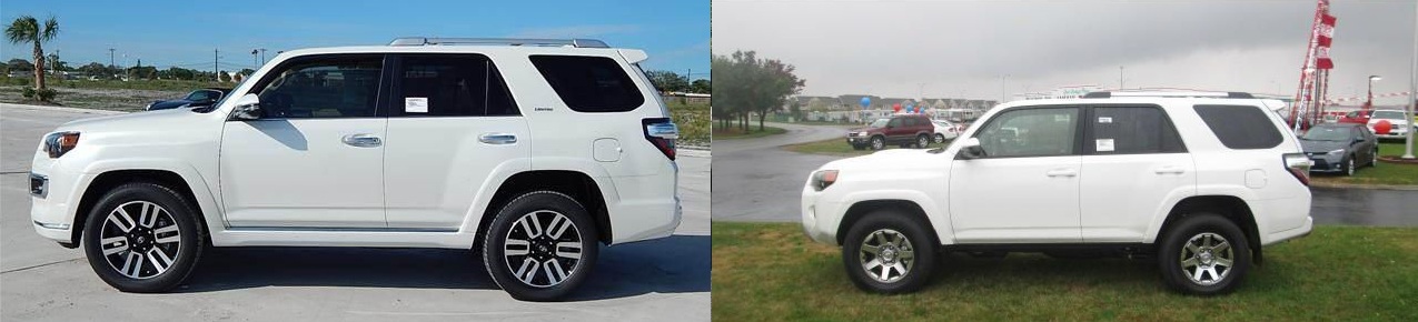

the problem is as stated in a previous comment i think, the LE have a lower side skirt that the TE/SR5 do not have.
you can see it in this pick i cobbled up quickly.

it might be possible to fit a trail RB to a limited by asking a local welding shop to modify the brackets so it will fit into the limited -just an idea to explore.-what one would call an RB mod :)

I'm trying to fit running boards that are an option for 2014 SR5's & TE's onto my brand-new SR5. I don't see what the LE has to do with it? Or did you think I had an LE?
not sure, but i think nodak was posting in reply to the thread starter(philsey) who was thinking about buying a limited.... so looks like we have limited and sr5 people who are interested in the trailer running boards. I emailed toyota USA waiting for reply...anyways, i feel in the end we will get our answer...by 2014 at least :) The main reason i want to get these RBs soon is to help protect my 4runner doors against scratches/dings when parked in the parking lot against adjacent parked car owners who fling their doors open.

If the brackets wrap around the frame, then the XReas line may be a challengeddepending on if the bracket can slide between the line and the frame.
Similarly, if it uses sticknuts, you may not have access to a hole in the frame to feed the sticknut. This is all based on my experience with shrockworks sliders and skids on my 2010 Limited.
Also, as mentioned, the rocker panels on the limited come lower than on the TE and SR5.
