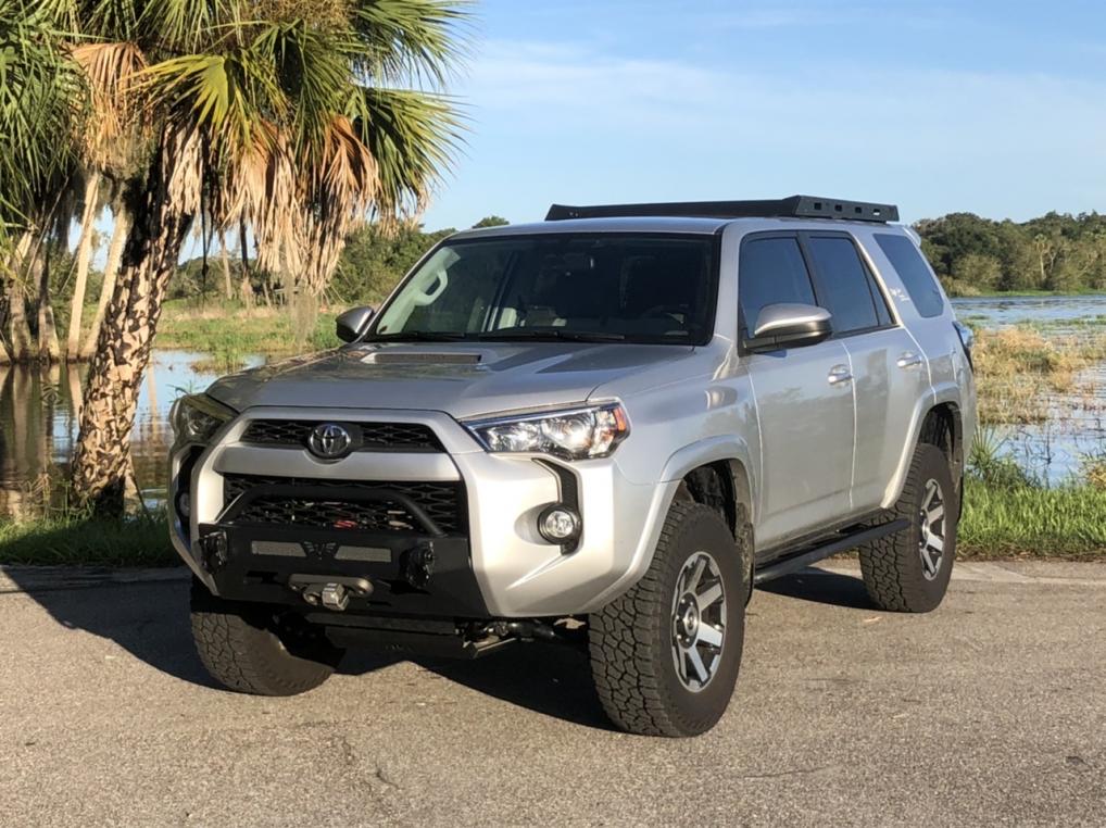

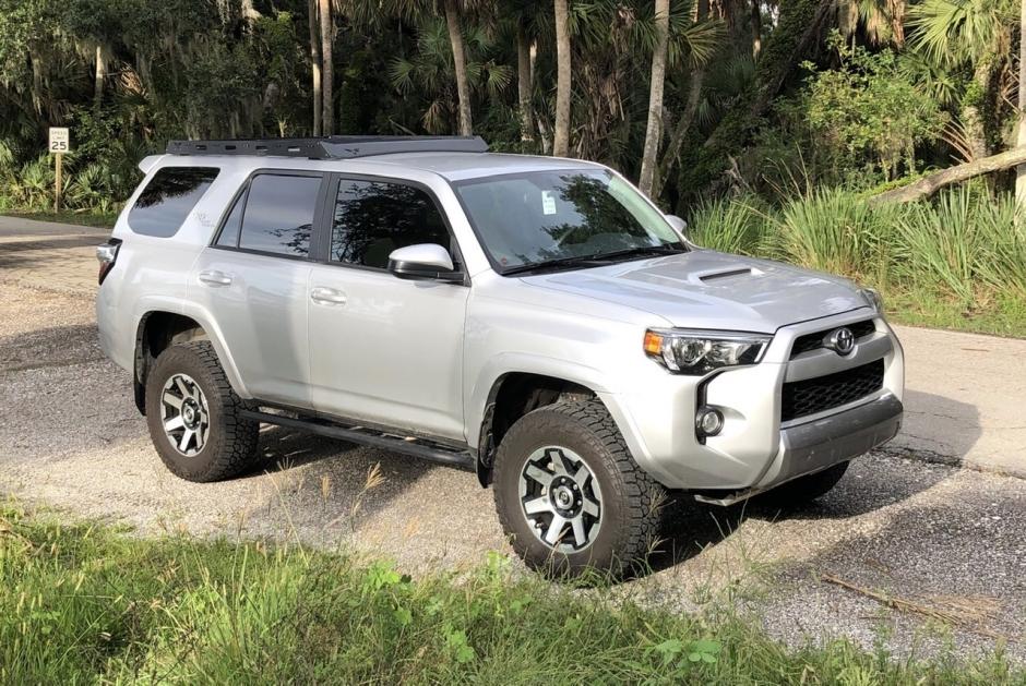

I have Eibach Pro truck 1" rear springs and this is how it looks. Front is lifted about 2-2.25" over stock.
Definitely not necessary to do a diff drop at that height. Once you get to 2-2.5 I would recommend doing though, a lot of people do a 2.5/1.5 and still don't run so you are all good.
I'm at 2-2.25" over stock in the front. CV angles look straight. Did not install a diff drop.

Here’s what my 2.25” lift looks like with factory 265 size Falken Wildpeak AT3W tires.
Thanks for the picture, that's exactly the setup I was going to try out to replace my 6112/5160s. It looks perfect. What spring rate Kings do you have? I was probably going to stick with the 550# and I am curious how that will pair with the slightly firmer than stock 1" Eibach rear. How many threads of preload did you do in the front?
Hi there. I got same setup on mine. And I like the way it works, front and rear,and level perfect
I’m using the 550 springs. I don’t remember how many threads are showing but pre and post measurements (Center of hub to fender) was 2-2.25” difference. I’m out of town but will count threads when I’m back.
550 springs are fine. I may get 600 to stiffen the front just a tad.
I’ve got 650 Lb springs and 0 preload . Just like you said I wanted stiffer a tad. But it drives sooo... smooth with stock weigh I figure leave like this . And it gave me ~ 3” of lift
