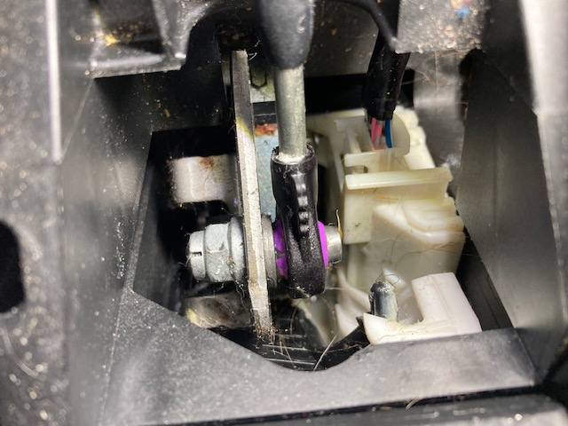

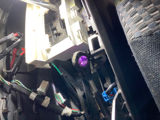

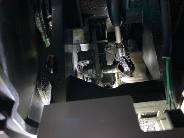

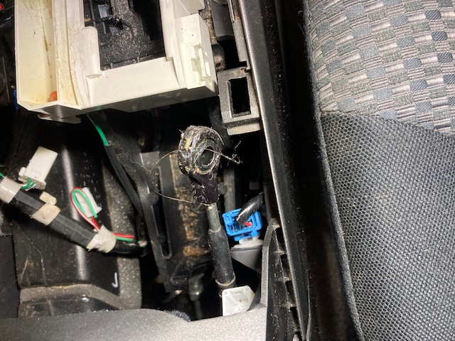

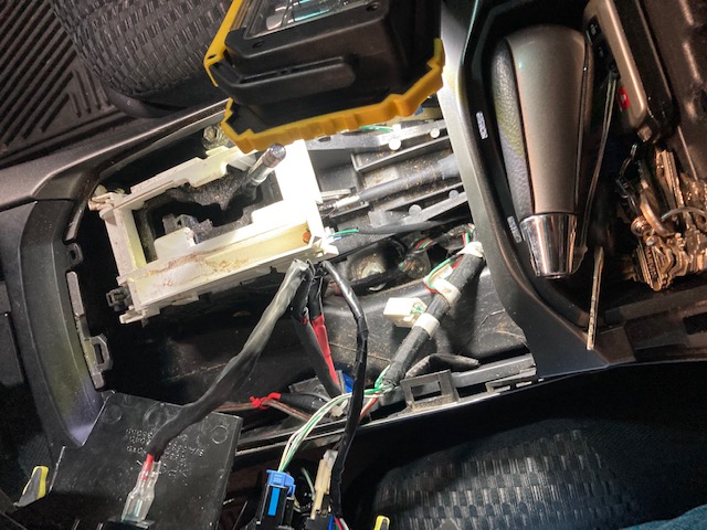

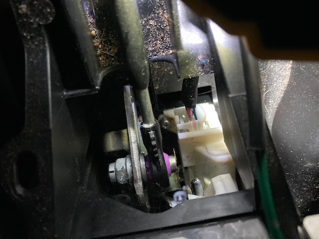

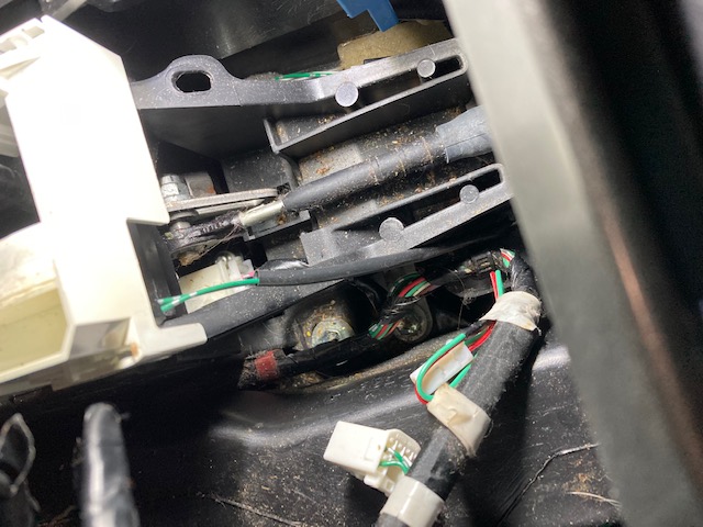

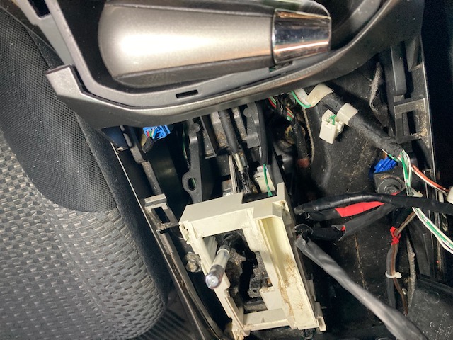

I just received and installed the bushing. It was very easy. The old bushing was still compliant, I will keep it just in case.
Alternate method (no need to remove whole assembly):
1) remove the shifter surround by lifting straight up
2) unscrew the shift knob
3) move the shifter to a mid point like N
4) with a small flat screwdriver, gently release the lock tabs at all 4 corners
5) lift and remove shifter Bezel.
6) move shifter to 2nd gear position
7) look at the rear most end of shifter assembly, and you can see the shifter cable and bushing
8) follow the shifter cable back 3” and see a flat spring clip holding the cable in the mount
9) with pliers, pull up the clip and remove. Push cable backward and lift from mount
10) slide shifter bushing/cable off the selector post, lift the cable to access the bushing.
11) remove bushing, install new bushing, lubricate, re-install on selector
12) reverse process to finish.
13) note: Be careful not to lose the shift lock release button when installing the bezel
=> take pics along the way to help with reassembly
Time involved, 20 minutes including dropping and retreiving the shift lock release button from under the shifter. LOL

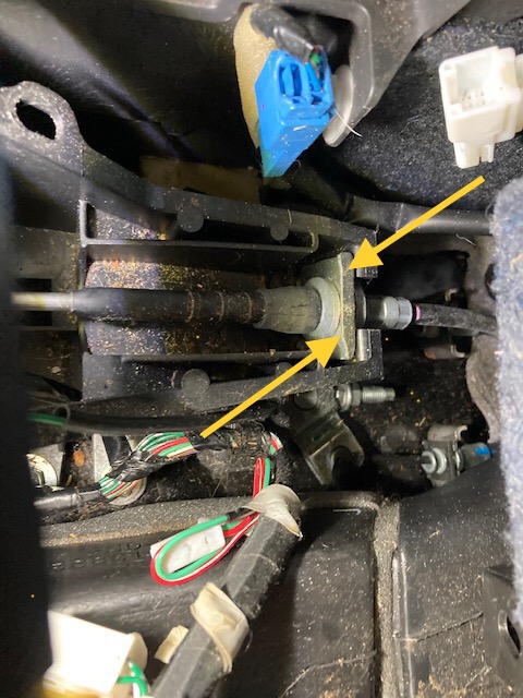

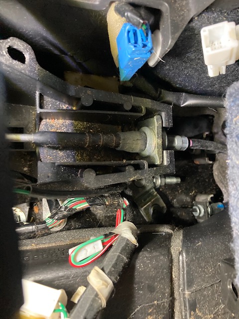

More pics. Flat spring clip at yellow arrows

You posted instructions about 2 hours after I finished xD Should have procrastinated.
Side note, I could not get the flat piece out to save my life. Not having any instructions to show me otherwise I ended up disassembling more of the shifter.
These instructions are way better lol.
Its a tight fit. With pliers, you will need to pull straight up and rock it side to side to get it out. Or find a way to pry it up. The tap with a hammer to reinstall it.

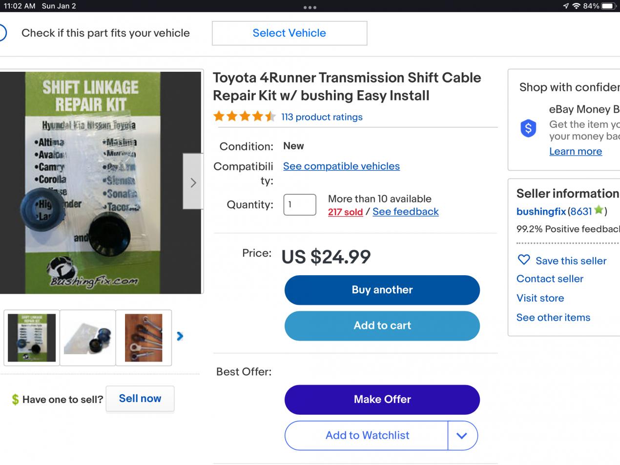

I bought mine from ebay after offering $20. Probably still $15 over priced but its a one time purchase
Seller. Bushingfix
