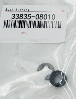

Did you install the little clip, too? I bought the bushing, haven't installed it yet, then later saw photos of it being sold with a clip and now my OCD's getting the better of me.
I bought that Toyota bushing to fix mine, I haven't installed it yet either, I did the Ziptie and it works fine for now, not sure when if ever I will install the bushing, but the bushing I bought from my local Toyota dealer didn't come with the E clip, I did however buy an aftermarket E clip for when or if I ever install the bushing, I'm not even sure if there's a groove for the E clip to be installed into.
I never got nor used a clip, seems to be working good so far. Feels smoother shifting, the other one was like you could feel that softer crap rubber. Has only been a month though.
