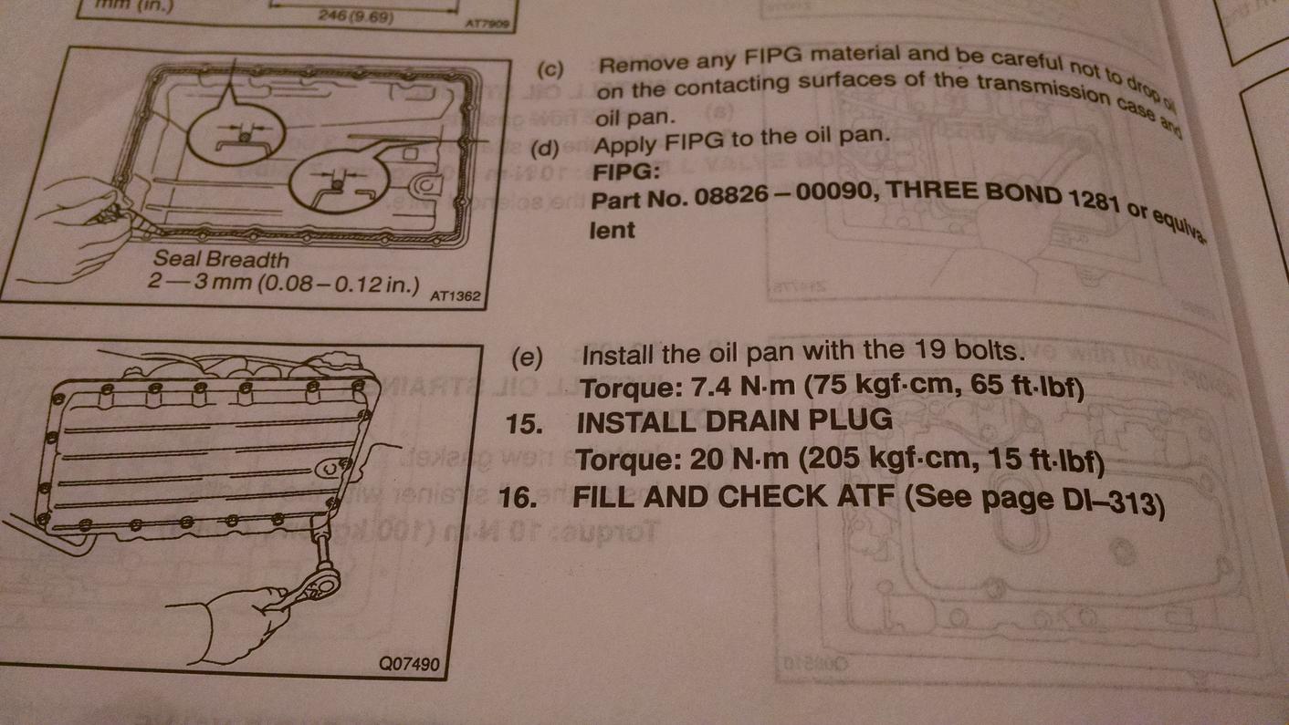

Hey Dudes and Dudettes,
As I've used my FSM over the last couple years, I've noticed discrepancies, mainly with torque specs. One page describing how to take something apart or put back together will show a bolt or nut with one torque spec and then you go to the master schematic page of the area of the truck you're working on and you'll see a totally different torque spec for the same bolt or nut.
This morning I was doing some research regarding dropping the transmission oil pan and I saw a torque spec for the transmission pan bolts that didn't make any sense. Since I know the bolts for the pan are fairly small, the 65 ft-lbf spec for these bolts seemed seriously excessive. I looked up conversions for the Newton-Meter and Kilogram Force-Centimeter values and they both converted to 65 in-lbf. 65 in-lbf is equal to 5.4 ft-lbf. The difference between 65 ft-lbf and 5.4 ft-lbf is pretty huge.
The point of this is you have to use your head and not blindly follow the FSM. If someone followed that spec, and they gradually tightened the bolts in a crossing pattern, they would have eventually snapped one off in the transmission and found themselves removing the pan, dealing with getting the broken bolt out and probably buying all new bolts because they were all over-torqued.
The FSM is still an invaluable resource for us DIY mechanics but you just have to be a little careful and question things when they don't seem to jive.

Another reason is that it sometimes makes jobs more complicated:
My wife's Rogue needed a blower motor. The FSM said I had to pull the whole HVAC assembly out through the engine compartment (and drain the coolant and refrigerant) to access it. But one peak under the dash revealed that there was a nice big cylindrical space SPECIFICALLY DESIGNED INTO the dash subframe to allow removal of the blower motor from inside the car. Ignoring the FSM saved me 5+ hours of labor and an AC recharge.
I just replaced the water pump on my Focus. The FSM says to drop the motor for access. But all that was needed was to pop off the crank pulley, which takes about 30 seconds. Again saved me hours.
I always wonder if they write it this way to pad billable hours for the shop, and all the mechanics use these tricks to majorly boost their pay.

Auto manufacturers are huge bureacratic organizations. Manuals are written and checked by teams of engineers, but sometimes small details get missed. I wouldn't be surprised if it was one person's job (summer student? Lol) to go through an entire FSM and calculate torque specs for every bolt.
Without readily accessible TSBs outside of the dealership, there's almost no way for the typical hobbyist to get updates to the FSM as parts get supersceded or typos get caught.
I know of two places where the FSM is wrong: rear axle retainer positioning and the torque spec for the lower ball joint bolts.

I can't speak for Toyota, but with Infiniti, I can say that probably 90% of jobs can be done easier/quicker than what the FSM states by simply following common sense. I really only use our FSM's for torque specs. Other than that, they're kinda dumb.
