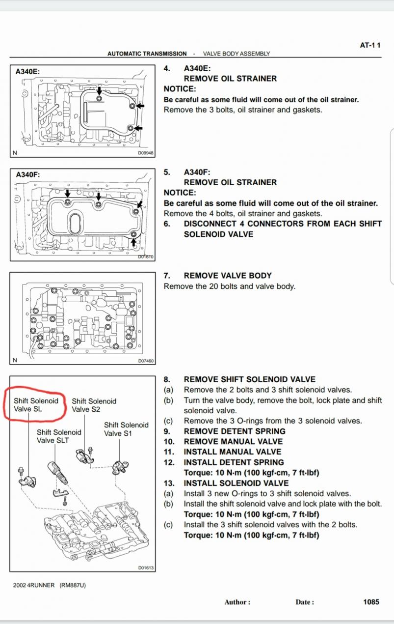

For the most part yes but I'm actually wanting to test the solenoids following the fsm steps first. I started draining my atf last night & will remove the pan tomorrow to expose the solenoids. Only problem is I have no idea which of the 3 solenoids is the "shift solenoid valve SL" or "shift solenoid E". I've been flipping through my fsm & trying to google the location of that solenoid since last night but haven't had any luck. If I still don't know which solenoid I'm supposed to test I'm just going to order all 3 & hope it works.

SL = TCC =#3= Bigger expensive one, should be closer to front of vehicle.
The other two are similar (maybe bolt tab differs) and are the Shift 1/2.
Not positive what the (E) means to Toyota, but you need to look at the TCC solenoid.

Found the solenoid valve SL

AFAIK
Just saw your post after finding it in the fsm. Thanks for the help.

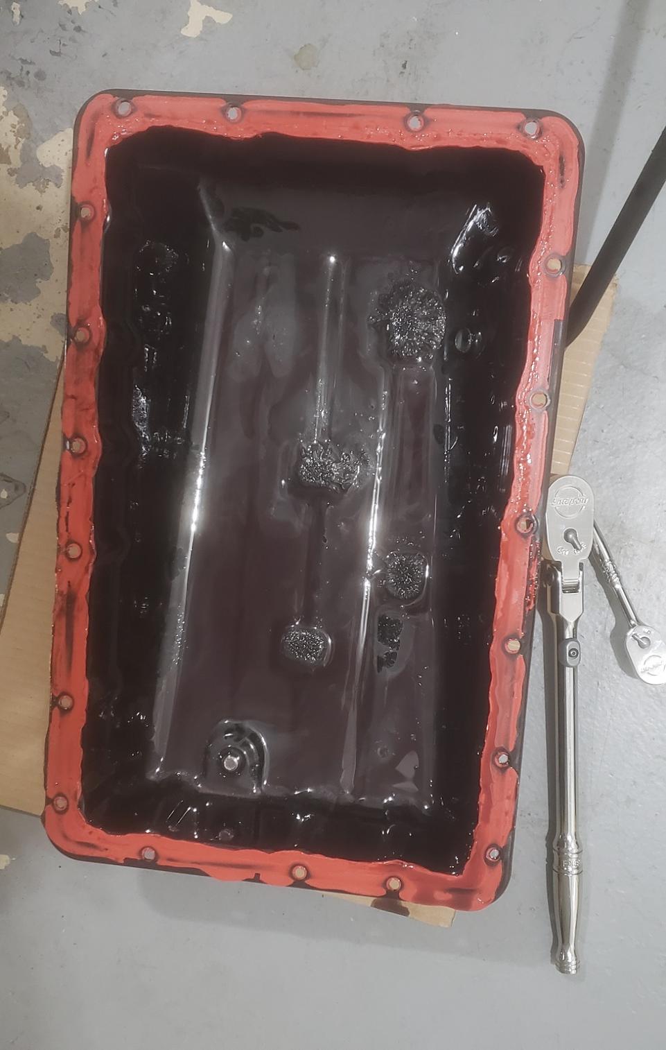

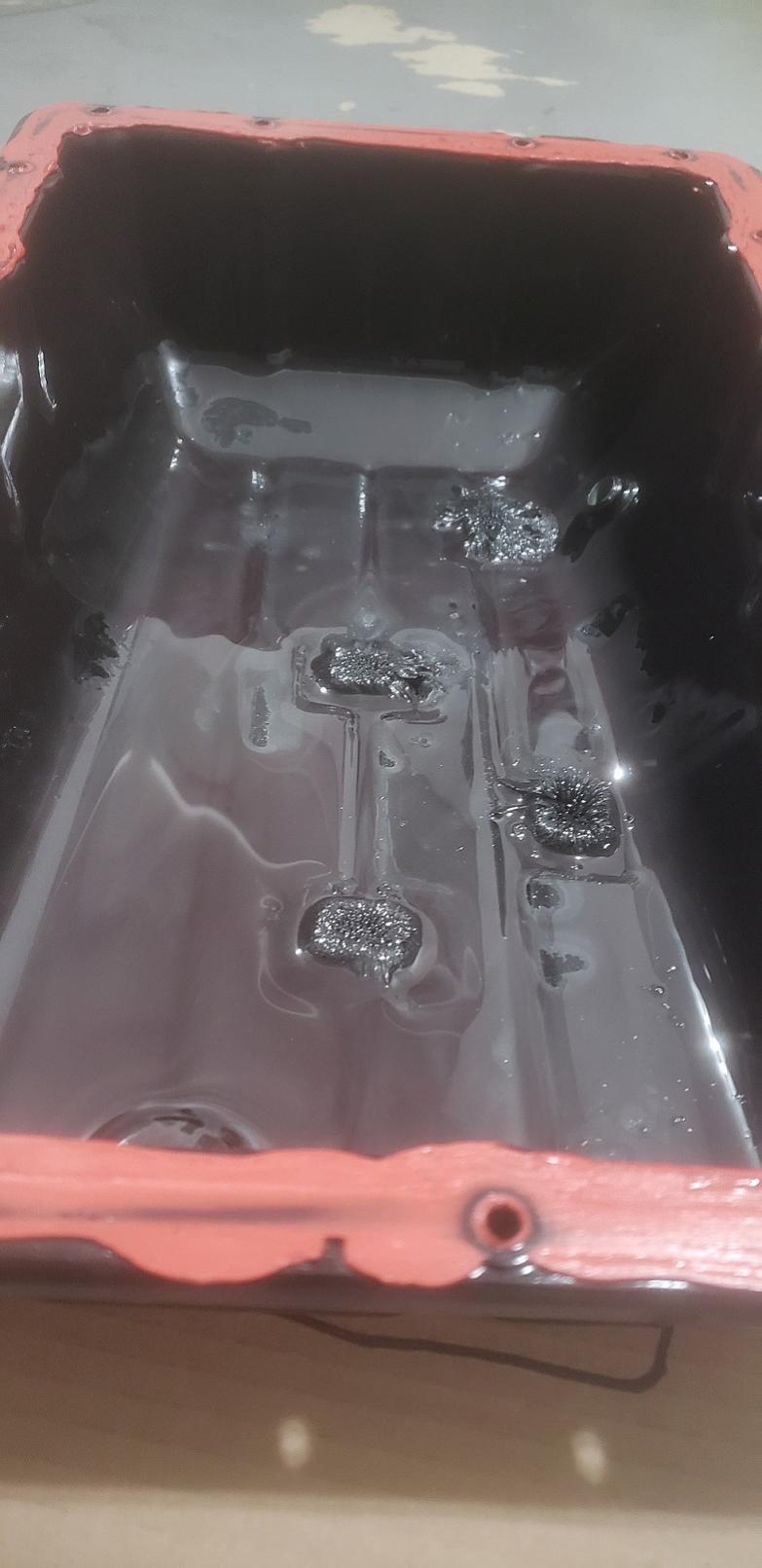

I don't know what your background is but you called it. Just dropped my pan and saw some good size metal shavings on my magnets. Ironic thing is when I checked my fluid a couple weeks ago it was bright red, was probably to early for the shavings to turn the fluid black. I guess this means my transmission has reached its end. Time to start shopping for a new one. I appreciate the help & I didn't take your comments in that way. In another thread I was actually asking if the symptoms I was experiencing were indications that my transmission was compromised.

How big are those shavings??
That looks like larger chunks on those magnets and not super fine paste metal.
I say your TC is damaged and possibly your transmission as well
Any TC noise is mostly TC damage.
