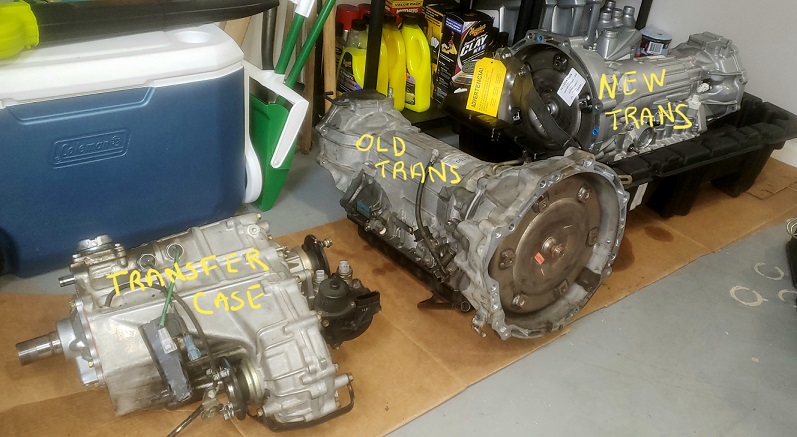

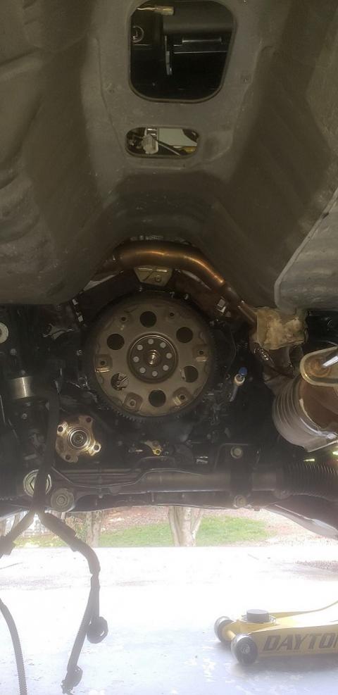

Dropped my transmission on Friday. Took a full day but that also included rebuilding my starter, tire rotation, draining fluids, beer breaks, grilling, etc. My brother in law helped provide an extra set of eyes & hands to guide the transfer case & transmission out. Some minor hang ups were separating the transfer case from the transmission. Once I saw a little separation between the 2, by lifting/lowering the trans jack and wiggling the transfer case side to side, I was able to get a flat head screwdriver in & gently pry them apart. Disconnecting all the electrical connections was the most time consuming and tedious part. The only casualty was breaking the plastic tab on the park neutral position switch connector housing when I was trying to unplug it. The plastic housing can be replaced from Toyota, EDIT 90980-11784. Other issue was trying to figure out how to remove the park neutral switch from the transmission. Still not sure how to remove it. Picked up the new transmission the next day, Saturday. Was going to install it but decided to clean things up, remove some corrosion where the crossmember connects to the frame & do a little painting while everything was out. Will put the new trans in this weekend. I decided to roll the dice and not replace the rear main seal or flexplate.

Dropped my transmission on Friday. Took a full day but that also included rebuilding my starter, tire rotation, draining fluids, beer breaks, grilling, etc. My brother in law helped provide an extra set of eyes & hands to guide the transfer case & transmission out. Some minor hang ups were separating the transfer case from the transmission. Once I saw a little separation between the 2, by lifting/lowering the trans jack and wiggling the transfer case side to side, I was able to get a flat head screwdriver in & gently pry them apart. Disconnecting all the electrical connections was the most time consuming and tedious part. The only casualty was breaking the plastic tab on the park neutral position switch connector housing when I was trying to unplug it. The plastic housing can be replaced from Toyota, 90980-11332. Other issue was trying to figure out how to remove the park neutral switch from the transmission. Still not sure how to remove it. Picked up the new transmission the next day, Saturday. Was going to install it but decided to clean things up, remove some corrosion where the crossmember connects to the frame & do a little painting while everything was out. Will put the new trans in this weekend. I decided to roll the dice and not replace the rear main seal or flexplate.
Looks like you made some great progress! I'm glad you were able to figure out another connector. As far as the park/neutral switch you might try prying on both sides with two pry bars after spraying the shaft with some penetrating oil of your choice.
Where did you end up getting the new transmission from? Any plans for the old trans? I'm guessing you'll have to return it for a core.
Will try using pry bars on the park neutral switch. It's very possible I wasn't pulling on it with enough force. After breaking the connector housing I didn't want to risk breaking anything else. It was a relief to find out the connector housings are available. Just ordered one last night. Hopefully removing the wire terminals from the old connector won't be too much of a struggle.

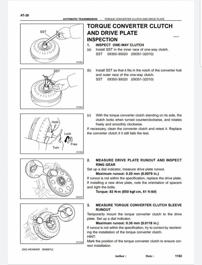

Got the transmission from a local parts dealer for $2500 after the core. I still have my old one sitting in my garage but will be returning it once I get the new one installed for $. If I have time I'm wanting to pull the torque converter out to confirm if that was the issue. I've briefly looked at the FSM steps but still not quite sure what all I'm supposed to do for testing the runout. Testing the clockwise free spin and counterclockwise lock seems pretty straight forward. Any suggestions on what I can use in place of the SST?
If I'm understanding the test procedure correctly, then I would think you can use a thick ruler or maybe a metal carpenter's square to fit in the two notches to turn it. Or maybe a piece of flat stock? The test procedure looks to me like it wants you to turn the transmission side of the torque converter while you hold the flywheel portion still. You might have to mount the torque converter back to the flywheel to hold it still. I've never had to test one that way so this is all just conjecture on my part.
I see what you mean about the notches. Creative thinking with the carpenter's square, I've got a couple of those. I'll definitely be able to test step one but don't have a dial indicator or have any experience with one to test runout. Your explanation of turning the transmission side of the torque converter while mounted and the flexplate makes sense though.

I spent about 15 minutes trying to test my original torque converter following the FSM steps but think I was doing something wrong because I wasn't able to get the torque converter to do the things the FSM indicated.
