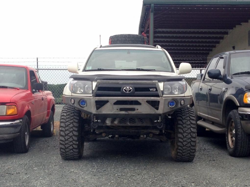

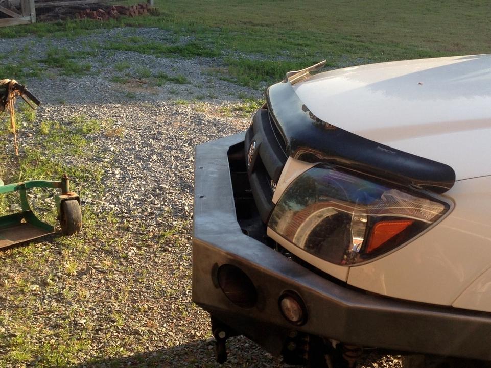

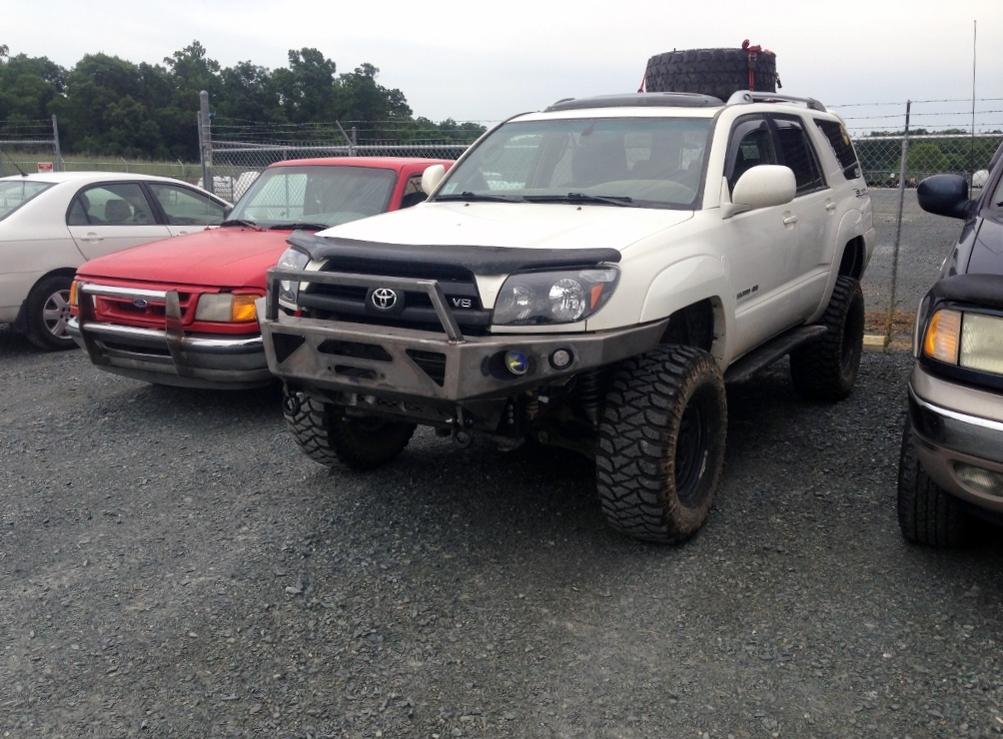

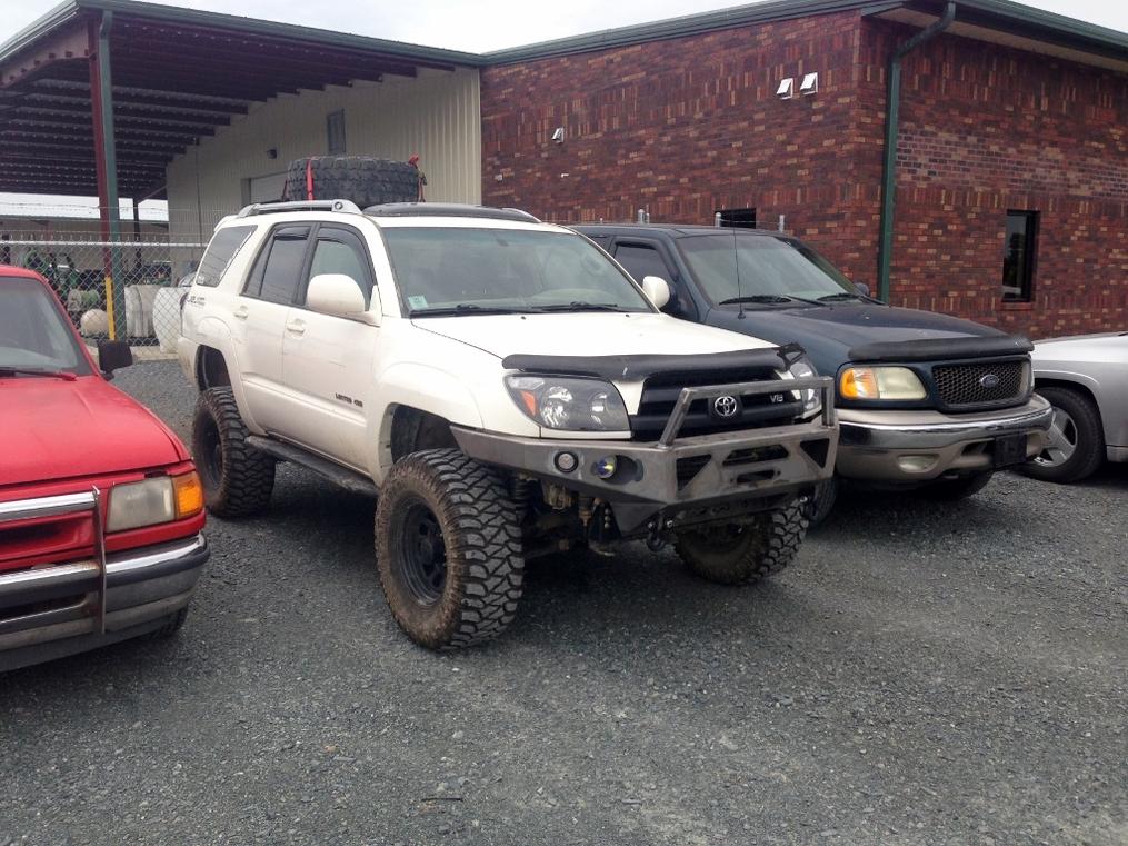

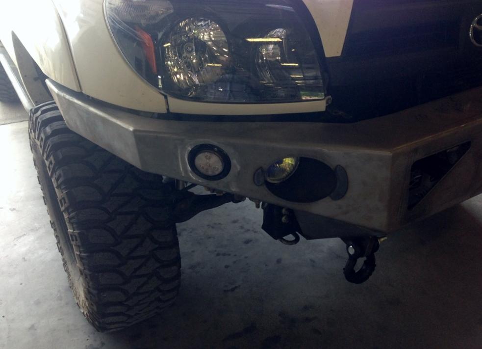

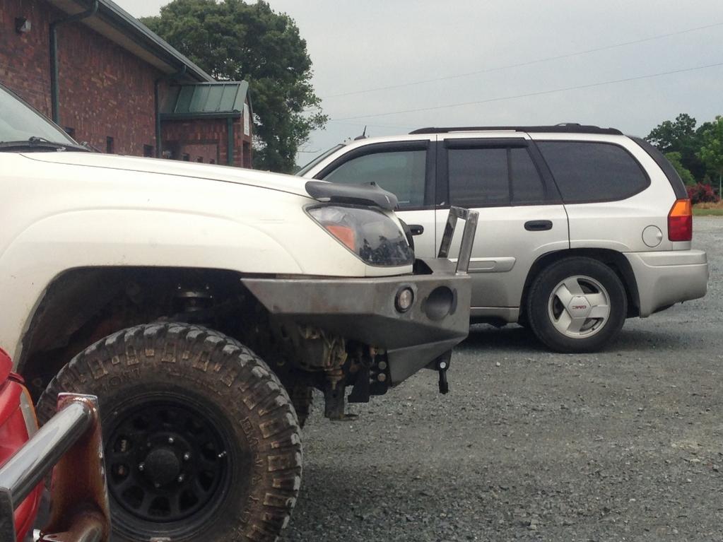

Thanks man! yeah I'm really happy with it. Here is one side shot I got of it to show the gaps. (note that an 06 style grill or newer will fill in the gap better)

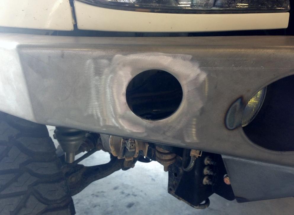

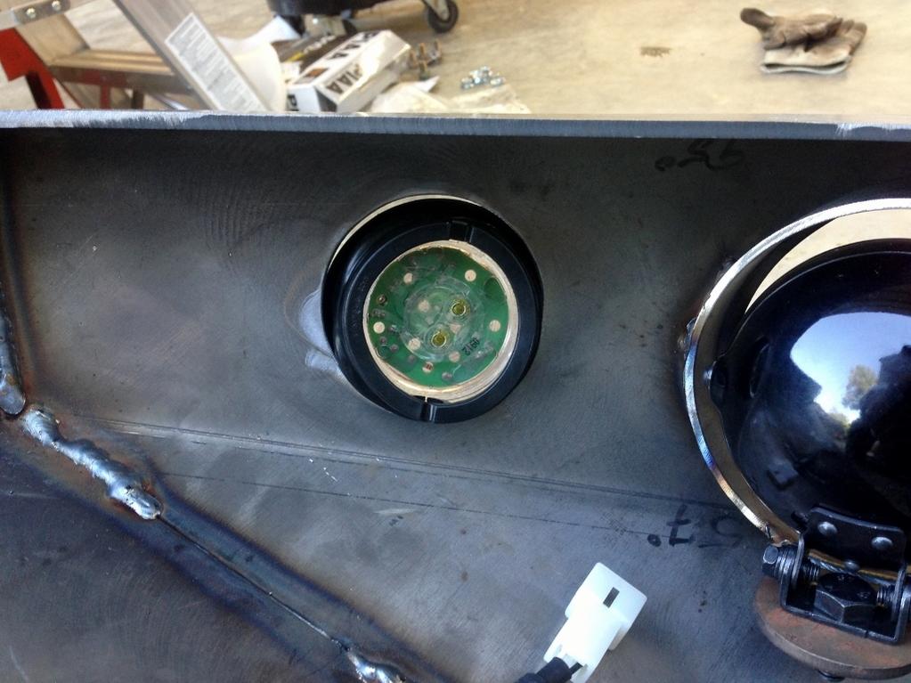

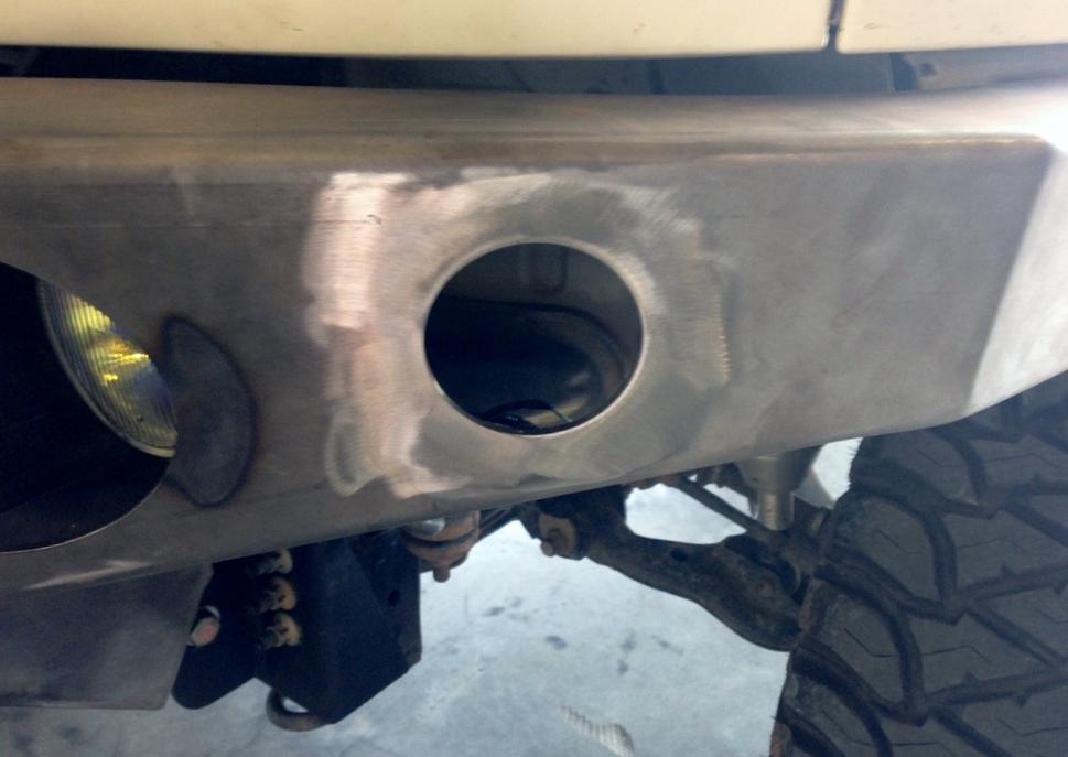

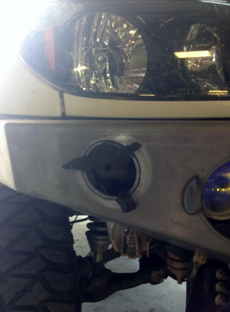

Also just to keep the thread updated. The standard turn signal size they use for the 03-05 bumpers is a 2 inch recessed grommet mount LED which is offered in amber or clear lense with amber bulbs.
I requested just a slightly larger turn signal as i felt it tied in better than the smaller two inch lights and purchased the same style of turn signal just 2.5 inches instead. CBI was happy to take care of this for me an picked up the different style lights and attempted to enlarge the standard hole to fit the new size lights. The attempt failed when there fabricator grabbed to large of a hole saw and cut the openings at 3.125" instead of 2.75" to fit the turn signals. So this is what my problem became when I mounted the bumper up for mock up purposes.

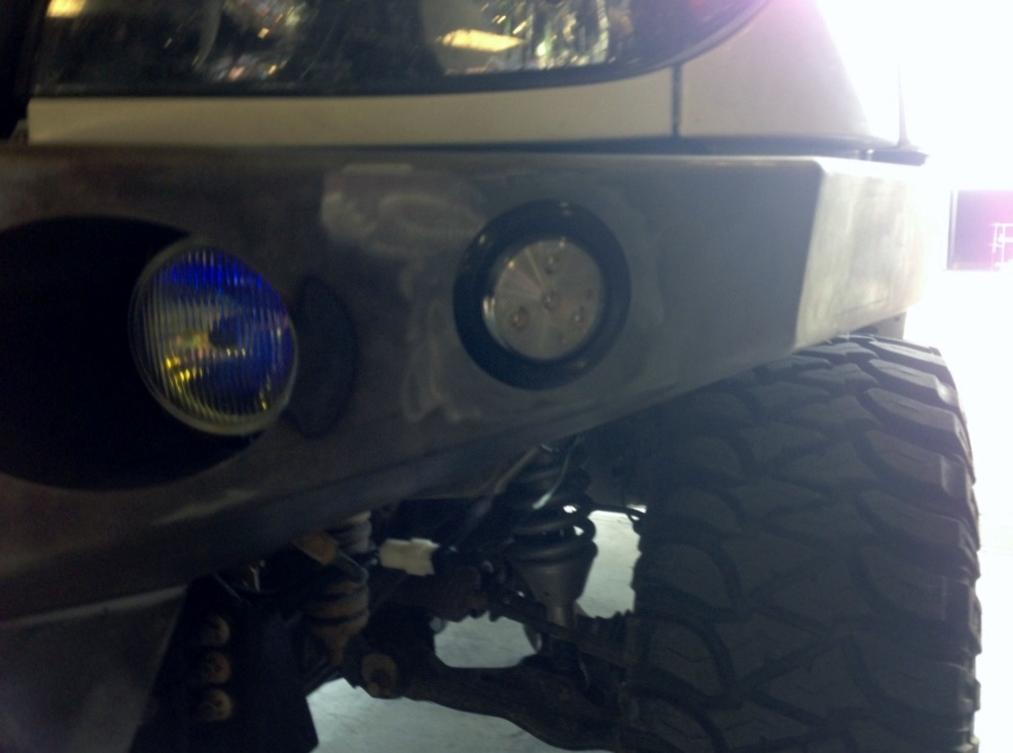

I called Nathan at CBI and he was happy to help trouble shoot the issue. They came up with ideas such as cutting the hole larger to except the next size up light which was a 4" turn signal (not really what i had in mind) As well as cutting two plates for me with button head bolts to bolt a right size hole up to the face of the bumper (I wasn't really cool with that idea either). As well shipping the bumper back to them would neither help me or them effectively. So I came up with the idea of just cutting a filler plate and filling in the holes then re-drilling the proper size hole for the lights. Nathan offered to pay any costs to me by a local fab shop to have this done. But this is what I came up with to resize the holes. Made them with a milling machine here at work.
I told Nathan that I would be the local fab shop lol as my company is a custom fabrication shop for farm equipment and that the cost would just be my labor. Nathan was insistent in being apologetic for the mishap and if there was anything I could think of to reimburse me to let him know. I told him "well I do plan to purchase a TJM stealth winch and the cheapest I've found is 650.00 online free shipping." Without question he came back with I'll sell it to you at cost free shipping from Idaho to NC. $500.00 even. saving me close to $250.00 can't beat that at all! Now i just have to weld these little rings into the holes and smooth out the welds I'll be good to go!

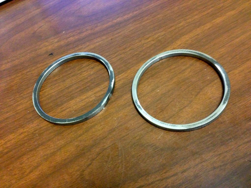

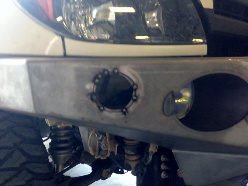

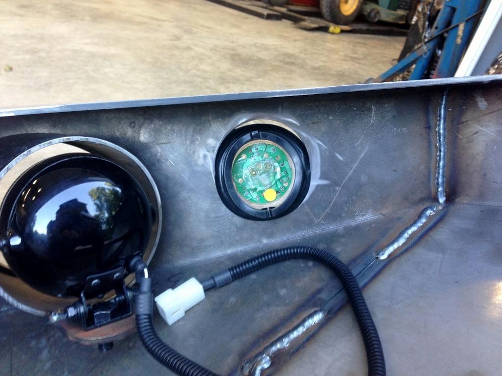

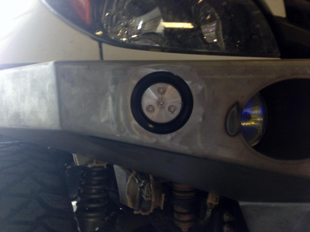

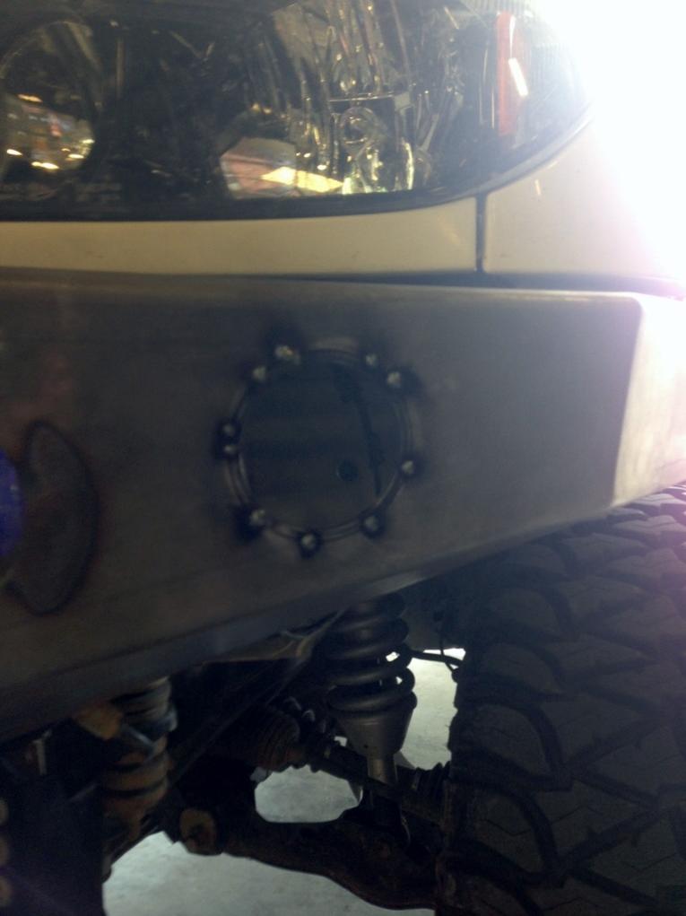

Just spent a little bit of lunch time and it's as if the hole size issue never happened :)
Just use a couple magnets to hold the rings in place
Tack welded moving from side to side to keep the heat down
Welded a few small bead welds alternating sides only laying about a 1inch section each pass. then used a 40 grit flap disk sanding wheel angle grinder to make it invisible. I have some air tools at the house I can use to smooth out the rings the 40 grit leaves behind.
