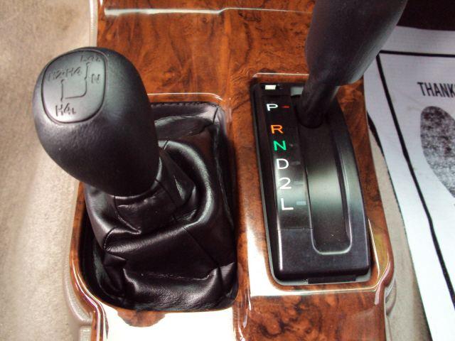

oh one more thing how does this one shift to 4wd? heres the pic of the shifter. H2 and H4 are in the same spot????
you should start a thread about you wanting to buy ones, that said the picture of teh one shown above is from the '99 correct?
it should have a push button on the side of the left shifter, you press that for toyota's awd on the 4runner, if you want real 4x4 where you can break something simply pull the lever on the left towards you and if you want to use your lockers or go into 4-lo shift to the side and forward
H2-4hi means AWD all wheel drive good for any surface speeds below 75 or so and is toggled with the button on the side of the shifter
4HL means true 4x4 front locked to back
L4L means true 4x4 low range (you can only engage the locker in this mode)
