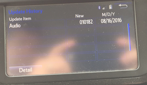

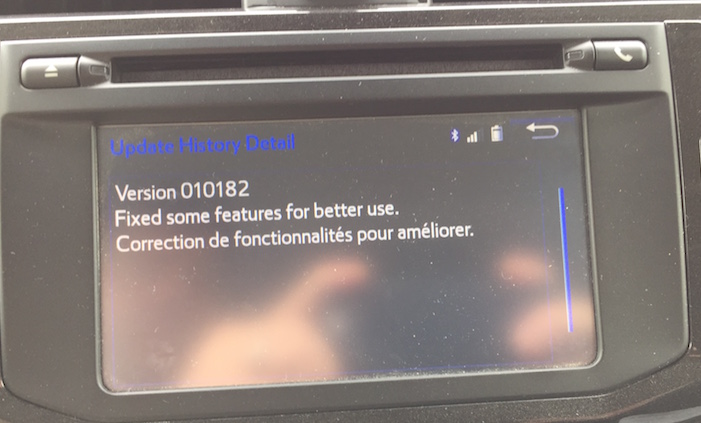

entune update for 2016 TEP
Just a heads up that I think there is an update for 2016 models (at least it was new to me). However I don't think the instructions in this thread are applicable.
It is version 010182.
We really need a consolidated thread about Entune versions by year/model as the information is really hard to find. Calling Entune support is comical and was largely useless for me.
I'd try create the thread, but I don't have enough posts.
I believe the update occurs automatically through Bluetooth and the Entune App. I noticed that a message appeared on my screen yesterday that normally comes with an update.
Yes, I agree we need to have this consolidated according to the year of the vehicle.
