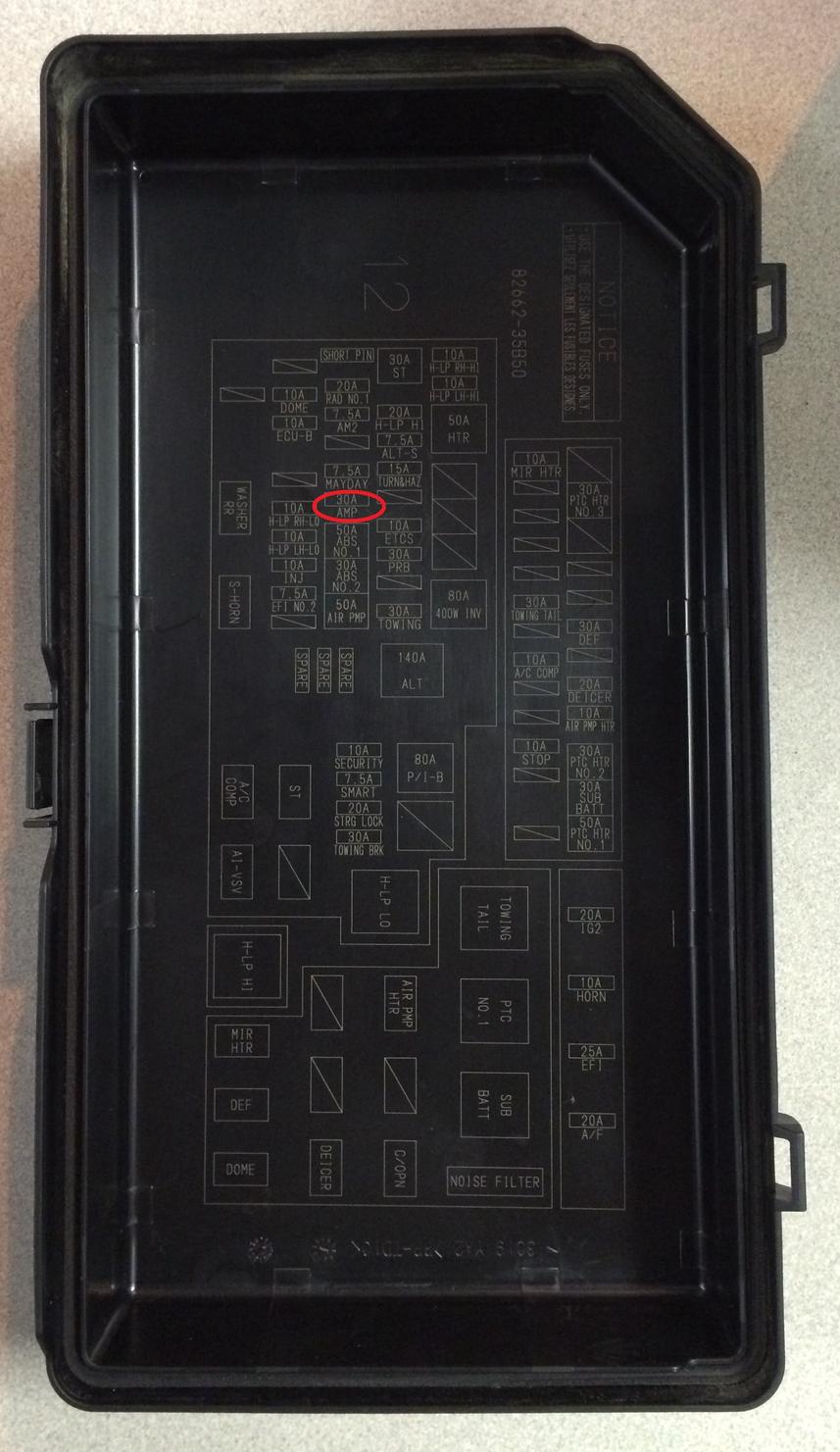

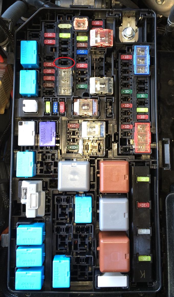

Here is my fuse box.......
Looking for the correct fuse for the HU.

For some reason though, I don't have that 30 AMP fuse or the 7.5 next to it.
[MENTION=83083]rigtec[/MENTION]
Nice info and diagrams...thanks big time for leading all of this.
Okay I see that... What's labeled on the cover(?); One of those 30A fuses is your AMPLI FUSE, hu couldn't operate w/o it! BTW: the 7.5A fuse mentioned in my above post is located in the driver-side fusebox, sorry... I didn't make that clear because you don't need to pull that fuse; turning the vehicle off de-energizes the circuit!

Haha... sorry bro,
No, not that fuse! There's a fuse that's 'HOT AT ALL TIMES'; it provides the hu with constant power that allows data to be stored in your navi's processor/hard-drive. Every so often, the processor files get damaged from constant use, file transfers, stored but un-used temp/broken files... much like your lap-top or phone. So pulling the 'HOT AT ALL TIMES' Amplifier (Amp) fuse helps to improve the performance of your navigation system. So you may need to drain that circuit so that the hu can revert back to it's original/default state of operation; much like System Restore will do for your computer. Look in the main fusebox for a 30A fuse that is energizing the hu. It's there somewhere, Cheers!
Greg,
The photos of my cover and fuses are with everything installed as found.
I do not have a fuse in that 30A AMP location!
