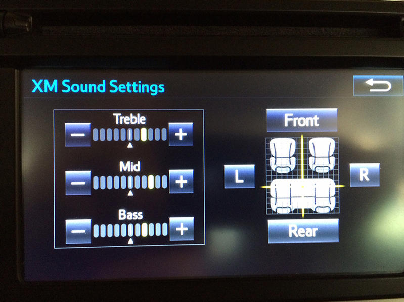

Ok, I had the fuse pulled for 6.5 hrs.
Although it took longer for the HU to come up to speed, like it was reloading all the data, the XM Sound Settings didn't go back to default settings.
Also, after plugging in the flash drive, it didn't recognize it nor it's .iso file.
EDIT
So, tonight before turning in, I'll give it another try pulling the fuse.
Will inform as to how many hrs it will be without power to the HU!
