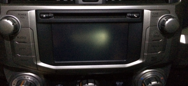

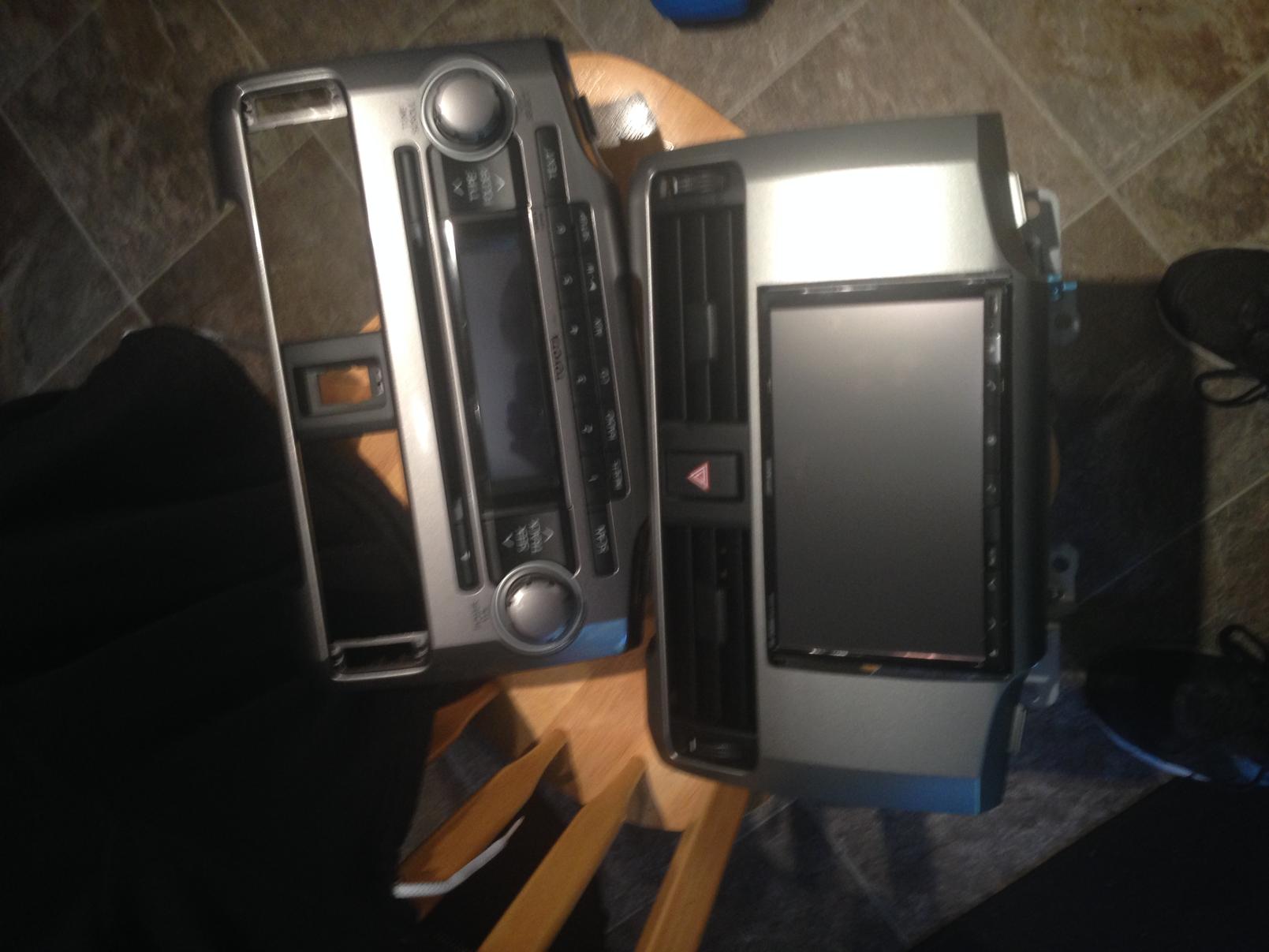

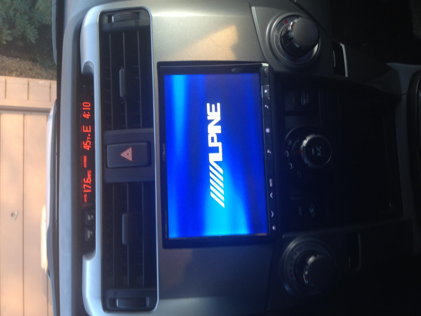

I found a great alternative to the shitty Entune setup...

Alpine systems make some great audio equipment; top shelf stuff! However, our objective and reason for this thread is not to replace this equipment; plenty of threads on great aftermarket alternatives, and how to install audio systems. But this is an on-going problem that NEEDS to be addressed and we are all working to help eradicate some of these problems that our beloved 4Runners have been plagued with from day one. Thank you for your post! Rgds
Thanks, I will stay more on topic. To answer the last question, however, I just used the ISO bracket from the stock radio to mount the nav unit. The trim kit is the Metra 99-8227S. It has to be modified to allow the 8" screen to fit in the double din space. You can see my cut lines kind of suck so I am in the process of trimming a replacement one.

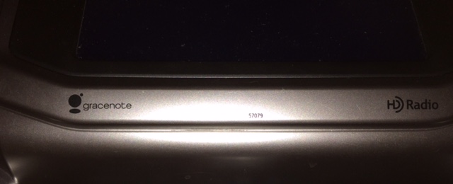

2. the iso you mentioned "swdl.iso" looks to be the same file that was in the entune 3.2 update thread, which also came with another file in addition to the "swdl.iso".
3. this 3.2 update only applied to certain head units.
3a. one of the head units not included in the 3.2 updates was the limiteds as they had a HD radio which in the 3.2 update states specifically didn't apply.
[MENTION=464]clin9383[/MENTION] & [MENTION=83083]rigtec[/MENTION]

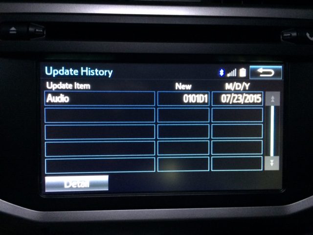

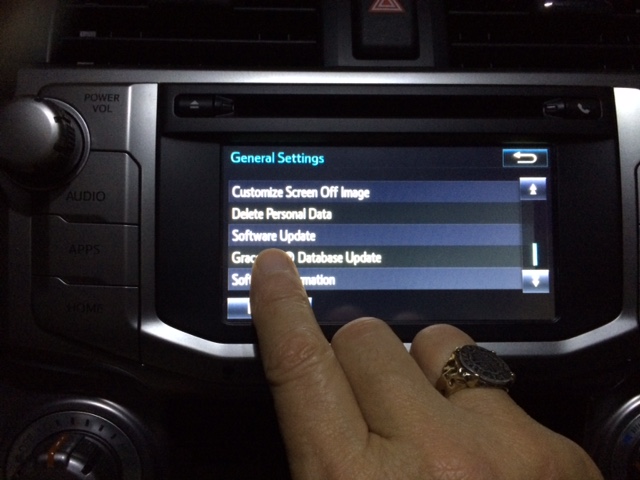

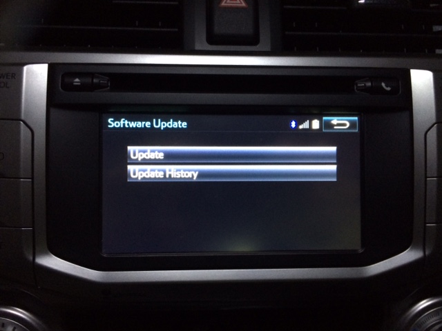

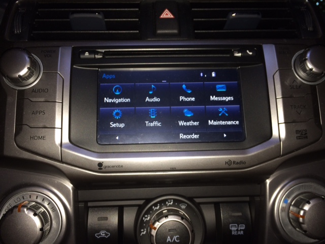

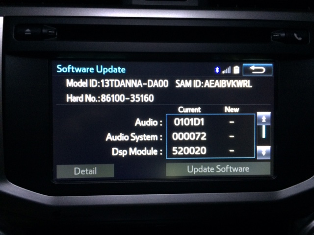

Here you go guys, this is what my HU and Apps screen looks like as well as the Software Update Screens.
Hope this helps!
