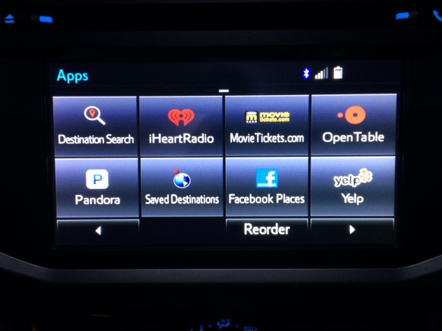

hi [MENTION=103267]Saker[/MENTION],
Thanks for posting the pics, I asked because I thought if you had the icon "destination search" in your Apps menu it would signify that you had the latest and greatest. If you have an icon that says "bing search" it means you are still on the old version of entune. I am unsure of the 2014+ layouts so I can't really comment. It should looks something like this Toyota.com - Toyota 4Runner. Did you setup your entune account at toyota yet? What kind of phone do you have running the entune app suite?
I do have Destination Search.
Yes, my account has been setup from the day my T4R was purchased (Nov 26, 2013)
iPhone 5S
Here is a photo....(I thought you wanted the other Apps Screen :D)
Awesome, I think it's safe to say you have the latest version. I'll assume you have "slacker" as well in your app list.
