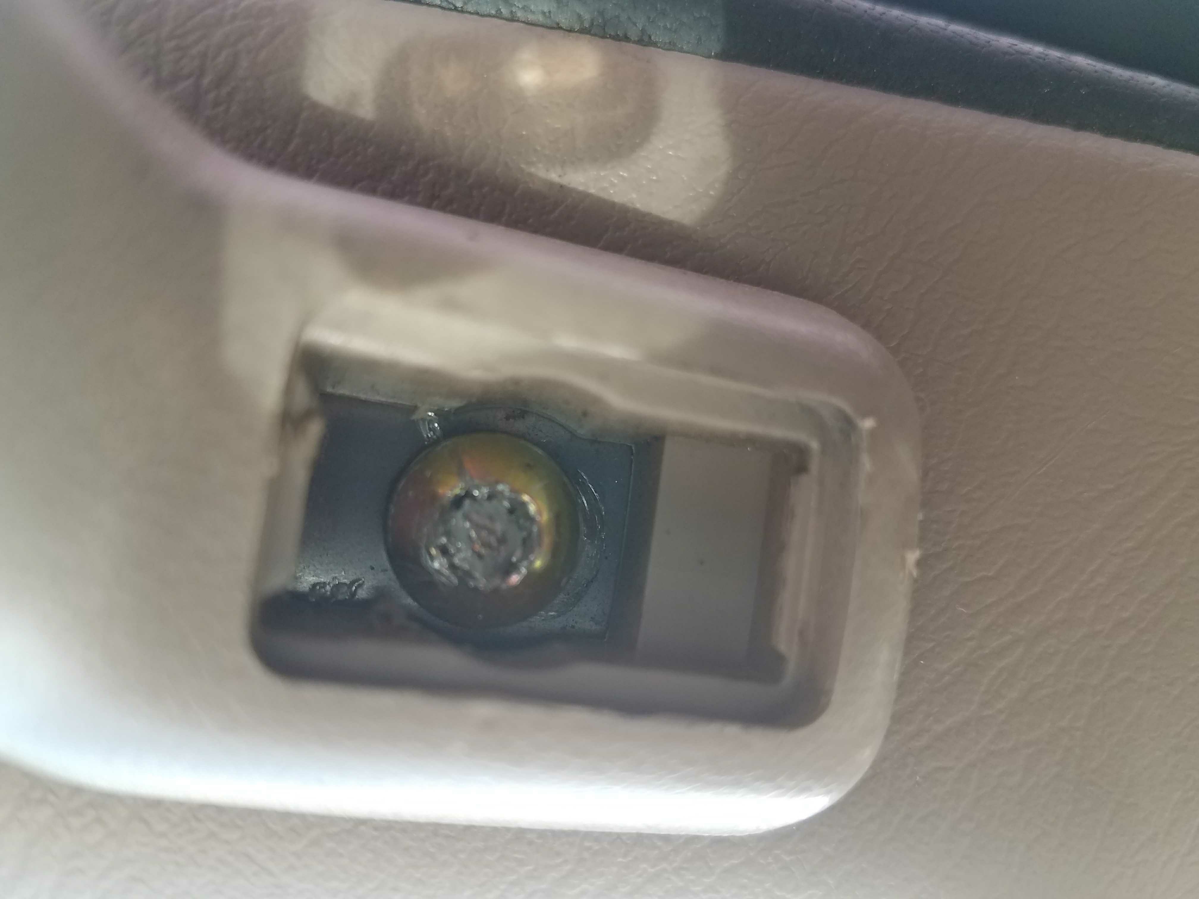

I had good pressure on my impact which just immediately stripped the bolt tip. I made the mistake of trying how to use an easy out. The tip snapped off inside the bolt now I have hardened steel preventing me from drilling a bolt out. I'm going to have to sacrifice the handles and use a grinder to grind of . f the bolt heads, then draw them out, and install new handles. This Lock tight suck!s! Any better suggestions for my situation?

Same thing happened to me. It was my excuse to buy a die grinder. That made quick work of the bolt head. Then with the handle out of the way I was able to overcome the locktight and turn the bolt shaft out with vise grips.
what i did was cut out the plastic base and used a vise grip. replaced the grab handle with a new one but removed the loctite from the new screws before installing
