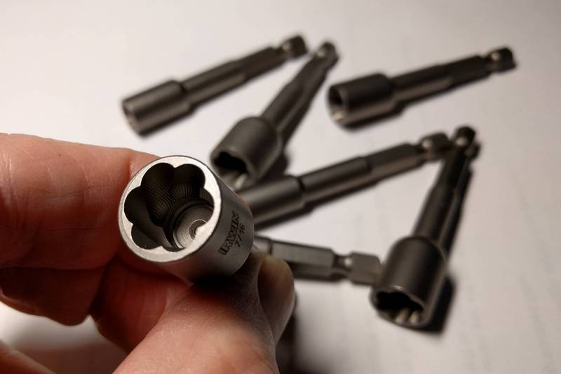

These are what I used to loosen the pillar grab handle bolts. Using a drill or impact driver, they grab and lock onto the OUTSIDE of the bolt, so it doesn't matter whether hole is stripped or not. Worked perfectly.

Regarding the Irwin Power-Grips: I just remembered that when I used them, I had to use a hammer to get the "spiral flutes" to bite into the smooth surface of the bolt head. The metal was hard and just pushing with the tool in the impact driver wasn't enough for it to grab. Once a little pounding with the hammer created a few notches in the metal, the impact driver easily locked onto those and pulled the bolt right out.
