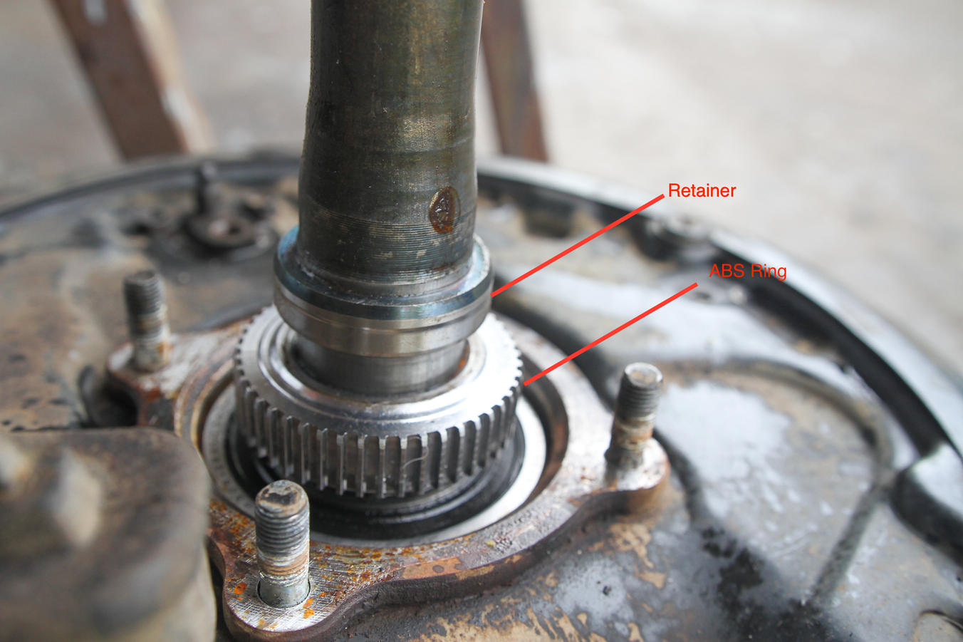

So when I got the shaft back today my friend at the shop showed me why he didn't press the retainer all the way down to the ABS ring
You can see how the retainer is not pressed all the way down against the ABS Ring

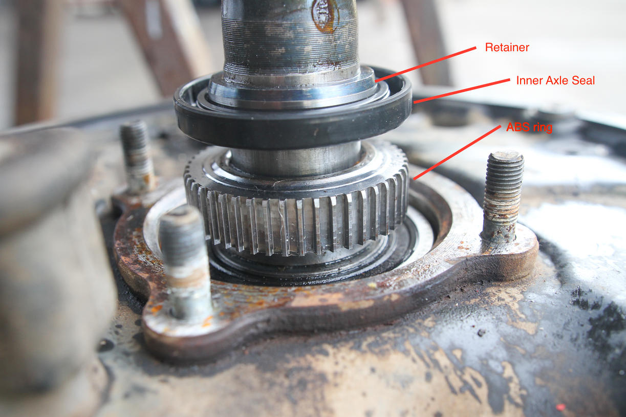

Here is what it would look like inside the axle housing and how the inner axle seal would fit flush on top of the retainer
I measured the inside of the axle housing from the end to the inner axle seal, and it measures perfectly for the retainer to fit snuggly against the inner seal. Unfortunately I did not keep the exact measurements anymore, but you guys get the idea. By eliminating the gap between the retainer on the axle shaft and the inner axle seal hopefully there will be a less chance of leaking. So far I have only driven a couple miles and everything is still dry, I will try to update after substantial driving

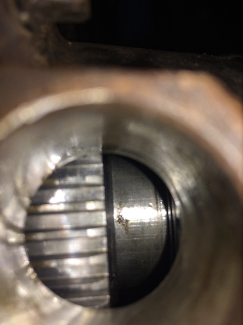

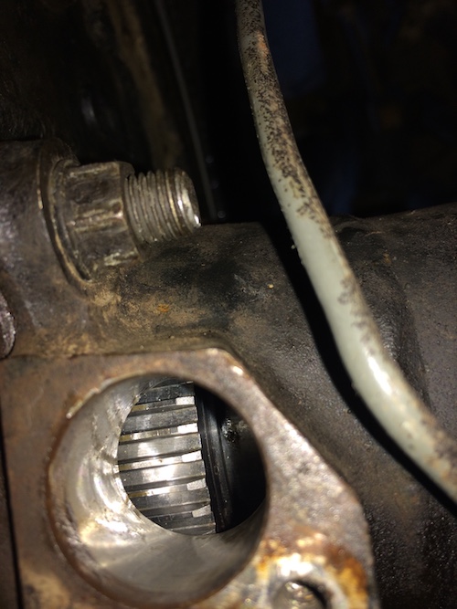

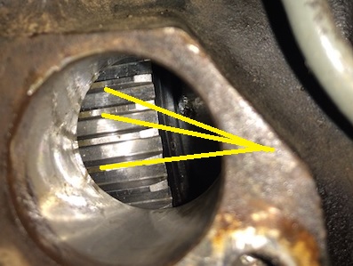

As I said I havent done any substantial driving yet, only about 20 miles. But I just checked the inside the abs sensor and it is completely dryIMG_8010.JPG

I guess I'm confused as to why even push the ABS ring so far down in the first place? Why not have it in its proper location? You could still have the retainer where you want it but put the abs ring in the correct spot.
Is the ABS sensor working with it that far down?
I hate to break it to you but I see gear oil on the ABS ring. Keep an eye on it.

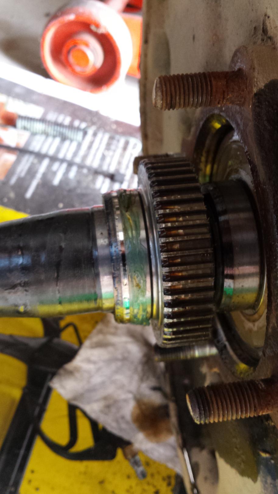

Here's a pic of where my old seal was riding on the retainer. If you look at my pic and post from above, you will see where it was riding with the new seal. Dr coffee's solution has merit. I reversed the retainer picking up about 1/8" because of the bevel and moved the retainer about 1/16" closer to the differential. No leak yet. Thanks Dr Coffee.

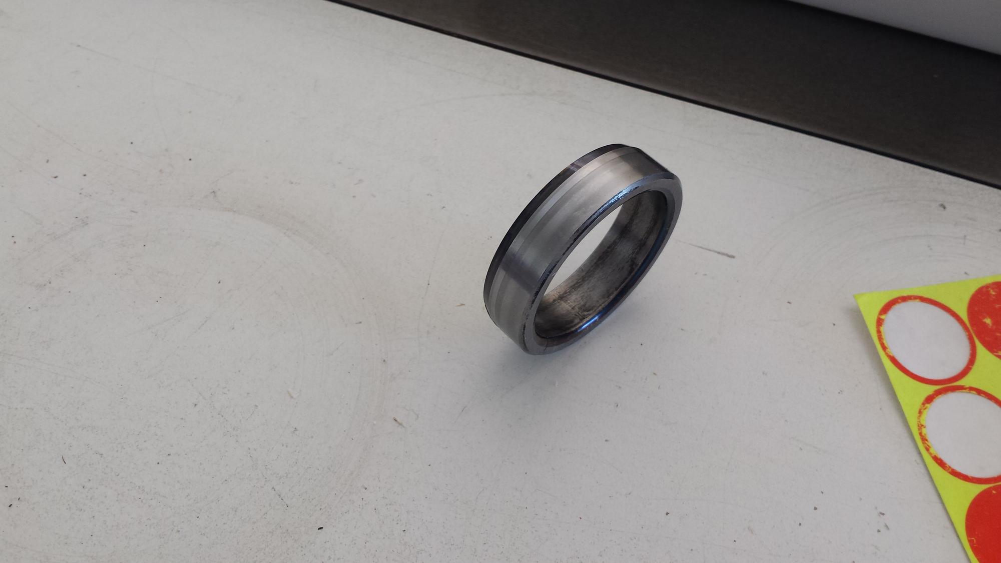

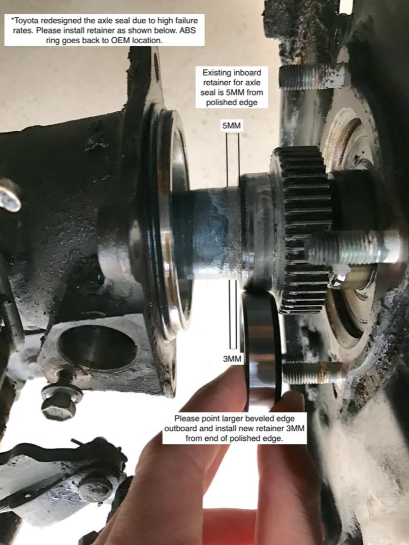

Attached a photo that I gave to the machine shop in case anyone else wants to use it.
Only 1,000 miles so far but no leak.
Thanks again.

Dude, what you need to do is take your truck back to them and insist they do the grease test right in front of you. This is what I did when my local Toyota dealership screwed up the job and I was leaking on my driver side in less than 5000 miles. The tech who did the job on my truck did not even know what a f#cking grease test was. So, another tech watching the whole show told him what he had to do. When he pulled the axle back out the grease test showed the lip of the seal was barely riding on the polished surface on the retainer, right on the edge of the bevel. At one point, one of the many techs watching what was going on told the tech that did the job on my truck that I just schooled him. This goes to show that a DIY mechanic can often know more than a paid mechanic because of forums like this that share information.
[MENTION=102606]infamousRNR[/MENTION], [MENTION=148218]JZiggy[/MENTION] and I recently did an axle seal job on [MENTION=148218]JZiggy[/MENTION] non-abs rearend. We confirmed without a doubt that following [MENTION=78997]Drcoffee[/MENTION] suggestion of flipping the retainer around was absolutely necessary to get the lip of the seal riding in the center of the polished part of the seal retainer.
What many techs still don't understand is they can't follow the FSM specs for the placement of the retainer anymore. Toyota redesigned the axle seal at some point in the past and now the lip of the seal sits 2mm more inboard than before. If you follow the FSM spec, the lip of the seal will be barely riding on the polished part of the retainer.
With the Non-ABS rearend, you have to press the retainer all the way against the bearing to get the retaining clip in place so you can't adjust the retainer position to get a better mating with the seal. The only choice we saw was to flip the retainer.
With the ABS rearends, you have a second inner retainer and an ABS gear. The inner retainer is what connects with the axle seal. This retainer in it's original orientation can be moved a little more inboard to mate up with the seal better but then it comes very close to rubbing the inside of the axle housing. Flipping the retainer again seems like the best choice to get a better mating of the seal and retainer and keep the retainer from rubbing the axle housing.
We filmed the Non-ABS job and we're going to hopefully film an ABS one soon. We missed filming an important part of the pressing procedure so we're going to wait until we film the next one so we can add that missing footage so the video will be complete and not leave people guessing how we did it.
TAKE YOUR TRUCK BACK AND TEACH THEM SOMETHING ABOUT OUR RIGS. Your efforts will hopefully avoid the next 3rd Gen owner that visits their shop for an axle seal failure from going through the same bullshit. Good luck and please report back what the result end up being.
