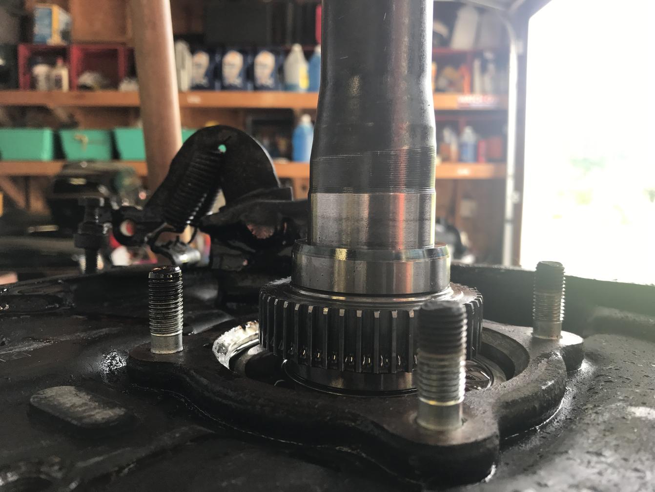

Just did mine

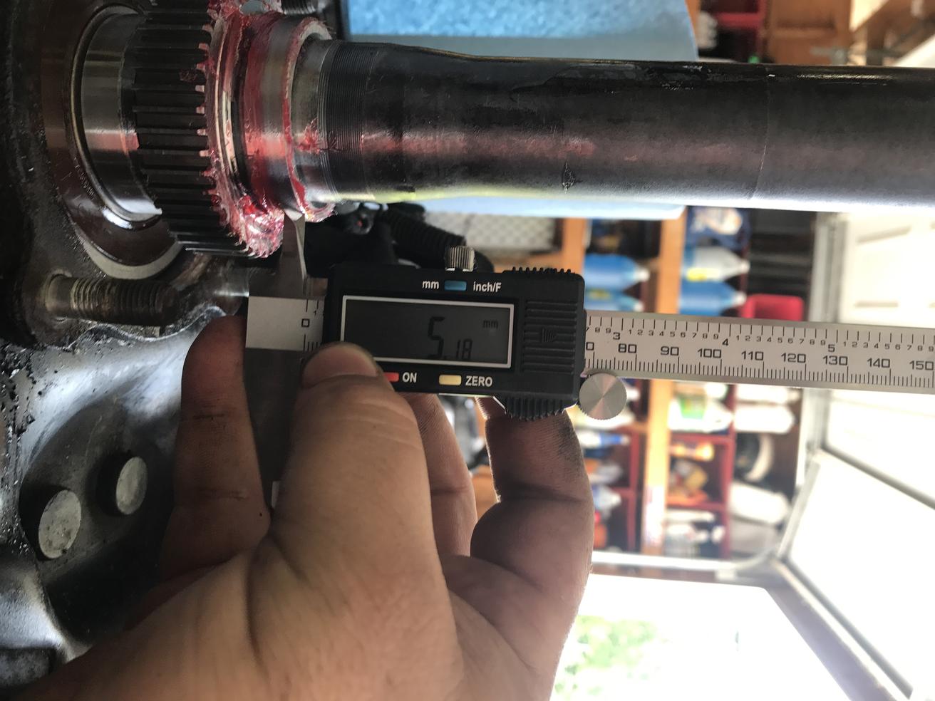

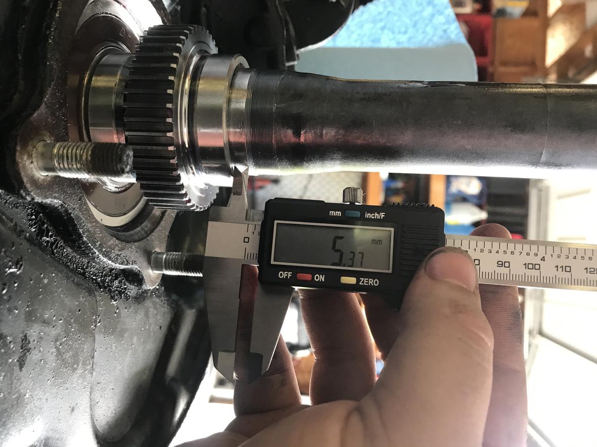

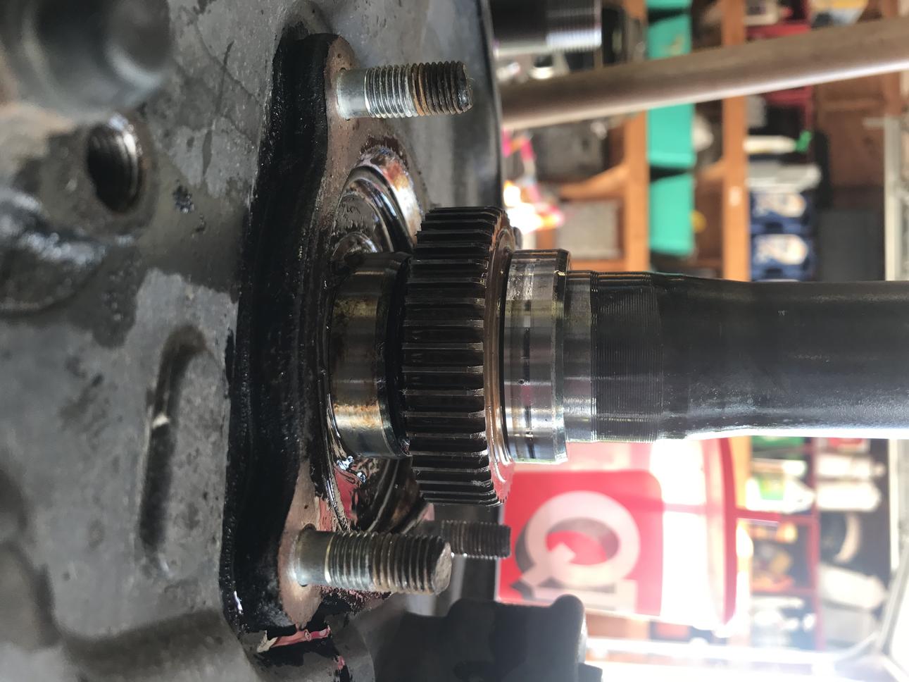

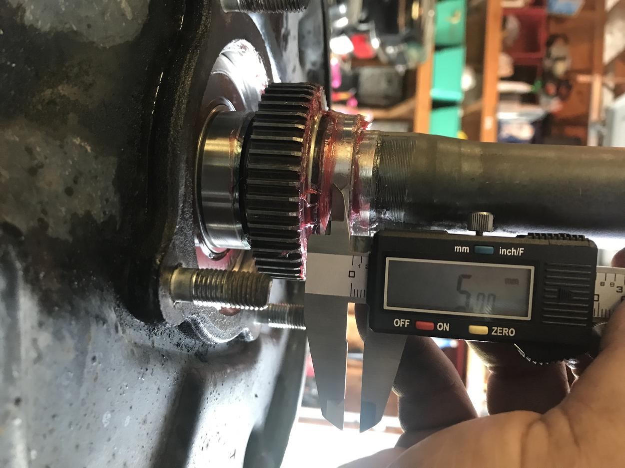

So yeah... Just did mine yesterday. Here's a few pictures and measurements I came up with. Truck has 230k on it.
Purchased the vehicle a few months ago. Previous owner said he had a wheel bearing replaced recently. Upon doing the first oil change I noticed large amounts of gear oil on passenger rear tire. Texted previous owner to find out which bearing he had replaced. Confirmed it was passenger side. Performed by local well known Toyota dealership.
Toyota dealership left me with this gem (no wonder it was leaking gear oil like mad! Notice no witness mark on retainer!):
All flipped, pressed, and grease tested:
Driver's side (virgin axle) I am assuming it was the factory installed bearing/seal because it was the old seal design. Had small amounts of gear oil in ABS housing not enough to contaminate brakes:

I think measuring from the "polished edge" is not the best idea. That isn't a set dimension from the face of the axle as far as I know - and there could be variances in how much material is polished from the factory, not to mention aftermarket manufacturers. Measuring from here is taking a chance... you might get lucky... you might not.
The Toyota FSM shows where the ring needs to be measured from the face of the axle.
I agree.
IMHO, I don't really care what measurement I got. All axles are gonna measure differently. You can even see in the pictures I posted that the polished section of axle doesn't have a straight cutoff line. You can sort of see a "stepped" section which would throw off measurements depending on what section you measured from anyway. The only thing I really cared about was the grease test being close to the center of the retainer and the retainer not hitting the axle housing once installed. I think I accomplished those two things.
