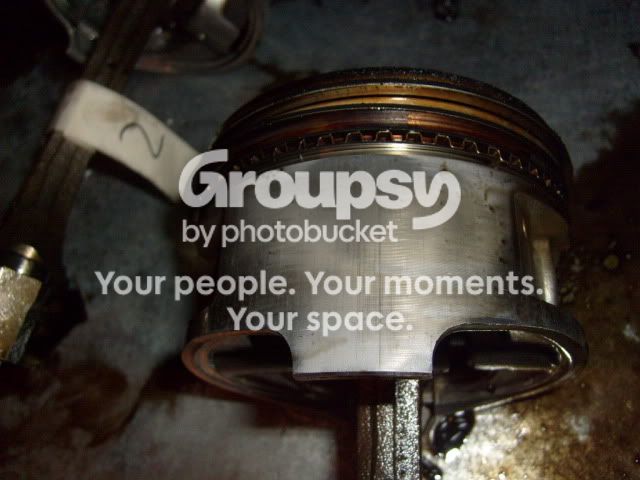

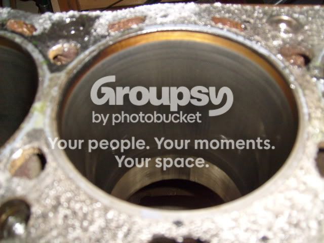

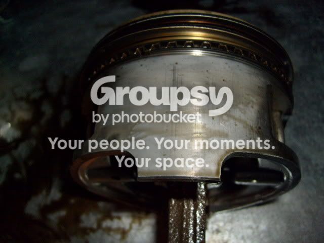

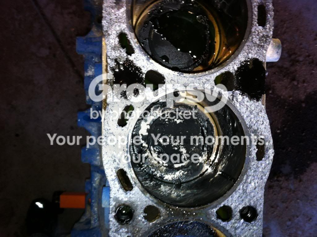

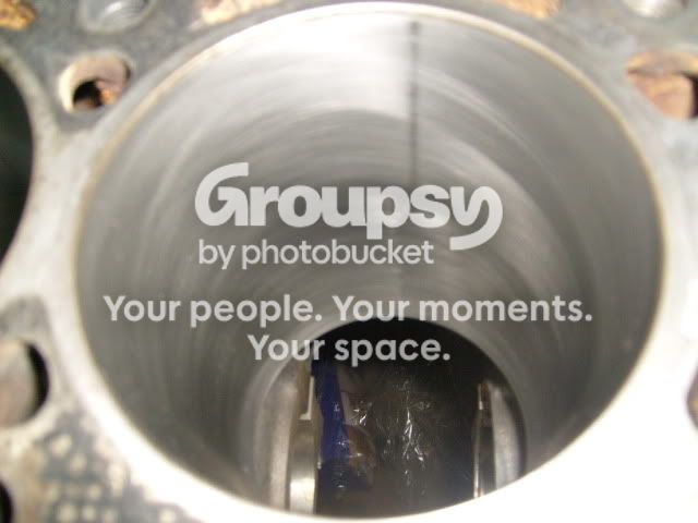

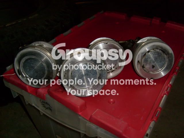

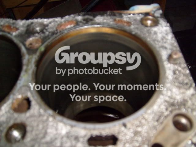

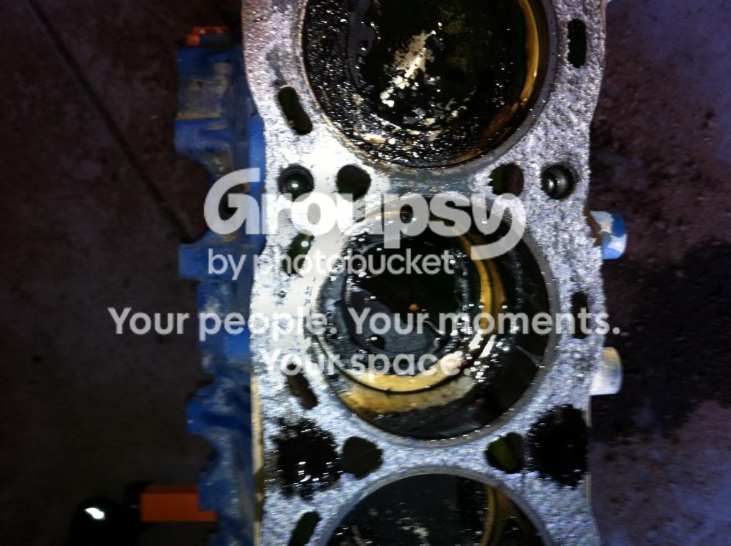

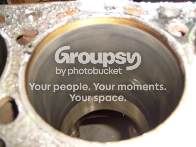

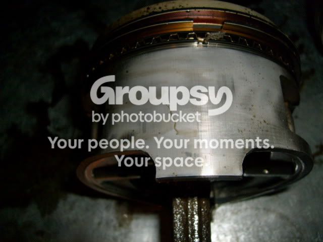

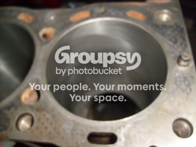

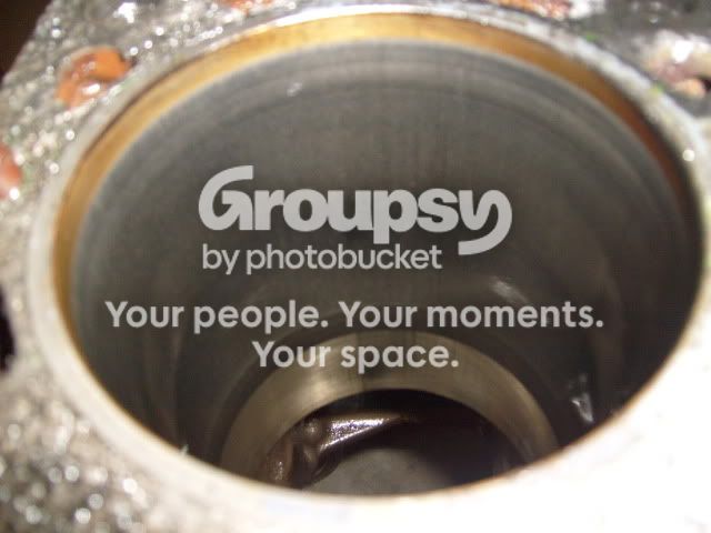

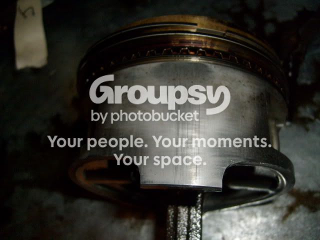

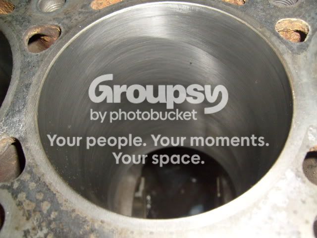

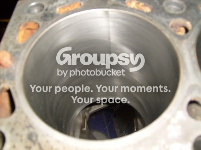

Here's a few pics of the piston skirts and each individual cylinder wall.
#1 Piston Skirt
S6300830.jpg~original
#2 Piston Skirt
S6300831.jpg~original
#3 Piston Skirt
S6300832.jpg~original
#4 Piston Skirt (no, not a crack... just oil)
S6300833.jpg~original
#1 Cylinder Wall
S6300826.jpg~original
#2 Cylinder Wall
S6300827.jpg~original
#3 Cylinder Wall
S6300828.jpg~original
#4 Cylinder Wall
S6300829.jpg~original
dusty much?
Well that's a terrible attitude... you should learn what the machinists do so you can spot a problem before it goes together :)
SV just curious did the original machine shop ask for the new pistons before they bored the block or did they just go .30 over stock? I ask because my machinist won't bore a block without the new pistons because there can be variance in the pistons and so he mic's them and bores accordingly. I agree, listen to the machinist and then put it back together yourself. you will not make the same mistake twice.
crosshatching is too narrow..... should be about 45* that looks like 30*.
crosshatching can affect oil consumption as well. As I mentioned, it's too narrow. It could be holding a little more oil than it should be.
Ding Ding Ding!! We have a winner! According to the machinist, the previous machine shop didn't hone it correctly.
The machine shop here in town sat down and talked with me a bit on the machining and honing process and they think they had their honing machine set to too high of a rotation speed.
This time around they will re-hone the block (they said the bore was fine), hot tank it and chase all the threads. They are also going to clean the head up and pressure check it. The pressure check probably isn't necessary on a new head but there was a bunch of oil build up on the bottom of the head so I figured it wouldn't hurt for them to clean it up and check it out.

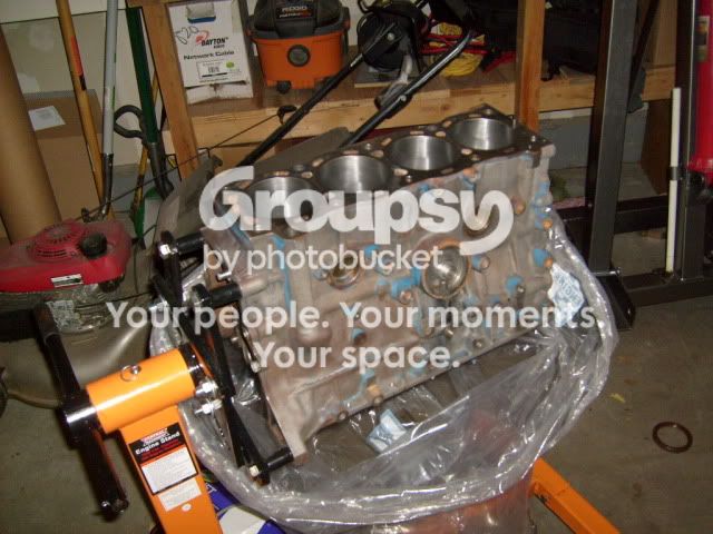

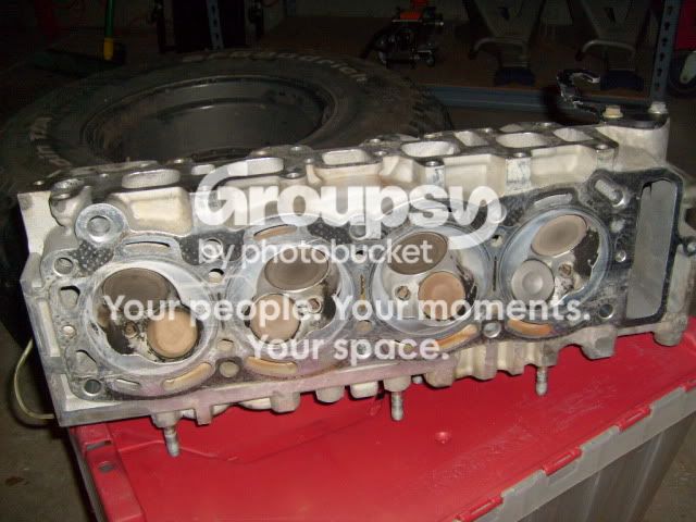

I got my engine back from the machine shop. I ended up using Lee's Automotive Machine Shop in Colorado Springs. They all seemed very smart on what they were doing and didn't have any issues taking time out of their day to hang out and b/s with me about engines and the issues I was having with mine. When I picked up the engine the machinist told me that he did a search through some bulletins to see if anything pertained to my blow by issue and found one issue with the PCV grommet but that only applied to the 81-84 engine valve covers. All in all, I would recommend those guys to anyone. Their prices were dirt cheap compared to what I paid in Tennessee for not much more.
They hot tanked the block, re-honed it and hot tanked it again. They also hot tanked the head and did some work on one of the valves. I guess with all the junk the engine was burning, one of the valves wouldn't seat right and wasn't sealing at all. They also hot tanked the pistons and stamped the piston number on each of the connecting rods.

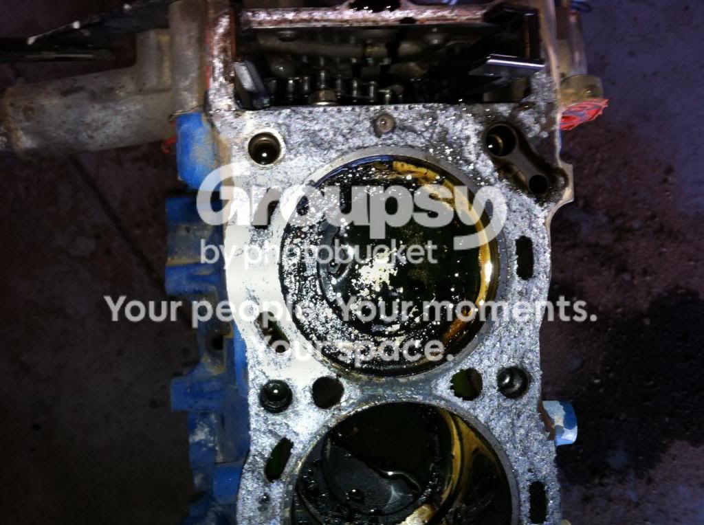

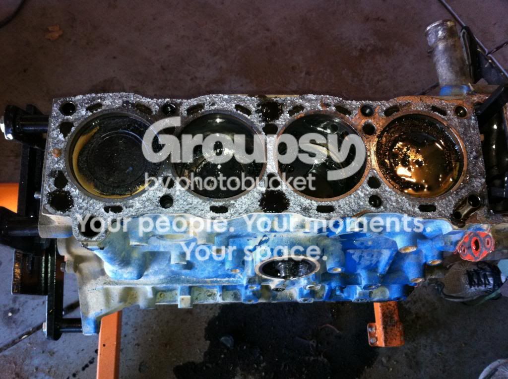

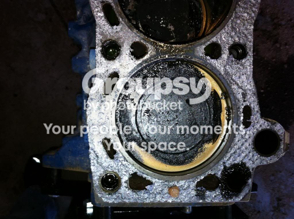

Just a recap...
Before:
017-5.jpg~original
019-3.jpg~original
020-3.jpg~original
021-3.jpg~original
022-4.jpg~original

S6300837.jpg~original
Cyl 1
S6300838.jpg~original
Cyl 2
S6300839.jpg~original
Cyl 3
S6300840.jpg~original
Cyl 4
S6300841.jpg~original

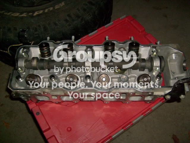

Head
S6300842.jpg~original
S6300843.jpg~original
Pistons
S6300844.jpg~original
I'm pretty impressed with how clean everything came out of the hot tank. I will get a small needle pick and clean a little more of the carbon build up off of the top of the pistons and the bottom of the head in some of the smaller places. Overall, I am happy with the work and the speed of their work.

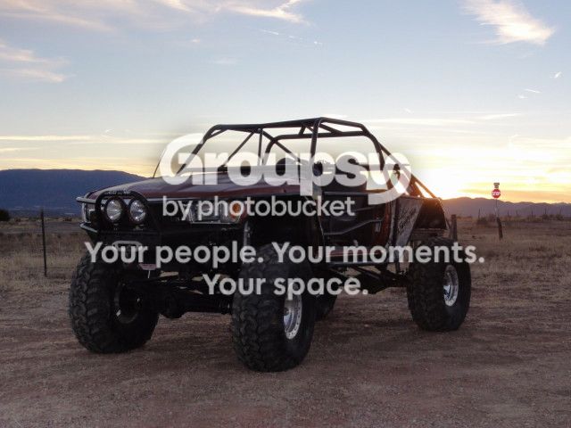

My buddy has a truggy down in penrose that was involved in a fire recently. garage caught fire and it burned the front end so it will need a new engine more than likely and some new sheet metal. It does independence trail effortlessly. He might let it go for a reasonable price. I can ask if you're interested.
DSC00468.jpg~original
DSC00467.jpg~original
DSC00466.jpg~original
