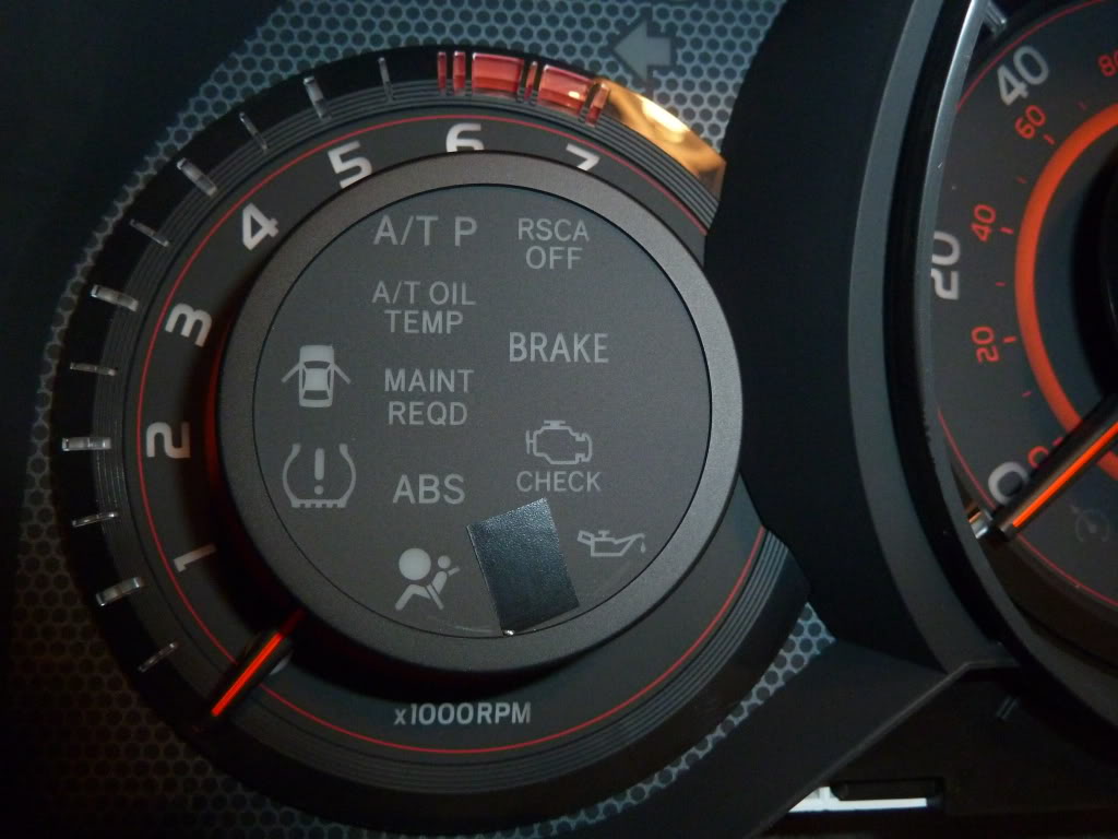

Where is the light?
Dave used a little bit of electrical tape to cover the seatbelt light. Once the tinted cover is back on you can't see anything.
Don't get any easier (or unmolested) than that!

:lol: that looks like shit, I would at least put the tape behind so it looks the same just not illuminated.
Read the post again.
I've seen it in person- the plastic cover is tinted dark enough so you can't see it when it's back together.
Cool, I'm surprised no one here has made a thread about that genius tape mod yet then.

I would pull the dash and de-solder the LED from the board. If it turned out that was going to be difficult, I'd do the tape mod above.

Thanks for posting that, I was looking for that thread yesterday and couldn't find it. I wonder how hard it is to get to the little LED behind the cluster… I am thinking hard which is why the tape method was used here.

The Tape was just going to be a temp solution until I had more time but after a few weeks I actually forgot it's there. It's now been there for years. Every now and then the sunlight will hit it a certain way where you can see the outline but for 99% of the time it really is invisible.
