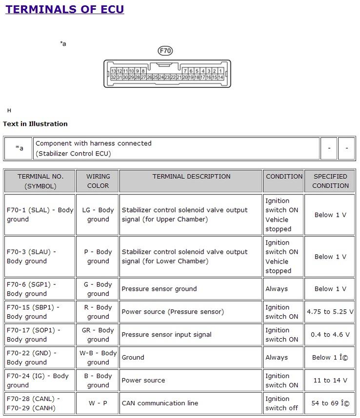

The only way I can think of is basically along the lines of what Greg is talking about, but a bit more refine, lol. Check out this chart from the FSM, it gives you the proper voltages (and grounds) each terminal should be seeing if KDSS is working properly. My theory is...if you generate a voltage signal (or ground signal) to mimic the respective singals on each terminal, the KDSS might just be tricked into thinking it's work :)
But of course this is all just theoretical, so proceed with caution because once you let the smoke out of the ecu, you can't put it back in :cheers:

I thought about this one for a while Shawn, aside from taking apart the gauge cluster and covering it with electrical tape from behind, or desoldering the LED altogether; there's really not much else you can do to directly turn that LED off. These darn gauge clusters nowadays are just way too high tech, it's fed with only a serial data signal and then the on/off signals of the indicators are generated inside the gauge cluster for the most part. It's not like the old days where we can just ground out a particular wire at the connector to trick it :(
Eddie, thank you very much. I was exhausted last night, eyes burning, trying to look through the Toyota FSM and find the diagram. I probably looked right at that multiple times and it didn't register. I think IU am going to try and locate the pressure sensor input wire, probe it (i'm guessing it would be on the low end of the voltage scale depending on how the pressure sending unit is wired as Greg said.

One concern after reading that FSM chart is, those first few grounds (SLAL, SLAU), it seems like it might only need to be grounded when the vehicle is stopped, so I am not sure if a constant ground would throw a code? This is where you need to start probing around and see what's on each terminal and go from there (this might just be a long drawn out way of the FSM saying its a constant ground, lol). Hopefully the only thing you really need to do is mimic that pressure sensor input signal (SOP1), and you will be on your merry way.

You know...here's another thought, you might just need to unplug the pressure sensor and do output signal modification right from there at the three pin plug to drop the voltage a bit (from ~4.75-5.25V down to under 4.6v).
I think (SBP1) and (SGP1) are the ground and power wires going to the sensor, and (SOP1) is the output voltage after the transducer (that Greg is talking about) has done it's thing. So you have more than enough create a modified output signal, and you don't need to mess with the 12v power network, since the sensor's power source is already at 5v.
If you test this and it works, there's more sophisticated ways to make drop the voltage to whatever you want, like voltage regulators, but that's more trouble than it's worth if you're just testing.
Another idea comes to mind is using diodes to drop the voltage too, but testing purposes you're not going to be the simplicity of doing a resistor network. It's what we nerds used all the time in the lab at college, lol.
