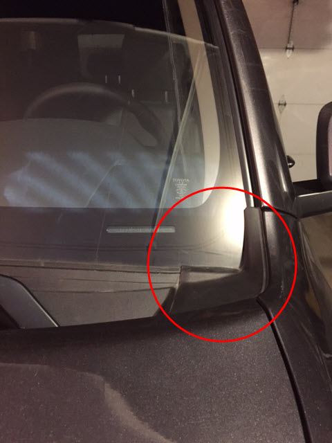

Turns out it was the plastic trim piece in the corner of the windshield. I discovered this only by pushing on every surface in that area to find the noise. I pried it loose with a trim removal tool, flexed it a bit, then reinstalled. Problem solved, hopefully permanently. In other news, I've also shored up those cheap pins that hold the inner splash guards in place.

I have this same squeak...passenger side trim doesn't move but the piece you circled does. I applied double side tape to this piece to no avail, so you pulled it off and flexed it in the opposite direction?
I'm not sure what you mean by "flexed it in the opposite direction."
Yes, I did pry that piece off very carefully, starting with the part closest to the wiper arm. Then I just flexed it gently to flatten it out a bit. I also bent the plastic tabs underneath it outward ever so slightly so they would grip better when I reinstalled. It seemed to "snap" into place pretty well. But who knows--maybe I got lucky and it will start squeaking again in a month.

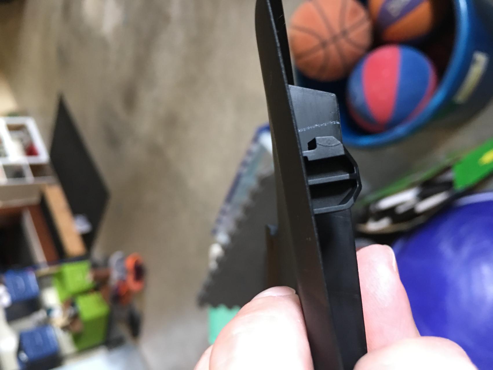

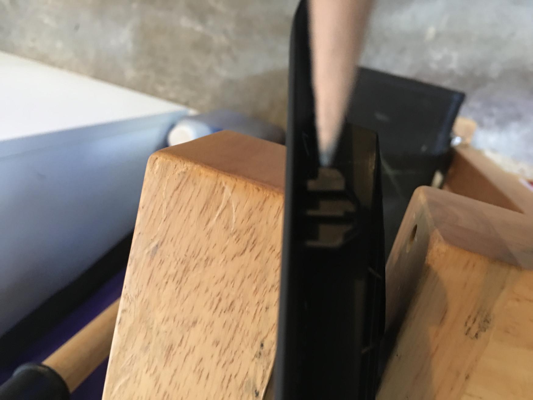

I also dealt with this. After taking my cowling off and looking for any source of noise under there, I finally narrowed it down to the corner cap. Passenger side. I could push on it and make it squeak. Turns out it just wasn’t going down far enough to snap securely into the cowling holes. I actually had to shave/trim a tiny bit off the front tab to get it to snap securely. I needed it to go down farther to seat properly. Flexing the tabs didn’t quite do it for me but we were probably fighting the same problem. I attached the following two pics to another thread but they might be helpful here, too. I also tried double stick tape but that didn’t work. FYI - I found it easiest to reassemble by sliding the cap up the windshield-pillar groove first and then snapped the clips into the cowling. Good luck!
