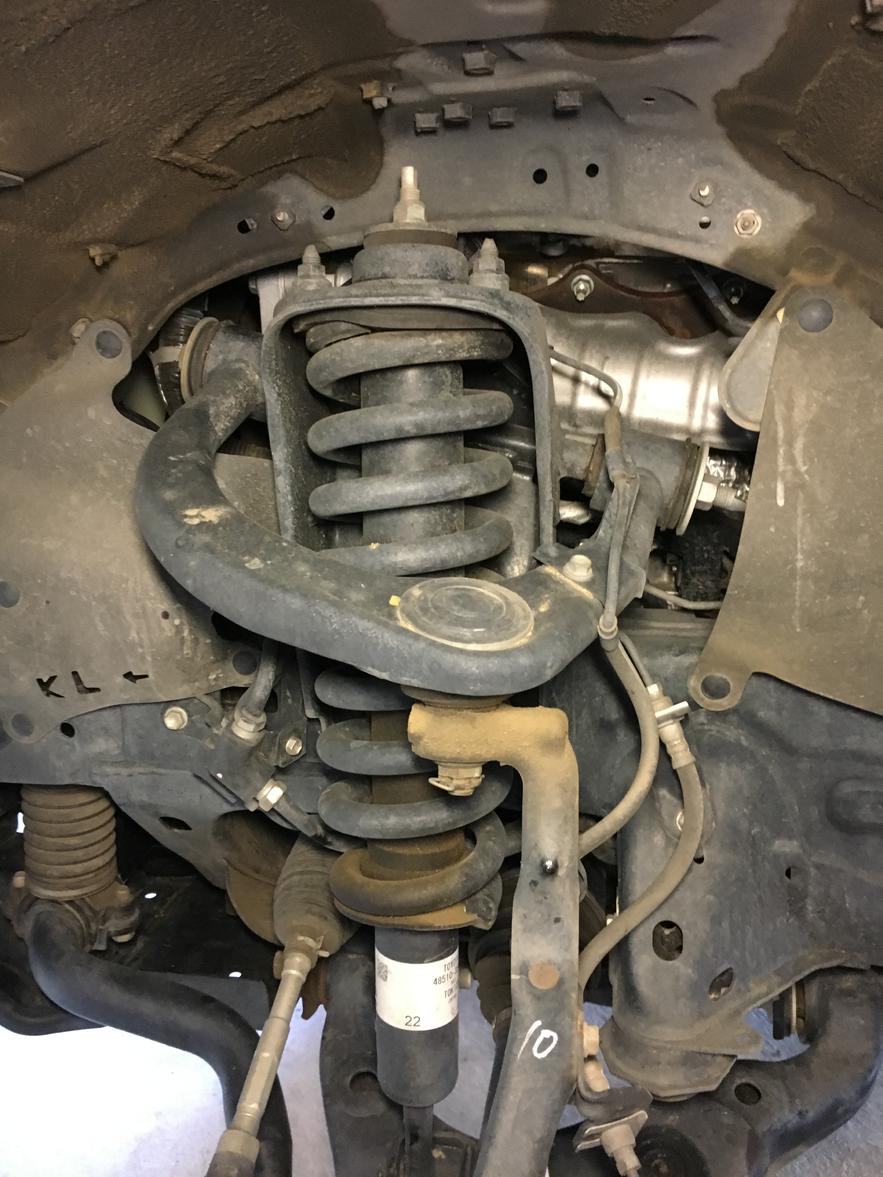

On the top front one I was able to press the tab in on the backside while prying the clip out. It was a PITA but it came out. I then did the second one the same way. I didn't break either tab on the backside, but can see how one would break.
Alright, so I pulled out the top pins on the front and back piece, put so double stick tape in there and replaced with new pins. Snug as a rug. But unfortunately I'm still getting a squeak noise. Can't tell what it is. Took it to dealer and they thought it might be front skid plate. I ran over a cone in the road and I guess it put a dent in the skid and they say it's rubbing. I don't buy that but I'm at a loss. It's definitely coming from front and seems like drivers side.

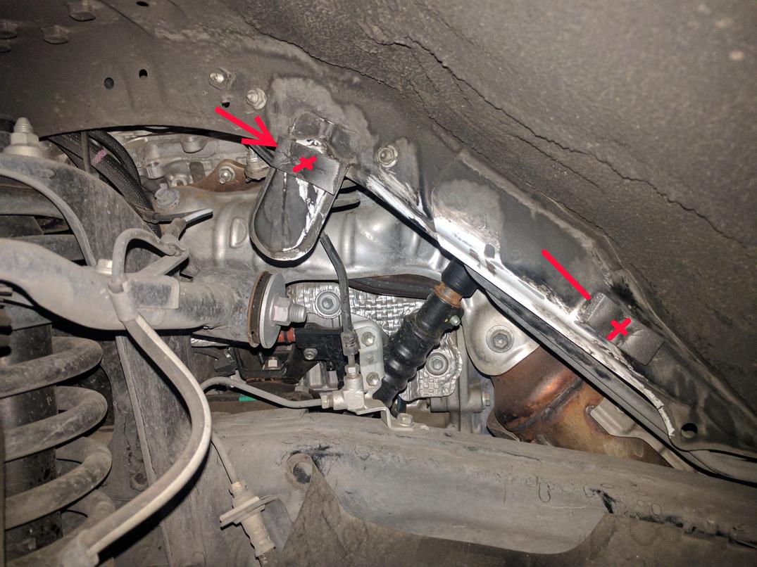

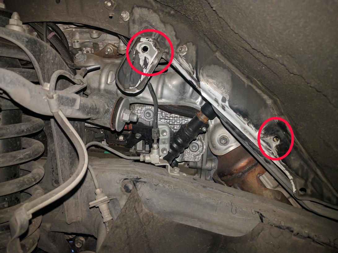

I borrowed your picture and added a little more detail.

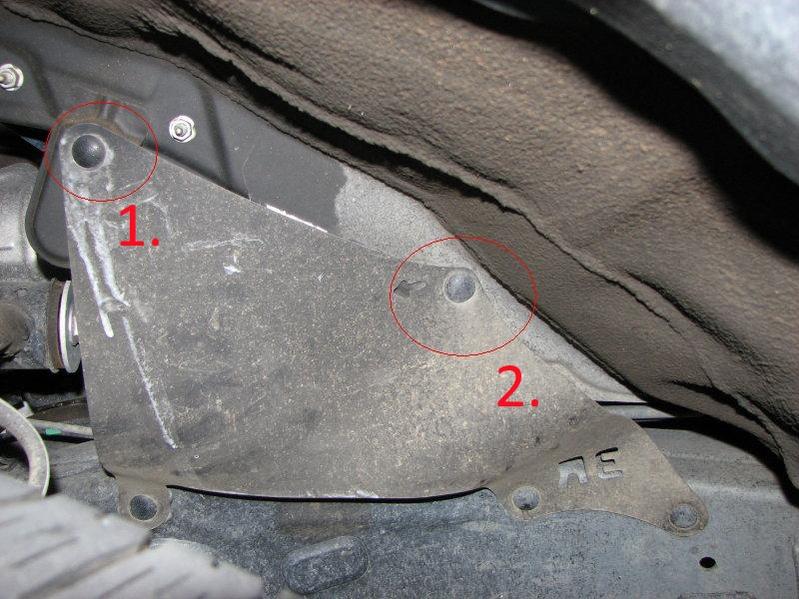

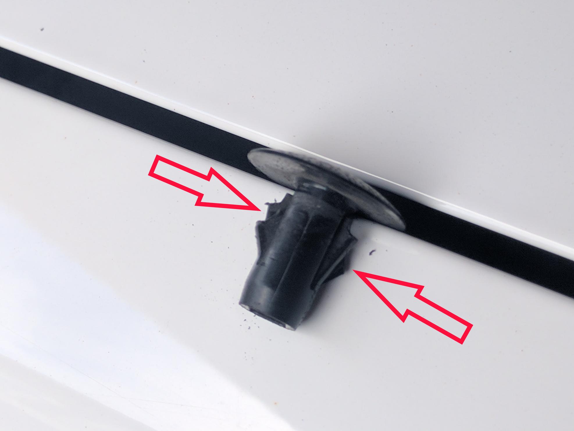

The retaining clips are reusable so don't try and force them out.
Start on the left, reach around the back and squeeze the protruding sides of the clip, then pull it out with your free hand. The clip on the right is a little harder to reach, but is accessible.
I cleaned the area, then applied two small strips of foam weather stripping...
10 minute fix.
