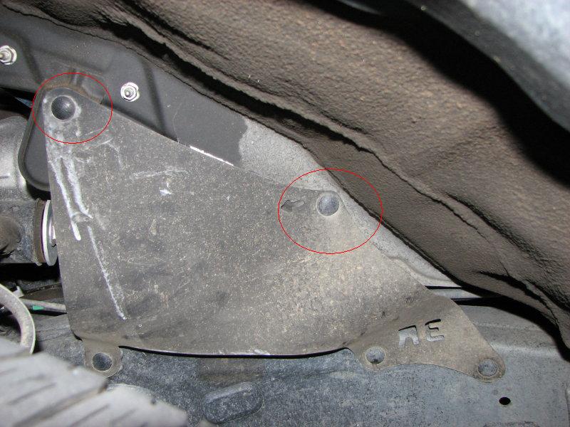

Any pics of this part and exact location for other that have the issue down the road? Is it just the plastic clips?
The one on the right is the loud one on mine.

Ironic, I had not read about this issue on the forum but just fixed mine yesterday. It really makes for an annoying and irritating sound. Mine has been happening the last month or so. I had not looked for the culprit beyond opening the hood and seeing if something was loose. I could tell it was from that left wheel well area. I removed both of those pins circled in 1000MPH's picture and replaced them with a heavy cable tie run through a steel washer. Problem solved, permanently. I am going to do the right side before it starts over there :flamethrwoer2:

First post on this forum and I have been having the same squeaking issue on the driver side of my 2014 trail edition. Just went outside and looked at those pins for the first time. At first touch of the dust guard and moving those pins the noise that I have been hearing for months now has been duplicated. Cant wait to replace with something different and drive in peace with the radio off in the morning.

Can someone help me out really quick. How do you remove these clips without breaking them off, or is this impossible?
