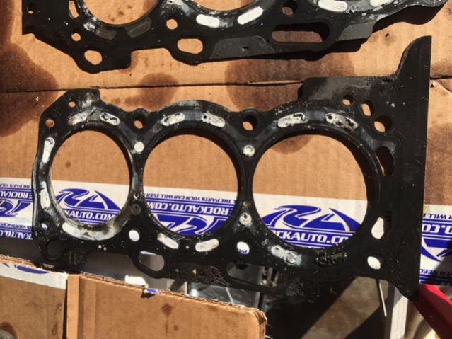

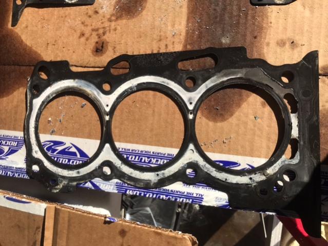

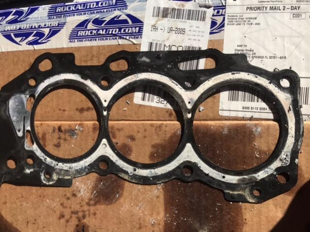

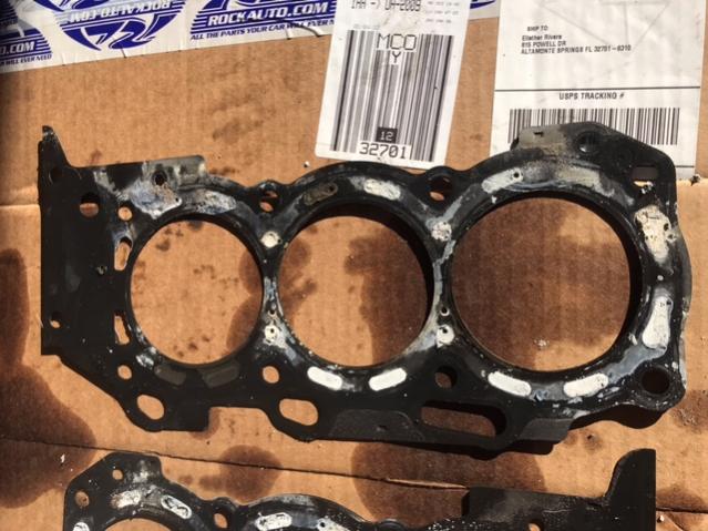

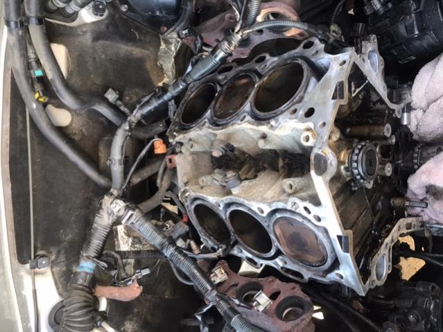

Bought it with an oil leak. Man the fun of wanting to do things and replace things once. Went from replacing the timing components to replacing,
water pump
oil pump
head gaskets
valve job
Knock sensors
all the orings and gaskets required
took a picture of the head gaskets so you can see for yourselves.

was debating even going this far but now looking at everything, glad i took the heads off. Should be about a two week turn around with the machine shop.
