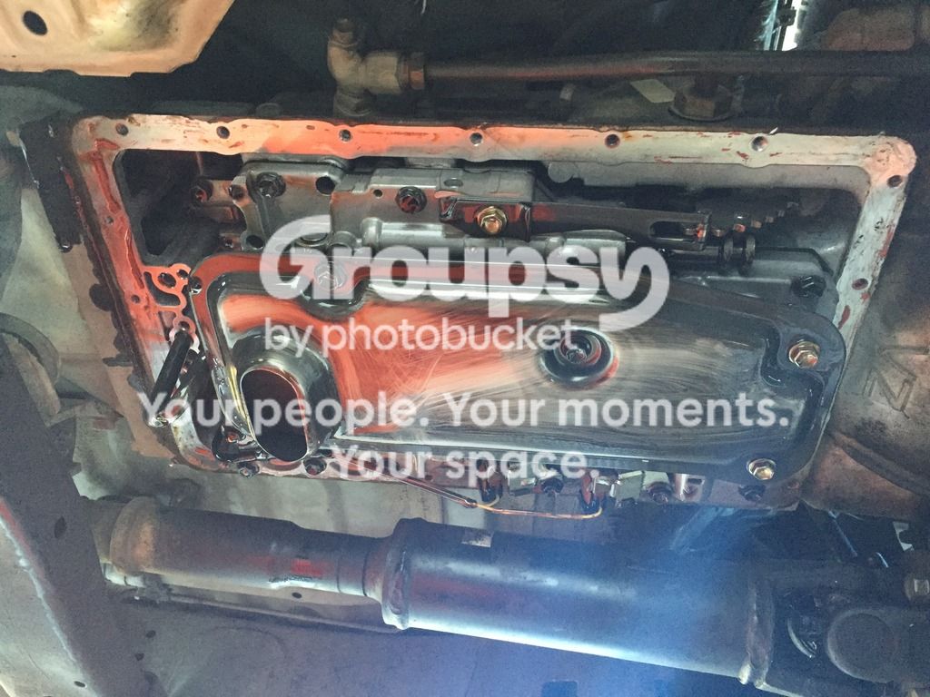

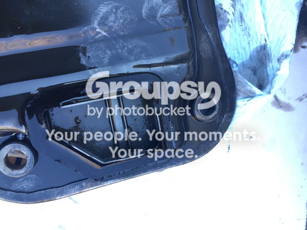

I don't recall ordering or needing any gaskets (other than the pan gasket) when I did mine. I recall there being a gasket on the screen/filter but I just cleaned my filter and reused the whole thing.
Here's a couple pics of the filter and the little gasket.
