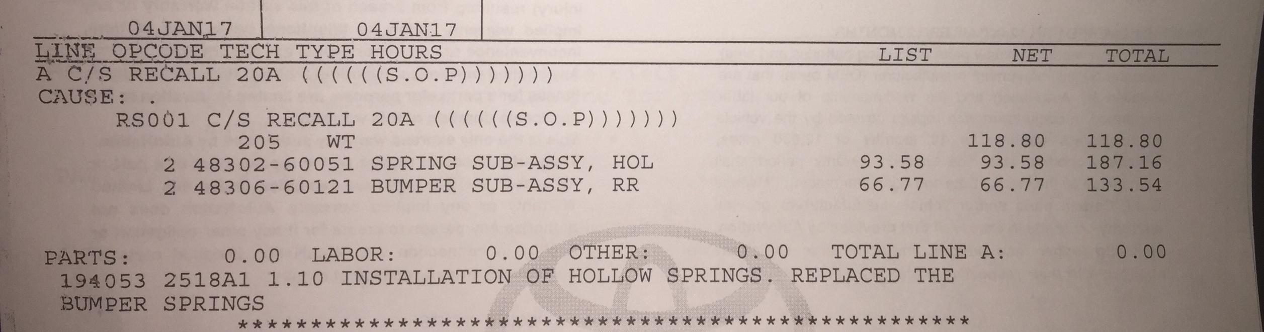

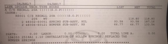

Took my '96 T4R in yesterday morning and picked it up end of day. The ride is immaculate now.. you can literally feel the difference, just like the person above (wdimson), my vehicle didnt have the spring sub-assy or the bumper sub-assy.. correct me if I'm wrong, but i dont see here on my invoice where they replaced my coil springs. I crawled under the truck when I got home and the coil springs look like the OEM (dirty, paint chipping, etc).
