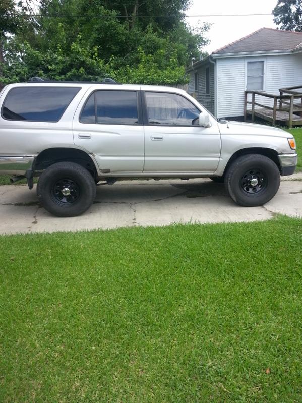

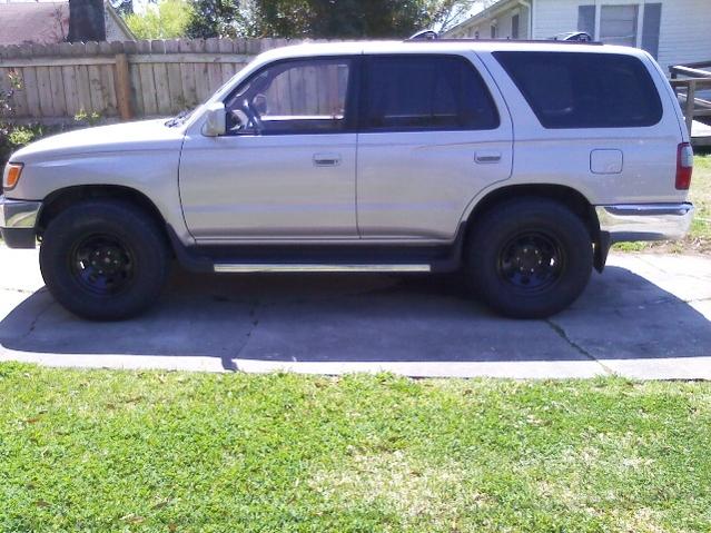

Added New KYB Shocks and some Daystar Spacers to the rear.
I did the work on the rear today. I'll install the new struts and spacers to the front tomorrow. Here are the before and after pictures.

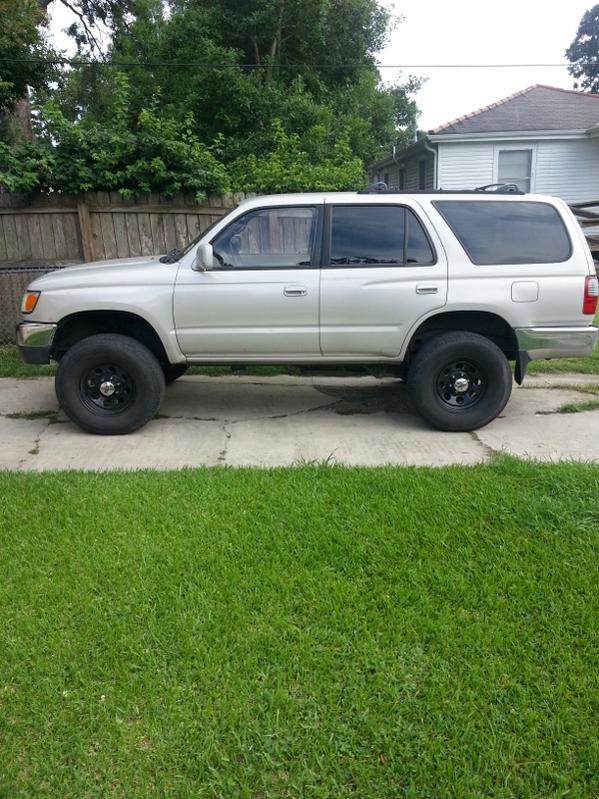

Completed this project last weekend. KYB's with Daystar 2.5 in. lift
Finally getting around to posting the pics.

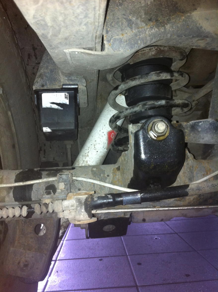

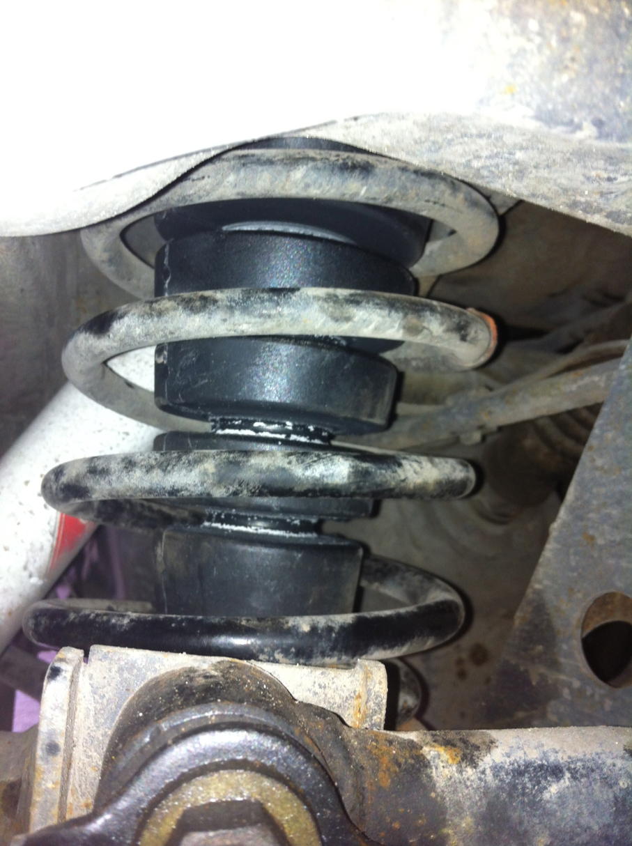

Just dropped off my 97. The parts they are putting on mine, how they described it, was like a smaller coil inside the coil with a new different looking bump stop. I think the 4WD's get a new coil kit altogether.
Just got it back. Heres what it looks like
