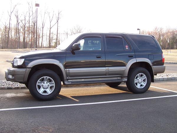

I replaced my coil springs with new factory springs and still had a sag. I just installed 1.5" Daystar spacers on the rear and now it sits level. If I had to do it over again, I would not replace the springs because it didn't fix a thing. That little bit of sag has a very negative impact on the ride and handling too. Toyota should correct the problem on all 3rd gens instead of limiting the recall to the first few years. I got the spacers for around $40 and installed them myself so it was an easy, inexpensive fix. Here's a pic with the spacers installed (Sorry, no before & after)

Where'd you get the spacers?

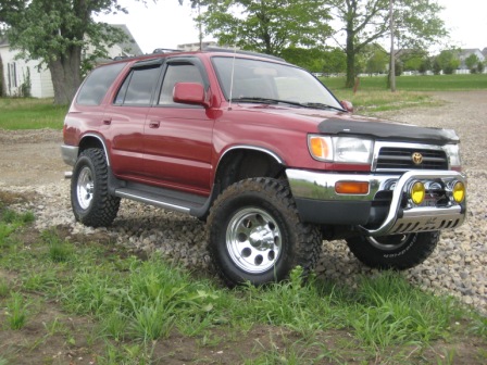

My hats off to shootmymime for posting the letter for the coil recall. I must say, I just walked in the door from the dealership with my new coils at NO charge to me. It did help the sag and bounce in the rear. Thanks again for your help shootmymime.
-EJ

004 Gunner.....I have a 96 and just found out the rear springs were done in 03....how big is the gap in your wheel well? I am thinking about the 1.5" spacers...just dont want to do it if it dont do no good...ya know? thanks, Garth
I didn't measure the gap between the wheel well and tire. I did just measure the distance between the ground and the bottom of the fender flares though. LF is 34.5", LR is 35.25", RF is 35", and RR is 36". My understanding is that it is normal for there to be a slight variation between the driver side and passenger side although ideally they would match. I do have a subwoofer and 2 amps in my cargo area as well as 3 cases of clay targets, so I'm carrying some extra weight. The spacers worked great for bringing the rear up and I think 2" spacers would be a good choice too.
