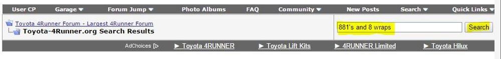

Thanks! I actually saw this thread about a week ago when I was deciding whether to jump on the 8 wraps or not, but couldn't find it again even after searching. I'll definitely check out your signature on better searches. They can definitely be frustrating, especially anything having to do with suspension/ lifts as there's probably thousands of them on here.
The issue most people run into is they try to use the "Forum Search" from the drop down menu.
That is using the website's built in search. The bar that I highlighted uses Google and the link in my signature is how to do an advanced Google search.
The LIMITATION of using the "Forum drop down menu search" instead of either Google based search is that the forum's website search does not process searches with less than 4 characters. 'TRD' or '881' or 'ABS' etc none of those work at all or very well unless you use a Google method.
