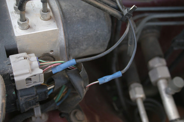

This is very similar to the Andy/Bagel mod for the 01-02's with TRAC and VSC. Basically what is happening is you are interrupting the signal from the ABS computer to ABS actuator which causes a fault and shuts down the ABS system
1. Locate the wire harness on the ABS actuator which is behind the airbox.
2. Cut the gray/red wire and crimp a wire to either end of it

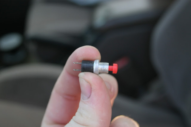

3. Run the wires inside through the firewall and connect them to your switch. I used a normally closed push button which means the terminals on the back are always connected until i push the button and then it breaks the connection. Any switch will work though. I just used this one because ABS automatically reenables when i restart the truck.

The button you're using is a just a momentary pushbutton, correct? And once the circuit is interrupted, the computer disables the ABS until the ignition is turned off and on again?
