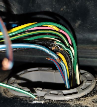

So. fuse number 20 is the problem. There's a short somewhere.
Fuse 20, ECU-IG, 10A, Cruse control, ABS system, Elec Controll Auto Transm system, Power antenna, power window, elec moon roof, power back window, back window defogger and back window wiper
I pulled a 10A from another vehicle and popped it in there. Worked great. Then it blew again.....
Thoughts?
Does that mean there's a short somewhere listed above?
Thoughts?
Thoughts?
I would say yes if you’ve blown 2 fuses there is probably a short on that wire.. I hate electrical diagnostic. I’m sure there’s a decently easy way to pinpoint it but I’m not an expert in electrical. Good luck, I have faith you will find it lol.

Fuse #20 which he says is a 10amp fuse. But yes always a good idea to make sure you have correct amp fuses installed.
Ah. Gotcha. Missed that part. I still put a meter on it and see how much it is drawing. That gives you an idea of what's going on. Then use [MENTION=8262]badluck[/MENTION] method to track it down. If it still has issues after everything disconnected. Then it's a trace and fix wires project.

I'll do that.
what is the badluck method mentioned?
Tailgate wires broken
HOpefully fixing this resolves issue.
Either way, doing this fix on the other truck 2000 Limited.

Ah the rear door. I was thinking the rear side door. You are correct Toyota calls our hatch the rear door. :) That's extremely common. I had to fix a few wires there. The other common place I'd throw drivers door as well.
