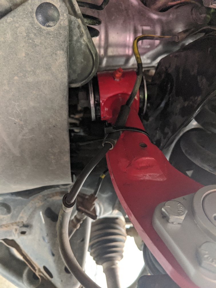

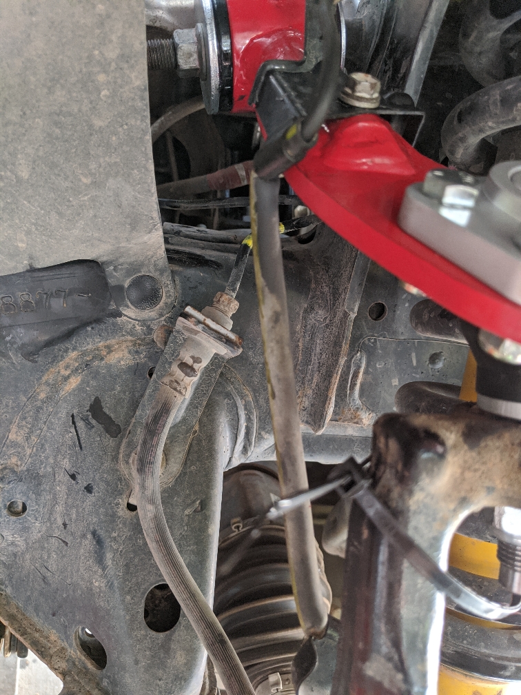

Just installed some JBA UCA's. The abs bracket isn't a great fit on these arms and the ABS line is pretty stretched out. Wondering what other people have done to get a bit more slack in the line there? Any good solutions?
Thanks!

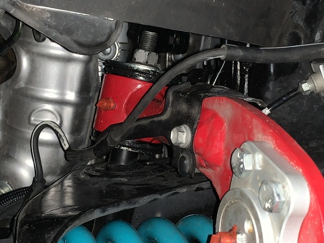

Take the lower side of the bracket and bend it to get the brake line out. Once free, you can bend the bracket around the edge of the UCA for a clean look and the upper clamp is still guiding the brake line, keeping it from getting pinched.
