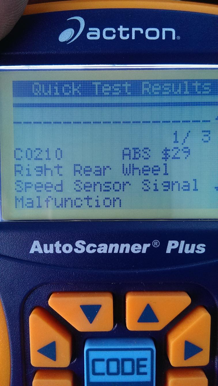

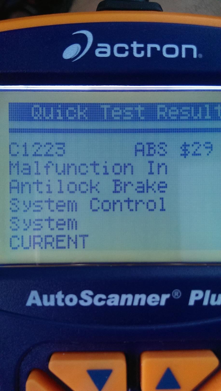

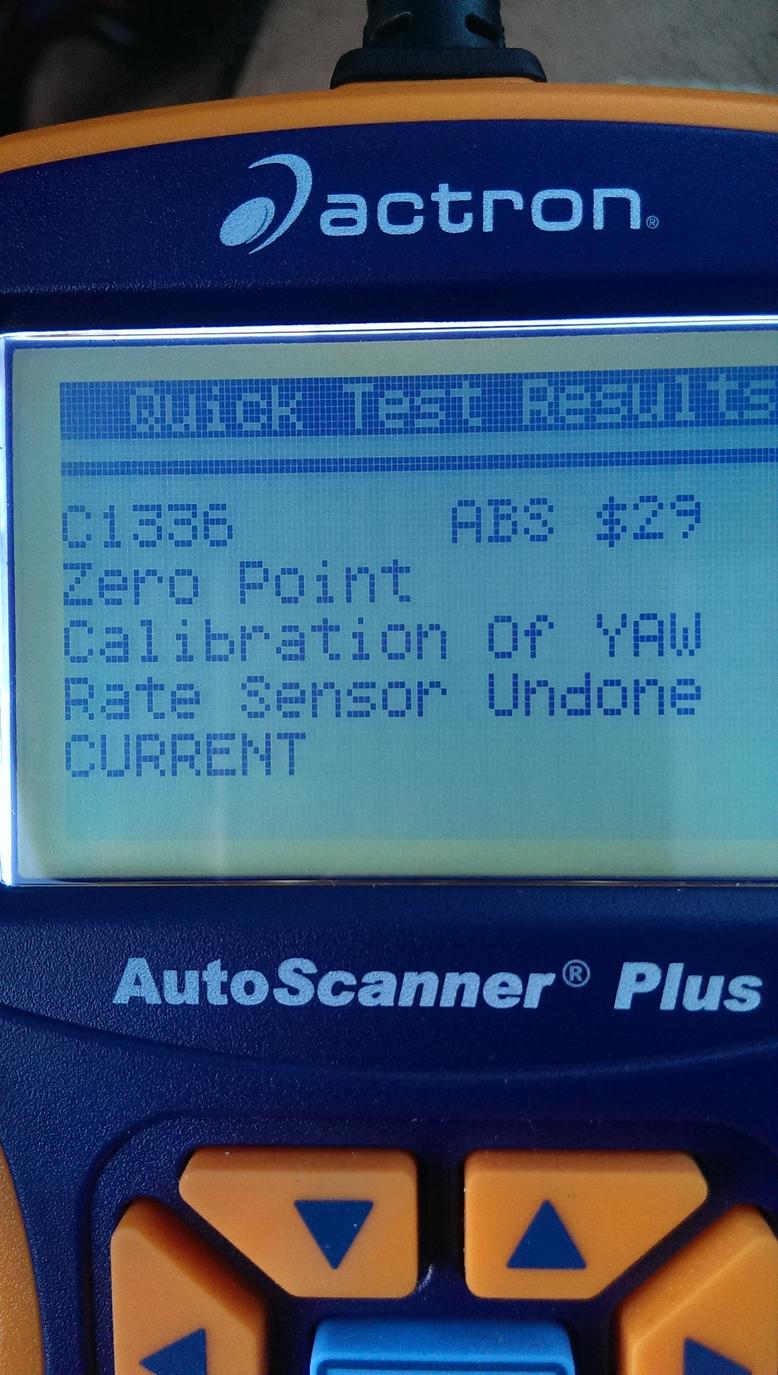

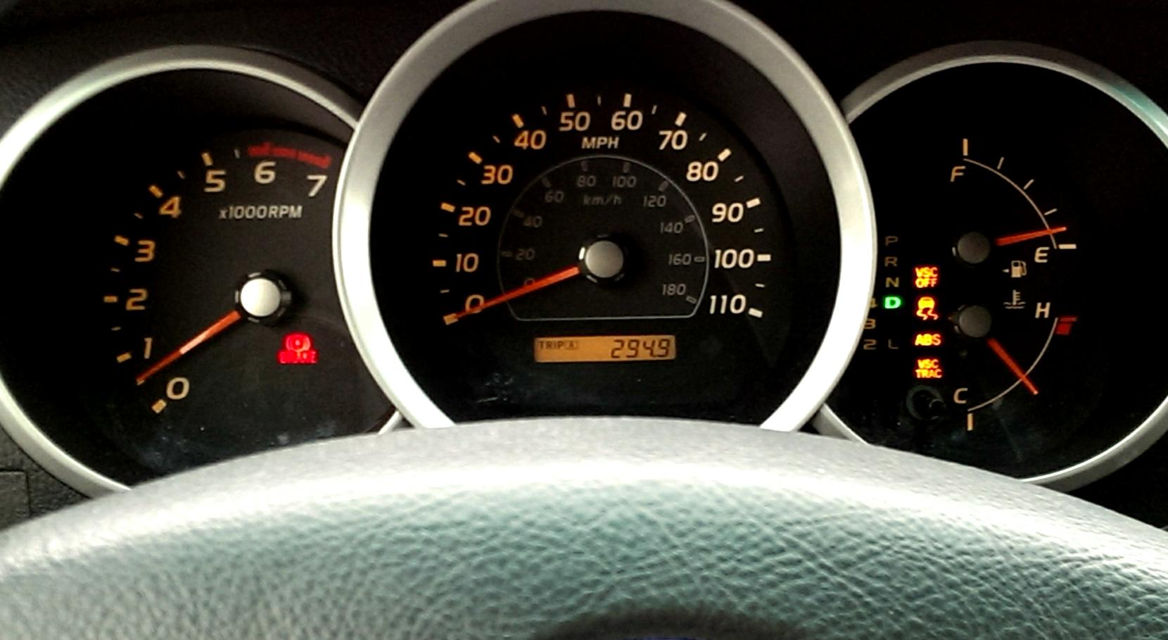

So after researching a number of threads on this subject it seems to be a fairly common problem without a definitive fix. I currently have the following lights lit on dash: P Brake, ABS, Trac, VSC, and Slip. I have tried both the battery disconnect and ZPC to fix to no avail. I checked with scan tool and got the following codes: C0210, C1223, and C1336. Do I go ahead and replace the speed sensor, and if so do I use OEM or aftermarket (Rock Auto is cheapest, but only by $35 vs. OEM)? There should really be a link in the Pre-purchase/ Mods write-up on the ZPC at a minimum, and more if possible on issues with the ABS/speed sensors. :frusty:

When it comes to sensors I try to opt for the same manufacter as oem. Does your actron scan tool let you of the zero point calibration? And clear the abs codes?

1. So I tried disconnecting the battery again, lights remained on. 2. I then pulled the speed sensor from right rear wheel cleaned it and re-inserted it.3. Unplugged battery again, lights still on. 4. Then did a zero point calibration, lights remain on. Went to Auto Zone, and checked codes; still have speed sensor code and ABS system code, yaw sensor code went away. I was able to erase ABS codes and corresponding dash lights went off, finally. They came back on within 1 minute of driving away. So I guess I am now left to spend nearly $200 on a new speed sensor. Anyone got any other suggestions before I start throwing money at this repair?
Replaced wheel sensor today, disconnected battery for 15 minutes, reconnected . Lights remain on. Then did ZPC, lights went off. Drove and the same lights back on. Code reader continues to say ABS malf, and Right rear wheel sensor signal malfuntion!!!! I replaced the fracking sensor with a new one!:rant::rant::rant::rant::rant::rant::rant::rant::rant::rant:
Anyone else with a thought before I take it into stealership???
I may be mistaken but I believe the old disconnect the battery trick doesn't work on newer vehicles. You have to have a scan tool that will clear the codes.

The lights cleared/ turned off after doing the ZPC. Once I put it into drive and moved forward lights came right back on. Yesterday I got under truck to check integrity of writing and everything appears fine, i.e...no loose wires or disconnects anywhere. Could it be a bad ABS FUSE?

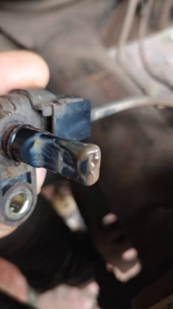

so i got the sensor off, and noticed its covered in grease, white grease, so sprayed wd 40 into the hole to clean off the grease, and wiped down the sensor with rag, will reinstall and rescan. got a 0.33 ohm reading with a fluke meter when i checked the resistance of the sensor
I'm no expert but that looks like bearing grease. Good luck! I'll be waiting for the results. I have new front hubs, just need to source some bearings and get it done. If this fixes your problem I guess I'll do my front hubs.

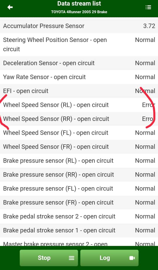

btw, i can see the front wheel sensor is a hex/allen key?, what size is it?. all my allen keys didnt fit. attched is a readout fron my obd bluetooth app

The open electrical circuit you are reading, if the sensors are ok as you say they are, means the harness circuit is broken. Can you push the wire back into the connector? 1/2" is enough to break the circuit. When my Speedo stops working I get out and push the wire back in and it works again. Be careful though: you no longer have abs until the computer reads a proper circuit for long enough. Can't remember if disconnecting the battery resets that and brings it back once you push the wire back in. Not having abs when you're used to it is a recipe for disaster. It takes a lot to get my blood pumping, getting sideways on a busy interstate will get it done.

sensors read ok 0.34ohm when tested alone, harness reads ok, when disconnected from sensor, however no continuity when sensor is plugged into harness, and read from the combined harness connector, above the axle
