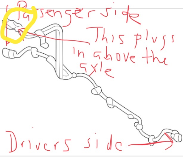

sensors read ok 0.34ohm when tested alone, harness reads ok, when disconnected from sensor, however no continuity when sensor is plugged into harness, and read from the combined harness connector, above the axle
been pretty busy, left the car, will do further trouble shooting over the weekend.
@ bolded, you mean the harness for the rear wheel speed sensor??. toyodiy has a schematic showing they terminate somewhere near the center storage area, a lil puzzling, cos there is no ecu there to my knowledge
The two wires come together and plug into a harness in the location you describe, yes. But then that harness surely plugs into the skid control ECU.
If you have the harness out to test it, doesn't that mean you know where that link terminates?
So the part circled in yellow clips into another connector hidden ontop of the frame.so that connector, am assuming leads to the vsc ecu?..
Its that pathway i wish to test for continuity if possible...hence my question.
That's what I thought you meant, check one of the online parts diagrams. I usually get on Toyota of Dallas parts to use their diagrams, but there are so many scam websites that are close to their address...
I'm pretty sure it plugs into the brake master cylinder assembly
