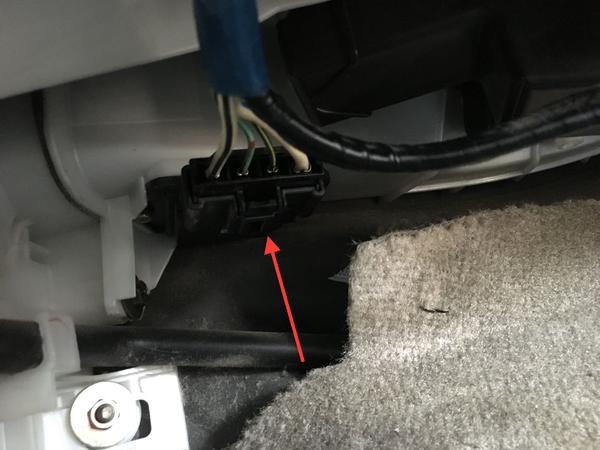

1. Disconnect the battery, then remove the cover under the passenger side glove box.
2. Unplug the tire pressure sensor (orange box) and set aside.
3. The controller is tucked way back on the left side. You will need a short Phillips screw driver.
4. Last unplug and swap out the controller.
5. While you have the cover removed you may want to remove the blower and check for bugs, dirt, etc and clean it out.
Put everything back in and so far so good. The fan is responsive all speeds and no more noise from the blower.
