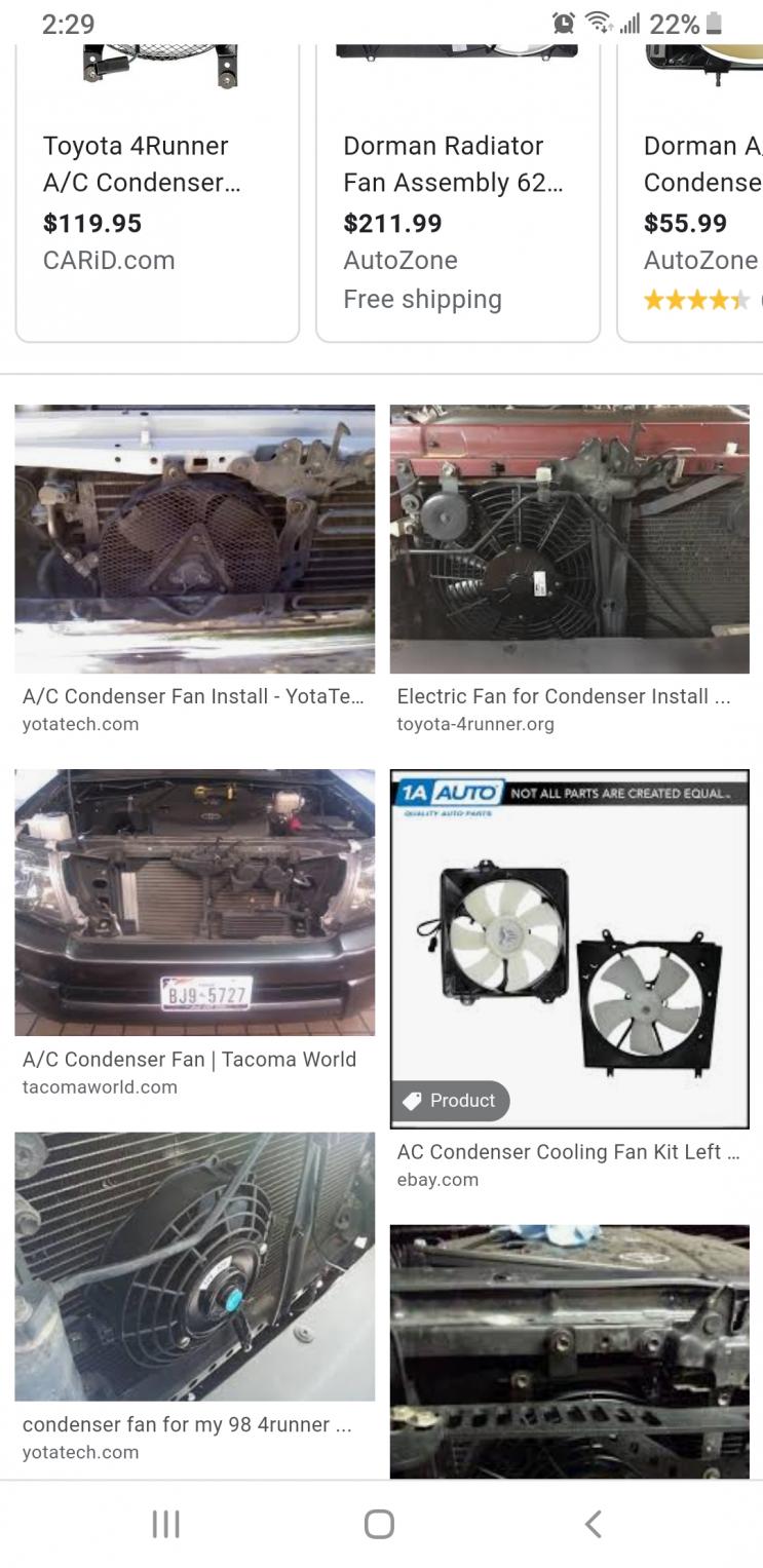

Anyone know if there is an electric condenser fan for a 06 v6 sr5? I have looked online but don't see anything.. it looks like there are mounting holes. Something like in the pic... if this is already covered can you send me the link please. Thanks for the help

I have added one from a GX470 to my 05 V8. It was a direct bolt in. I would double check to see if the V6 has any differences from the V8 in the radiator support area. Lots of options to wire it up. I copied the GX470 set up where its own relay is triggered by both a GX470 pressure switch and the compressor clutch relay and driven by a 20 amp fuse protected power source.
